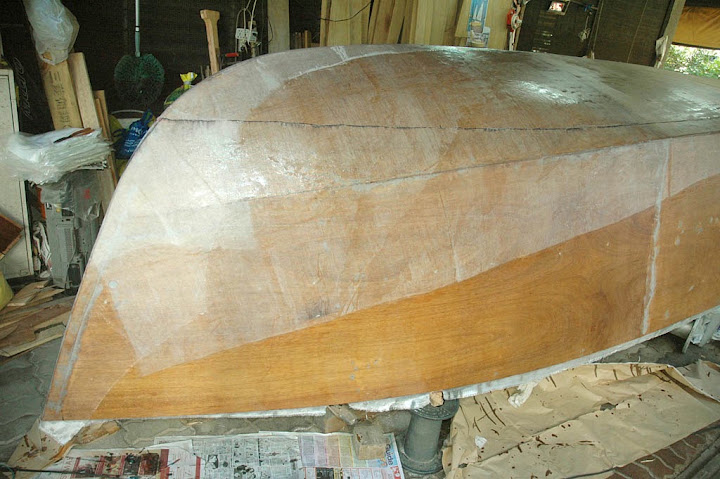

maligno Posted January 7, 2015 Author Posted January 7, 2015 Thanks Chick. That's reassuring to know. This is how No. 30 looks--for over a year now: Dished areas were filled and faired: Hull bottom faired and sort of sanded: Quote
