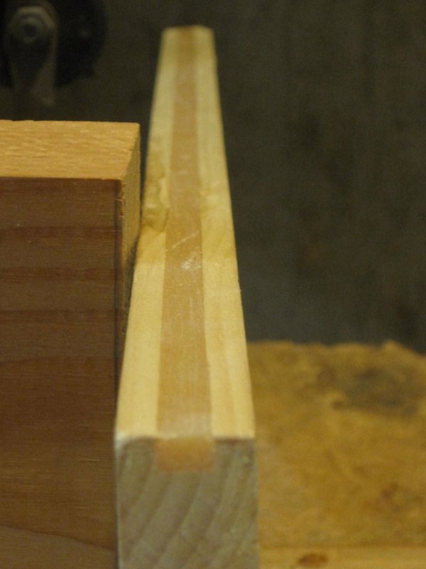

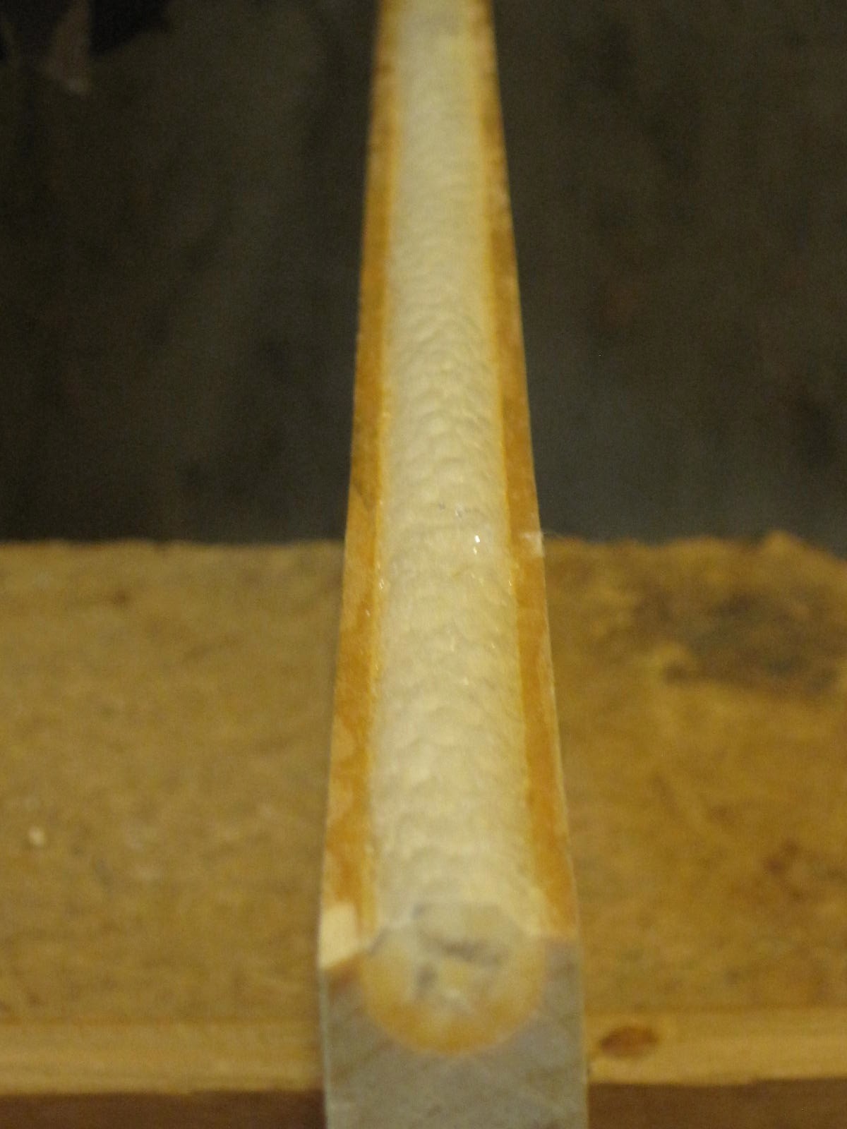

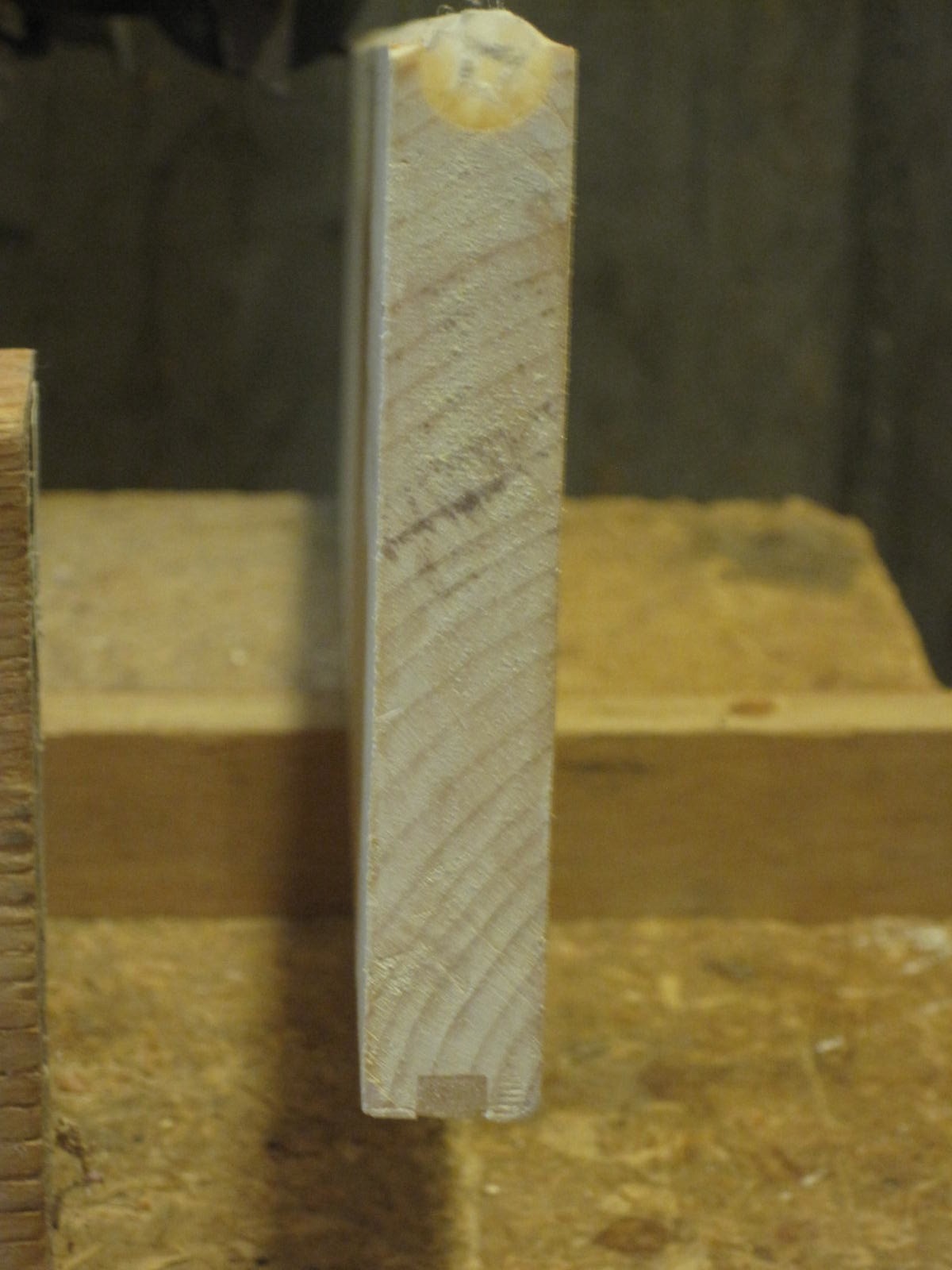

Current plan is mark the centerline of both the leading and trailing edges. On the leading edge, I intend to use a half round router bit and router in a groove down the leading edge. I'll stretch the line soaked in slightly thickened epoxy down that, where it will become the perfectly shaped leading edge for my board. On the trailing edge, that needs to be a sharp edge and to be durable, needs to also be made from thickened epoxy. I'll use a 1/4" flute bit and router in a square channel down the centerline and fill it with epoxy. That then becomes my trailing edge and a fixed and identifiable reference to shape to.
I did a mock up on a piece of scrap and it seemed to work well. With a couple plywood templates trimmed to scale, I should be able to build some pretty good foils this way. BTW, that is 1/2" single braid polypropylene line (individual strands get all fuzzy when cut) soaked in slightly thickened epoxy. I whacked it hard enough with a hammer I knocked it out of my hand, and I didn't even dent it. I can see that having such a line out front is certainly the way to go
