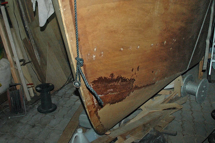

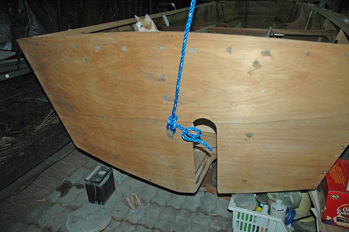

Single-handed, it took two days to flip the Belhaven: one day to rig and another day to manhandle the hull and set up additional rigging. I devised the "rotisserie" spin when I built my Stevenson Weekender and there was no reason to believe it wouldn't work here. The coming of super typhoon Haiyan (370 kph gusts! 199 knots!) added urgency to the operation.
Half-inch diameter lag bolts were driven into the bow and transom with over-sized washers to act as pivots:
Posted Image
Posted Image
A chain block attached to a strap wrapped around the hull did the heavy lifting, one end at a time.
Posted Image
Multi-part flipping tackles were needed for the control and brake lines because I miscalculated the hull's center of gravity--there was too much weight below the pivots. The bolts will have to be moved lower when the hull is flipped upright:

Starting the flip:
Posted Image
Synchronizing the flip and brake lines:
Posted Image
Done:
Posted Image
