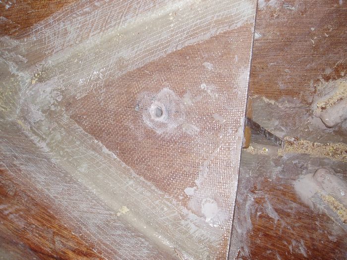

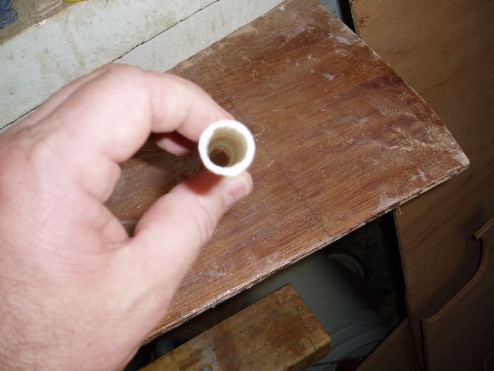

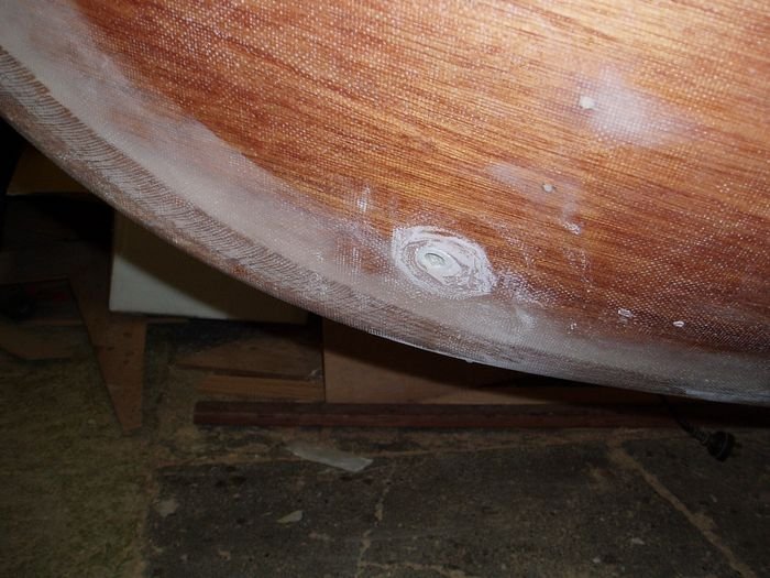

Tom Lathrop Posted May 14, 2009 Posted May 14, 2009 This is the method I devised to drain water from the mainmast tube. The first photo shows the epoxy bushed hole with a 1/4" ID plastic tube sticking out. The tube extends all the way into a hole in the side of the tube at the bottom.The second photo shows this tube bedded over with epoxy and glass. After the epoxy sets, pull the plastic tube out, but don't wait too long or it may be difficult to remove. Leaves a clear path of about 3/8" for water to drain. Many of Graham's builders have adopted this method. Never have to be concerned with getting water out of the tube again. Quote
Ken_Potts Posted May 14, 2009 Posted May 14, 2009 I did what Tom did but I used a straw from McDonald's because they've got a big O.D. and there was one sitting there looking at me when I was looking for a tube... Quote

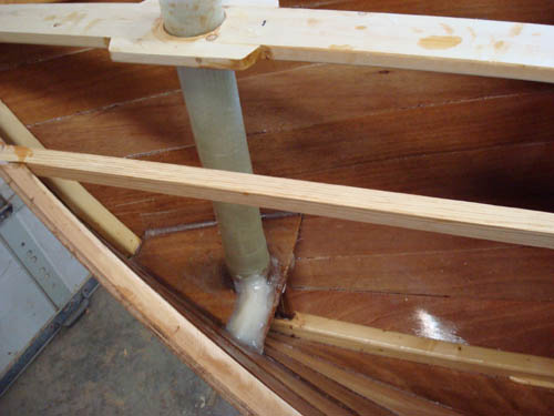

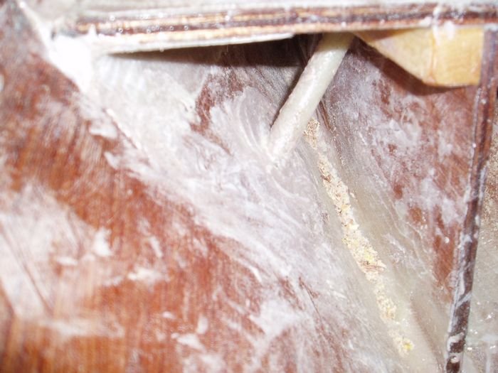

Peter HK Posted May 14, 2009 Posted May 14, 2009 Also, what do folks do to remove water from the fwd mast step I see you have had a number of replies. What I did was make a fibreglass tube and drain it at an angle downwards and aft through the bottom of the mast step. See photos Peter HK Quote
