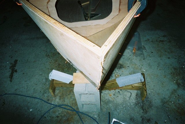

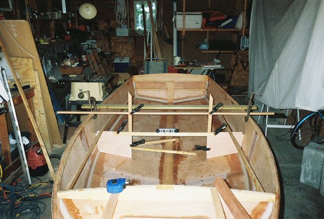

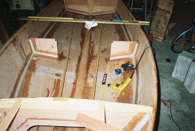

The first pic is of the notorious butterfly that would break on me shortly hereafter. I failed to back the seam with 2x2 blocks. The following pics speak for themselves, I think.
Guest Dennis M

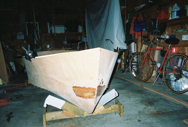

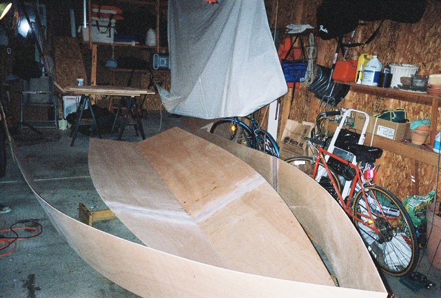

The garage is too constricted for me to get artistic -- sorry for the limited views.
Guest Dennis M

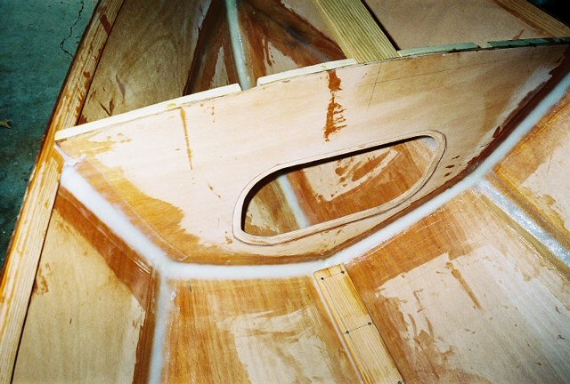

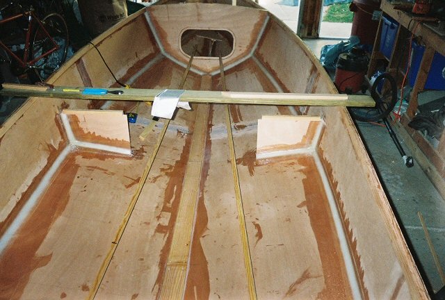

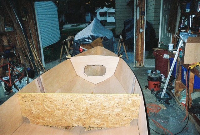

Finally, I hope that you enjoy the pics. Sorry it has taken me so long to get them up. ~ Dennis

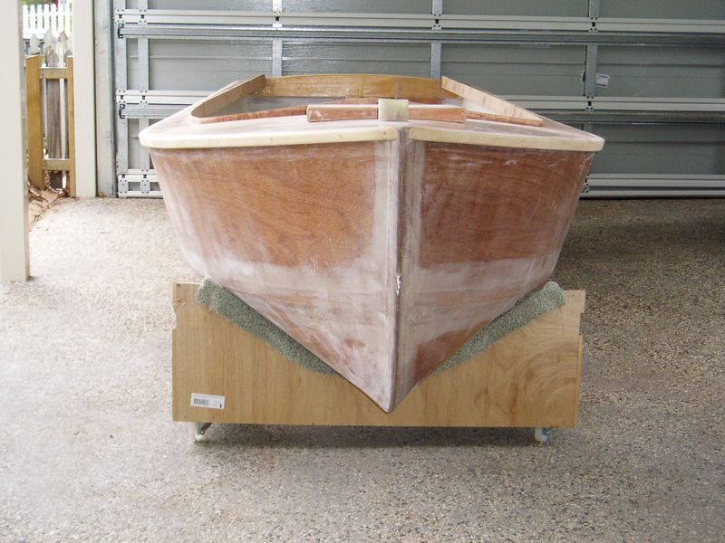

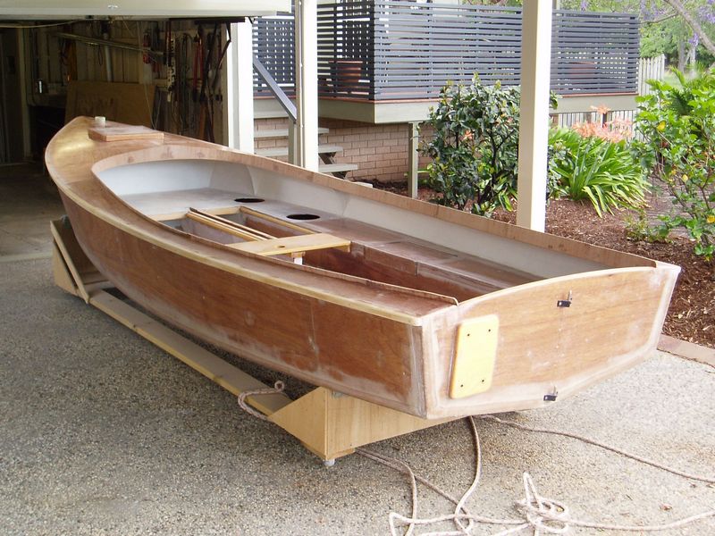

  In the long run the cramped space has one nice effect on the builder.  The day you first roll the boat out of the garage you'll have a fresh stand-back-and-admire-it moment.
Looks quite spacious to me ;D
Peter HK

Peter, that is too funny. I wish I would have seen your rolling jig affair, I'd have copied it and used it on mine.
