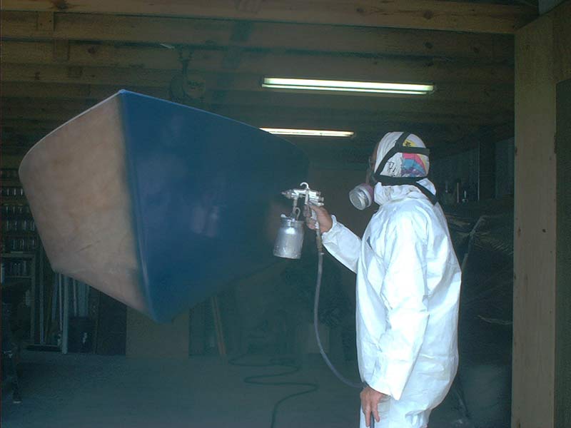

I'm prepping to paint the hull tomorrow. I'm going to take a stab at it with the HVLP sprayer, but I'll practice by painting the rudder housing first  (and maybe some scrap wood before that). I'm using the Interlux VC Performance bottom paint (epoxy & teflon only, no chemical anti-foul or ablative properties), but thinking I might spray the entire hull with it to avoid any color/shade mismatch between the VC Performance (white) and the Systems 3 WR-LPU (Whidbey White) that I was planning to use topsides. I may just reserve the Systems 3 for the interior and the spars, as I think I have enough VC to coat the entire hull 3 or 4 times and the VC should have superior scuff/stain resistance according to the reports I've heard from others who have used it. Only downside I can see is that the VC will be a bit more expensive to repair if any serious damage occurs or extensive recoating is ever needed.
Temperature is dangerously close to the max 95 deg F that Interlux specs for spraying VC, but I think I'll be all right if I confine my spraying to morning and evening hours (recoat window is 4-24 hours).
Any tips on spraying from anyone who has used HVLP to paint a boat?
Arrrrrgh, hit a snag today while painting. The HVLP works a treat and was going without a hitch. First coat looked great. Second coat also looked great, but suddenly revealed pin holes in the epoxy... and quite a few of them. I'm not sure how that happened (they weren't visible on the darker wood, but obviously must have been there). I did 5 thin fill coats of epoxy prior to painting, so I'm surprised that any could have remained unfilled, but there they are...
Anyway, the bottom paint is flawless until the seam (chine) where it meets the hull sides. So I'll leave the bottom/keel paint alone but sand the rest of the paint off. Then I'll fill the pinholes with epoxy again and get everything ship-shape before wasting more paint. I think I'll still have enough left in my 2-gallon kit to put on three more coats, so hopefully I can get by without purchasing more paint. We'll see....
I'm very aggravated nonetheless because now I'm in for a labor-intensive weekend of sanding. Ugh. It's 97 degrees in GA all week.

it has been said that pinholes (the result of sanding a surface that is populated with small bubbles) can result from the temperature buildup in plywood (any wood I guess) that causes outgasing during the curing of the epoxy.  The 'rule of thumb' is to not start any epoxy coating until after ambient temperatures have started to fall and never do coating when the plywood is exposed to sunlight.
Thereafter I tried to make it a practice to do all surface coating and f-glass sheathing jobs in the late afternoon/early evening and no longer had problems. YMMV
Good thinking, Tom... I had the same thought. I actually accounted for the heat/sun by erecting an awning that blocks the sunlight and by applying my fill coats in the evening (weather was in the mid-80s back when I did the fill coats), but the very last coat was indeed put on early one morning before work and that day was HOT. So, on a hunch, I went back out after posting that last message and tried sanding through the paint and into the epoxy, JUST enough to eliminate the pin holes.
Sure enough, the pin holes were only in that last (top) coating of epoxy (hooray!), which meant that I was able to eliminate virtually all of them without any need for filler. [Edit to add: Actually, on second thought, I think it wasn't the temperature, but rather the thinness of the final fill-coat that caused the bubbles. I suspect I under-saturated the foam roller and actually rolled air bubbles into the epoxy due to the pores in the semi-dry foam roller core.]
Anyway, since I was still within my permissible paint-recoat window, I wiped everything down with reducer solvent (the same kind used to thin the paint) and went back to spraying. Took a little "finessing" to match the (dark) sanded areas to the (white) painted areas, but the HVLP sprayer is awesome and with a steady hand, it's quite easy to "blend" the paint (which means it should also make for easy repairs later, which is encouraging... I don't think I'll ever paint a boat by brush/roller again, if I can help it. Spraying is SO convenient, quick, and controllable. No runs, no sags, no drips. Very nice.)
To avoid putting the paint on too thick, I didn't try to fully blank out the darker sanded areas with this coat, but it's close. Another coat tomorrow morning will restore everything to a perfectly consistent, fully-covered finish. Then I'll add one last coat to allow for sanding, and that should be the end of the paint! I'm so glad this turned out to be an easy fix. In fact, I think the final finish may now come out a bit nicer, since I also stumbled across one little run of fiberglass overlap that was telegraphing through the paint at the transom. Since I was already sanding, I sanded that down, too. So, after all my panicking, it turned out all right.
Okay, we're back in business and the finish is coming out great now. It's not perfect, and the HVLP application sprays in such thin coats that it's very intolerant of surface imperfections, but the flaws are so slight (and won't affect performance) that I think I'll leave them. They may even vanish into the last coat. Pretty impressive for a no-primer paint application (Interlux doesn't make a primer for VC Performance.)
In any case, this finish is already worlds better than we were able to achieve on our last boat, and I credit most of that success to the HVLP gun. I'm using the $90 Kobalt HVLP gun sold at Lowe's, and a very small compressor (1.7hp, 20-gallon). The compressor works hard, but only has to run hard for about 20 minutes per coat, so I think it'll take the abuse. I spray one side of the boat, then let the compressor "catch its breath" for about 5-10 minutes, drink a glass of water, then spray the other side of the boat.
If anyone else is thinking of trying the same set-up/paint, I found that a setting of 50-55 psi at the compressor and 42 psi at the gun seems to yield best paint atomization (provided the material flow and spray pattern settings are tweaked to minimize droplet size). The Kobalt manual specifies 29 psi at the gun (gun-mounted regulator is included), so I'm probably getting more overspray with my setting, but the 29 psi had a slight tendency to splatter occasionally. Of course, settings may vary for folks in different climates, or spraying different paints.
See pics below... First pic is me starting the first coat (I started on the rudder blade and housing first); Second pic is the finish after of the fourth coat which I applied this morning. Can't see the areas I blended, so I'm very pleased with it. One last (semi-thick) coat tonight to allow for sanding. The 2-gallon kit of VC proved to be just enough, and most folks hopefully won't have to waste any paint on pinhole problems like those I encountered, so should be plenty for a CS20. A lot of folks might also only coat below the waterline, in which case the 2-gallon kit would probably be enough for 6 or 7 coats (assuming you spray them lightly and evenly, not hastily or thickly).
