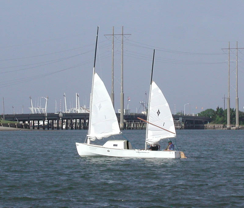

I'm including a photo of a heavily reefed Southern Skimmer starting out in high wind last week in Beaufort.  Doesn't look like so much in this very protected area but got very boisterous later on until the centerboard incident..
