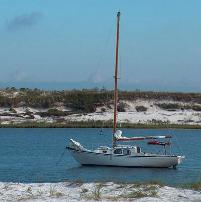

Charlie Jones Posted May 5, 2008 Posted May 5, 2008 Is that a chainplate for a running backstay? For some reason I had it in my head that Tehani had freestanding masts (?) I'm sorry. I just noticed this question. Didn't see it when I first read the post. Tehani is a standard sloop rig, with a wooden mast and boom. Her mast is Sitka Spruce, and is original to the boat. 1961, Dutch built. Our 18 foot Sharpie has free standing masts Picture is of Tehani at anchor in Mosquito Cove, Pensacola Florida Quote
