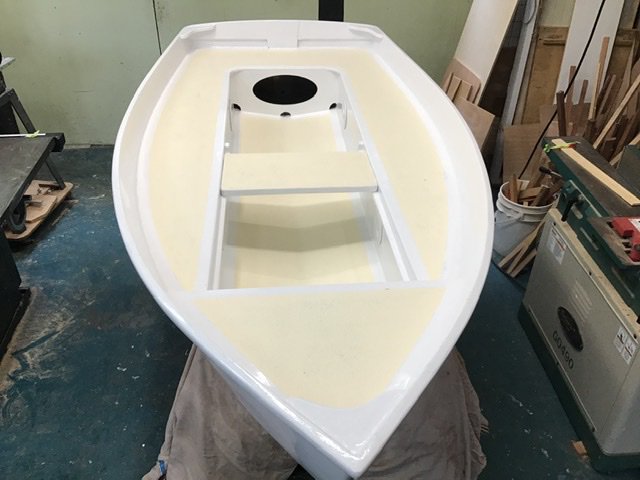

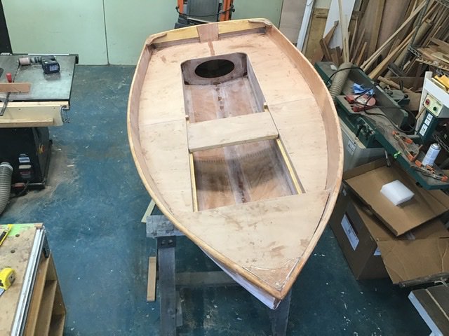

I have never built a boat as a kit. I have cut miles of plywood and built and lot of boats in my life. As mentioned earlier, I don’t need any additional projects right now so I was intrigued by the notion of a CNC cut build.  I have a number of very light, delicate surfskis that require careful handling. A dinghy out of 4mm ply seems rugged by my standards and Graham had a dinghy that he used for many years while cruising built to similar scantlings. The team at BandB cut the parts for the Kendrift out of 4mm ply to make the boat light weight. I received the crate in San Diego while I was escaping the Canadian Winter weather and brought it back to BC to build it in my shop. I asked Graham how long he thought it would take to build and he replied, “a couple of weeks”. I thought he was pulling my leg. Well, I started working on it around 5 weeks ago while doing a bunch of other projects at the same time. Going back and forth and actually keeping a log of Kendrift building time. Much to my surprise, she is essentially done except for paint and I have just under 80 hours into the build. I am dazzled by how easy it is to put one of these boats together with the precision that the CNC cut parts provide. It felt like a jigsaw puzzle going together. Everything fit to near perfection.
I mounted the oarlocks yesterday and will splash her in the next few days. I weighed her and she came out at 66lbs. Not bad for a 9ft dinghy. I haven’t mentioned the aesthetics. Like most of the BandB designs she is easy on the eyes. The lines just look right. A designer friend stopped by recently (we kept our distance) and made the same observation. Loved the lines.

Got to launch her yesterday. Connecting a new boat to water for the first time is always a wonderful experience. As expected, the Kendrift design seems like a winner. I have a few tweaks to take care of such as fine tuning oar length and oar lock position And mounting fendering. . Did a solo row and one with Luanne aboard. She moves through the water nicely, is very stable and looks great. Can’t ask for much more from a 9’ tender.
