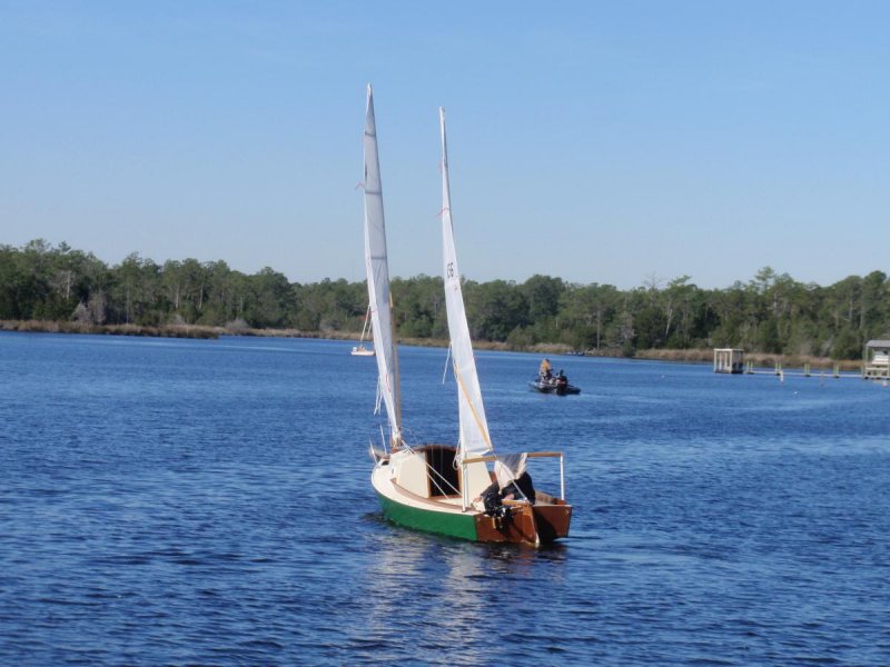

  1. Here's a shot of Chick sailing away with my cooler.

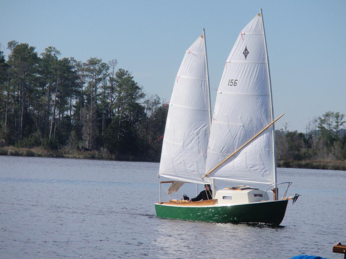

  2. Here's pic of Chick's boat. My pics are all high def and I don't know how to change them, so I think I can only add one per post. We'll see if it works...
