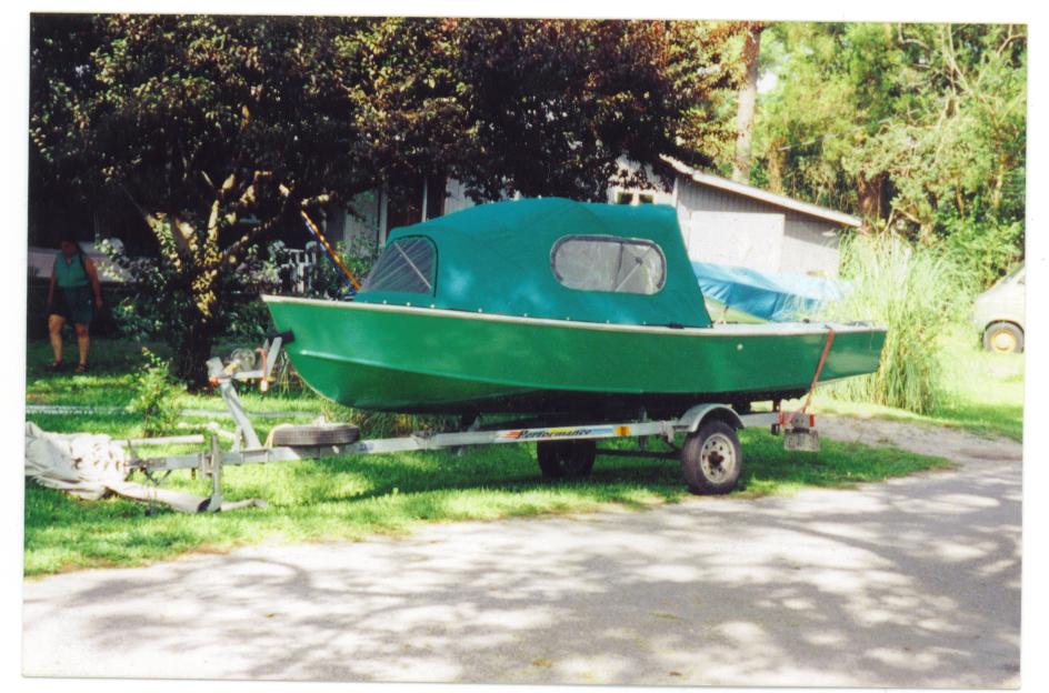

  1. These were taken in 2000 at the Great Race. SawDust had a short fore deck so I could have a large casting deck at seat height. The tent is a custom-made Bimini top with sides. The windows open to no-see-um mesh and the screen in the front window also had zippers so I could tend the anchor rode from inside. The rear wall was all mesh. The whole thing folded forward, and after disconnecting the frame, tucked under the side decks. The interior was 8 1/2 feet by 5 feet and high enough to sit comfortably when the floorboards were out. It left two wells for feet when sitting and a large area for cooking etc. With the floorboards fitted it was one big sleeping area with the centerboard horn there to separate the sleepers. It worked so well I sold the boat with the idea of later building a boat with a cabin. As it turned out, when we used the boat for fishing we just got out and waded. We could wake up in the middle of the flats. One night in the Banana River in the 'no motor zone' near Canaveral there was a launch at about 03:00. .....They really aught to tell a guy....
