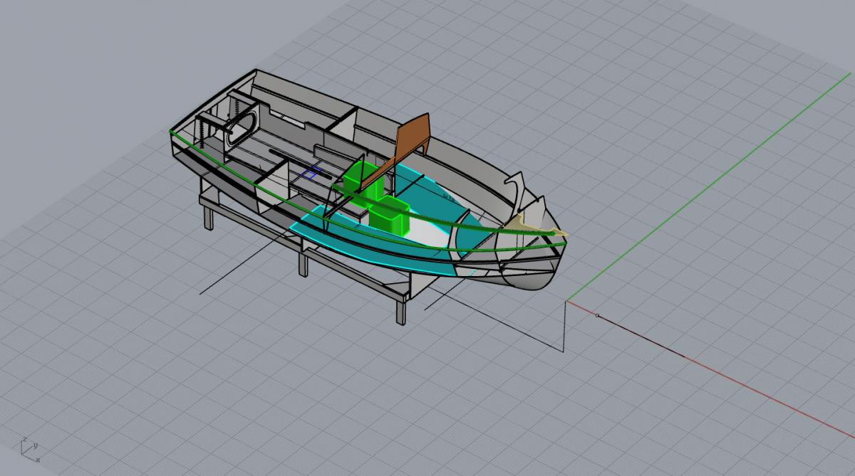

Designer Posted February 19, 2015 Posted February 19, 2015 Whoa Chick, there is still a lot to do. I had already ruled out no foot well. The bunks that I drew in are 6'3" long but they could go all of the way back to the bulkhead. It appears that the small porta potti will fit under the bridge deck, see the green cube. It will have to be moved to use it. When I have someone on board our OB20, I move it to the cockpit at night to save the other person from being disturbed during nocturnal visits. It should be possible to fit the Zuki in a well but it will be a squeeze to stow it in the cockpit locker with the narrower beam. Quote
Scott Dunsworth Posted February 19, 2015 Posted February 19, 2015 Chic why not just build the 17 instead of trying to cram everything into 15 feet? 1 Quote
Chick Ludwig Posted February 19, 2015 Author Posted February 19, 2015 Hi Graham. It appears that the berths go back under the cockpit seats to get the 6'-3". I would want for them to be entirely between the fwd. bulkhead and aft cabin bulkhead. Moving the aft bulkhead would be the way i would want it. I know that this would reduce the cockpit space, but that is fine with me. Or maybe I misunderstand? The w/c under the bridge deck is fine. I hadn't intended for the outboard to be in a well like the PS-22. Just on the transom like my CS-20 MK-2. I wouldn't plan to stow it in a locker. I just leave it "hangin' in the breeze". I notice that the transom has a forward rake. I assume that this is to add waterline length. It would be difficult to mount an outboard at this rake. I definitely don't want it on a bracket. I would prefer an aft raking transom, even at the expense of max. waterline. Quote
Chick Ludwig Posted February 19, 2015 Author Posted February 19, 2015 Scott, guess I just like a challenge! And I like minimal boats. Besides, I'm limited on building space. Some other considerations too. If it turns out that Graham decides that a 15 just isn't practical, I'll go with the 17, but otherwise, it will be the 15. Quote
Designer Posted February 20, 2015 Posted February 20, 2015 Chick, I am not a magician. I have to obey the laws of physics. I can't bring the bulkhead aft because that brings the water ballast tank aft as well as forcing the crew aft. The poor thing would be dragging it's tail like an abused dog. The WL is only 14', the overlapping of the bunks and cockpit is the only way I can make it work. The transom does rake forward slightly. Yes it does lengthen the WL but it gets some volume aft as well as encouraging the crew to be more forward. It is not much but we need to optimise everything to make a decent boat out of a teacup. All you need is a wedge on the transom to make the outboard work. Quote
Chick Ludwig Posted February 20, 2015 Author Posted February 20, 2015 Graham, I am shocked! I was under the impression that you could "bend" the laws of physics to your will. We certainly don't want for the poor thing would be "dragging it's tail like an abused dog". (Don't led Mandy hear you...) One of the great things about this boat is that the performance will be so much superior to anything else out there. I can work with the transom ok, but am concerned about the berths. I don't want to sleep with my head in a hole and laying with my head in the bow just "don't seem right", but maybe I could get used to it. I'm guessing that if you extend the berth forward all the way to the bulkhead with the main tabernacle on it, that it would be so narrow as to be useless. What if the ballast tank stops short of the transom (looks like it already is) and extends forward into the cabin under the berth tops. It would mean having a split bulkhead with the forward end of the tank moved forward and the aft cabin bulkhead moved aft. I would loose some foot room in the cabin. Also complicate the build somewhat. As drawn, how wide is the forward end of the berth? Quote

Designer Posted February 20, 2015 Posted February 20, 2015 chick, The ballast does not run to the transom. It is only between bulkhead 3 and 4. I had intended you to sleep head forward. Alan suggested that the bunk top be raised forward so that it would trim level when being used. This would also widen it slightly forward as well. Quote
Chick Ludwig Posted February 20, 2015 Author Posted February 20, 2015 OK, so how wide does it look like it will be. Also, how wide is the hole through the aft cabin bulkhead into the "cavern"? How about posting an interior plan and profile? Maybe with a "measured scale" (don't know what to call it, but a drawn scale that I can use to measure things.) Quote
