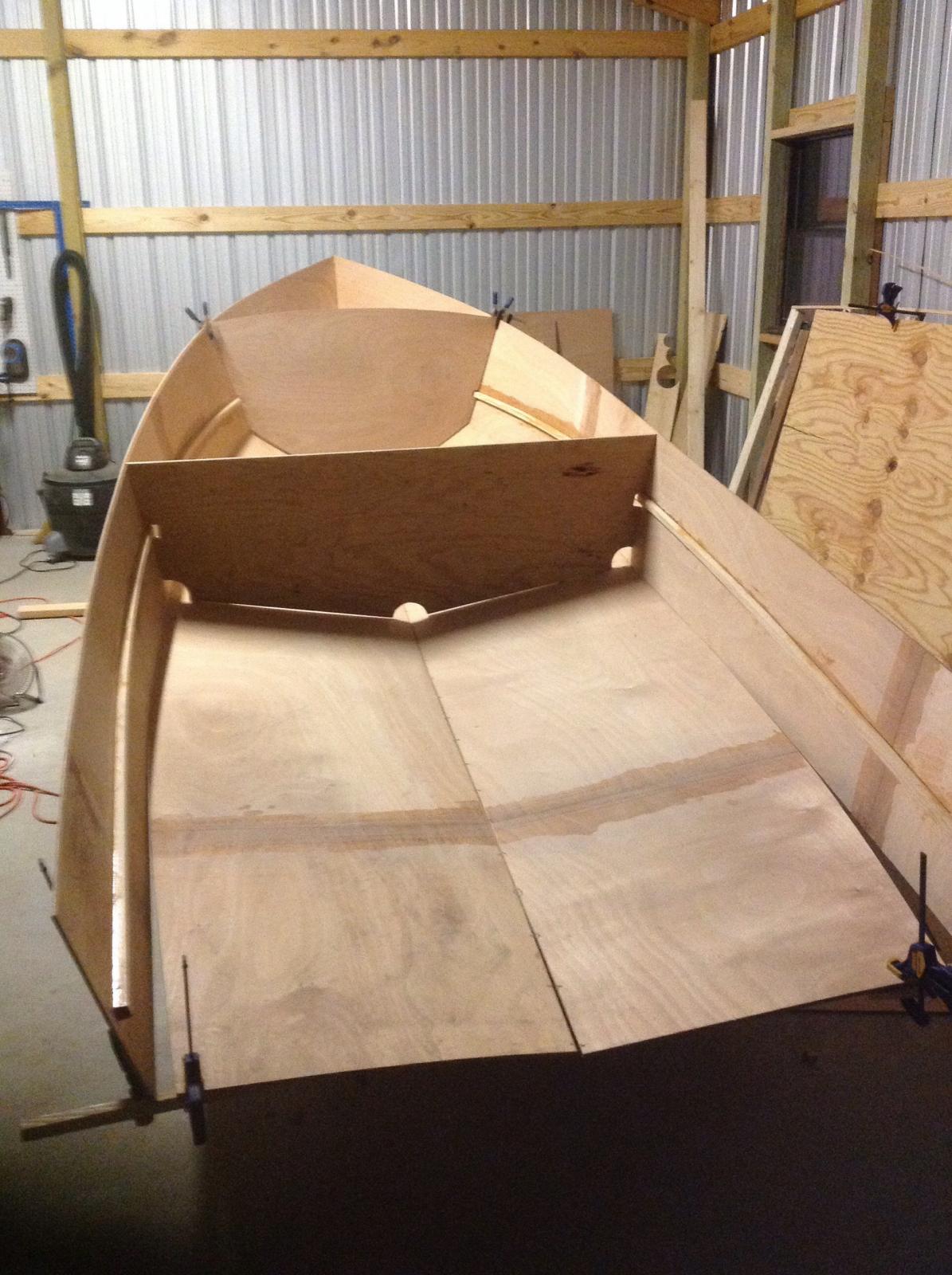

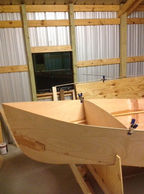

Tgabe Posted September 8, 2014 Author Posted September 8, 2014 Here are a few pics of hull #375 just after unfolding. We have been working on wiring chine and getting it lined up correctly. Transom going in soon. Quote
Dnjost Posted September 8, 2014 Posted September 8, 2014 Get the centerline seam tight at the stern. Bad things happen to the shape if you don't. (Don't ask me how I know.) Quote
makenmend Posted September 8, 2014 Posted September 8, 2014 I always get a kick at this stage of seeing a pile of wood go 3D. I recently built a boat for a long time friend, I cut the panels but had him assemble them a great experience, much enjoyed. MM Quote
Tgabe Posted September 22, 2014 Author Posted September 22, 2014 I'm trying to figure out the sequence of the next steps. I have the hull wired together, forward bulkhead, temp center frame, and transom also wired in. Is the the correct sequence for the next steps? 1) intall inwales (I can't find anything in the instructions about this) 2) tape and fillet inside seams of chine 3) install keel batten Do I tape and fillet the centerline prior to installing keel batten? -Gabe Quote
