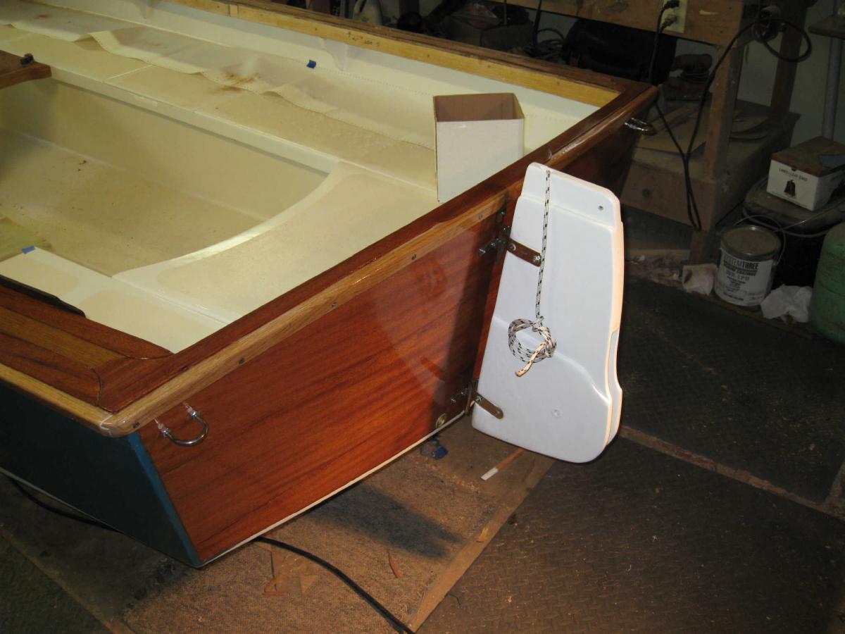

Flex would be a problem my way, but I also made the transom curved, which employed a big ass (technical term) horizontal brace, across the transom about mid way up (just below seat height, so it could act as the aft support for the removable seat. If I was to do it again on a straight transom, I'd still use the brace, if only to add athwart stiffness, replacing the lose of the bulkhead.
Horizontal brace. It's dirty after a sail and I've yet to finish up the paint in this photo, as I've just installed twin transom drains, so water can't pool on either side of the keel batten.
With seat in place, it seat lands on two lengths of aluminum angle stock, which are screwed to the seat box risers, so it (the removable seat) is resting on the brace and the angle stock on each side. A curved (laminated) beam on the front of the seat stiffens this area. There's no lose of floatation chamber dimensions, in fact there's more, because the seats are wider aft than on the plans, because I curved the seat faces (risers) to mimic the sheer and offer more butt room (another technical term).
