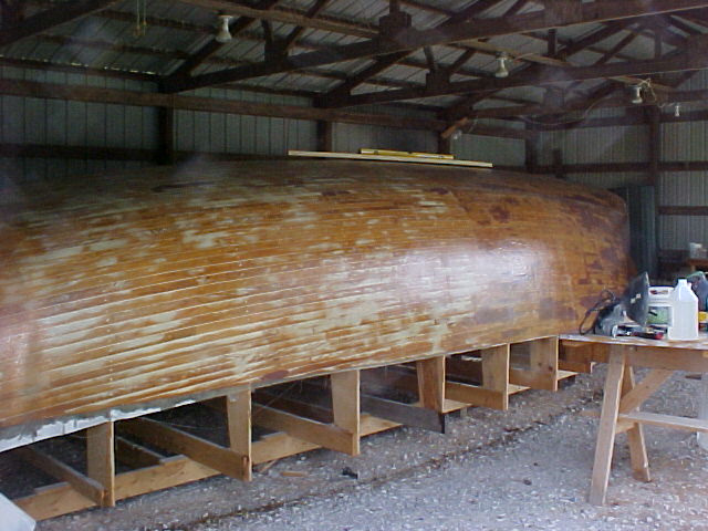

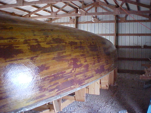

Scott Dunsworth Posted August 20, 2012 Author Posted August 20, 2012 Heres some glassed pictures. There is a glob of junk on the bottom of the bow, the boats fair I just need to grind that piece of glass out. It wouldnt make the corner smoothly, so I just left it untill every thing cures. Quote
Scott Dunsworth Posted August 21, 2012 Author Posted August 21, 2012 After putting three filler coats on, the first unthickened and two thickened coats, It took four more gallons of epoxy. So that's 12 Gallons to wet out that carpet and fill the weave!! Insane isn't it! That puts the total for the build so far at 27 gallons. I'm nearly at a gallon per foot and still got to glass the inside. Something Tom said way back early in this build, was that cypress will adsorb a lot of water if it has the chance. Well that is equally true with epoxy, it drinks it up deep into the grain. This weekend we will fair in the glass over laps and start building in the keel flat. Those over laps look to be 1/8 inch thick so I'll have to draw from my drywall skills to make them disappear. Its strange how the old saying is a picture doesn't lie. But they do, I spent quite a bit of time fairing the bow and it looks sweet in person, but in the pictures it looks like a train wreck! Just a bit of trivia, I added up all the materials so far to get an estimated weight of the hull at this point and it came in at 1955 pounds. Trying to keep an estimate of the weight, because the day will come to turn her over and its always on my mind. Everyone that sees the boat always asks how are you going to turn this thing over and how are you going to get it from the barn to a trailer? My answer is always I don't have a clue! Scott Quote

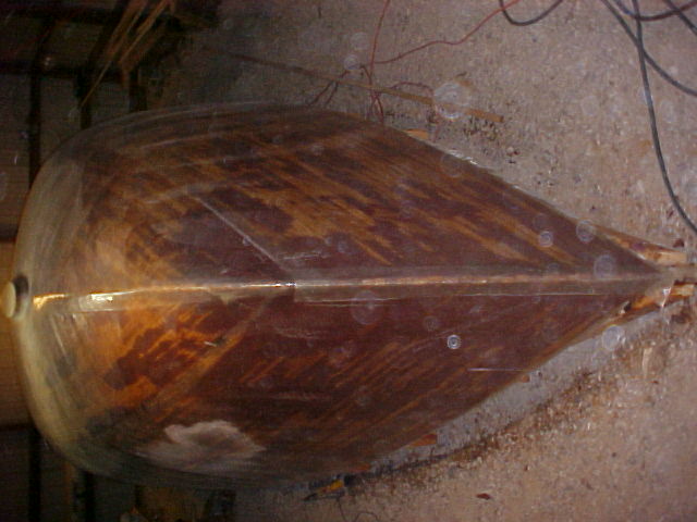

Scott Dunsworth Posted August 23, 2012 Author Posted August 23, 2012 I got an email from a friend asking me if the white areas showing under the glass were dry spots. It's white balloons, I switched over at about mid ship to the white. The cost was much cheaper by 34's. In the pictures they do look like large dry areas though. After looking over the whole hull I found 2 air entrapment's spots the size of a dime and a few small ones where we forced the biaxle around the bow. Those on the bow I will cut out and fill. We actually got no out gassing while wetting out the hull, this is a first for me. We started about 9 PM and it had been cooling down for about three hours before that. I had used a strong fan blowing under the hull sucking cool outside air. It done the trick the hull was cooling from 85 degrees to the low 60's by the time we finished. The pictures really don't do the hull justice. I usually cut the glass hanging from the shear while it's still green but decided to leave it this time until I'm done with the bottom. It will act as a drip edge for washing the hull down. That way the water will drip from it and not turn and get the deck shelf wet every time I wash the hull of blush. I cant see or feel any blush after using the Raka but there's probably some there. With the hull glassed and the inside coated with a thin layer of epoxy ( except under the temporary frames ) I'm hoping she will be stabilized enough till I can get the inside glassed. Quote

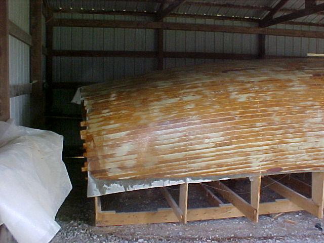

Scott Dunsworth Posted September 16, 2012 Author Posted September 16, 2012 I was intending to get the keel flat installed today, but the barn took all day replacing the plastic front. So I'll start on that today. While the plastic was off I thought I would get a few pictures that wasn't possible with the barn closed up. The shear planking is not trimmed to the deck shelf as of yet so that makes the shear look a bit lumpy. Before the planking went on the deck shelf showed the sheer fair and sweet. Cant wait to turn her over and get all these cleaned up so I can see her real shape. As you can see the stern hasn't been cut yet, Graham and I discussed that this morning. After the keel is laid up there is only going to be about 4 inch's of space between the boat and the bottom of the truss's. So saying it's going to be interesting to turn is an understatement. I do now have some plans in the works on how to get that done, but no backup plan. To get her out when done, the plan is when turning the hull set her in a metal cradle with the bottom rails fashioned as sled rails. We can then take the barn wall down and pull her out to the boom truck. Lift her up then use the tractor to set the cradle on the flat bed and set the boat back in the cradle. Quote

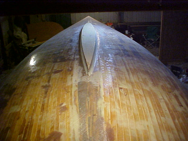

Scott Dunsworth Posted September 23, 2012 Author Posted September 23, 2012 Finally got the keel flat installed. After checking, double checking and rechecking, alignment and position and levelness. This is the first time I used chopped fiberglass mixed in the epoxy. Some areas were going to be a little thick so I used the chopped glass with silica. The glass fibers were about 1 inch long, don't know if they strengthen epoxy much, but figured they couldn't hurt. So its on to sanding, fairing the glass overlaps and laying up the keel. Just about given up on getting this thing turned over by winter, just too much to do, to get there! Scott Quote

Scott Dunsworth Posted October 6, 2012 Author Posted October 6, 2012 Been to busy to get much time on my boat. I will get some more keel lamination's cut out this weekend. Out of epoxy again so I'll just keep cutting and shaping pieces for the keel. The high temperature of the shed really cured the the glass super hard. We will be sanding on it again for a while. I'll post a picture of the keel flat this weekend from the top of the barn, you can really get a idea how wide she is from up there. As soon as Graham gets me some direction on cutting the stern I am going to get that cut in. Peter hope you bring us up to date on your 28 with some more inspirational pictures. I need extra motivation please!! :) Scott Quote
Scott Dunsworth Posted October 9, 2012 Author Posted October 9, 2012 The keel flat, the shadows are playing tricks with the pictures, she's right on the money. Quote
Hirilonde Posted October 9, 2012 Posted October 9, 2012 On a conventional carvel planked boat it would be called the plank keel, though I am not sure the term applies here. So much of the old terminology is very concise and useful, but loses something in the translation sometimes in modern methods. Looking good! Getting that just right will make the rest of the keel work easier.* *not necessarily easy Quote
