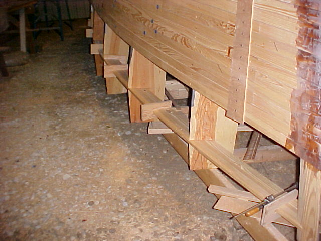

Scott Dunsworth Posted April 17, 2012 Author Posted April 17, 2012 Got a day on the boat today. Got the shear marked along with the deck shelves cut in and one dry fitted. Picked up the rest of the cypress today. So if I can get the shelf's glued up Saturday, we should be able to finish stripping next week and maybe epoxy the hull the following weekend. Quote

Scott Dunsworth Posted April 17, 2012 Author Posted April 17, 2012 Jim I'll see what I can do. The building shes in is 24x40 and the saw horses you see are about 40 inches tall, that should put things into scale. Quote
Scott Dunsworth Posted April 18, 2012 Author Posted April 18, 2012 Like I said earlier we got one shelf dry fitted and the other cut into the frames. Also this is my wife Dina who is always pushing me to get done so we dont have to look at SNOW anymore. Quote
Steve W Posted April 18, 2012 Posted April 18, 2012 Jim was right....I had no idea the boat was that big! Thank you for posting! Take Care, Steve Quote
Jim Stumpf Posted April 18, 2012 Posted April 18, 2012 Thanks Scott, and thank the lovely Dina for adding some prospective. Really is looking good. Jim Quote
