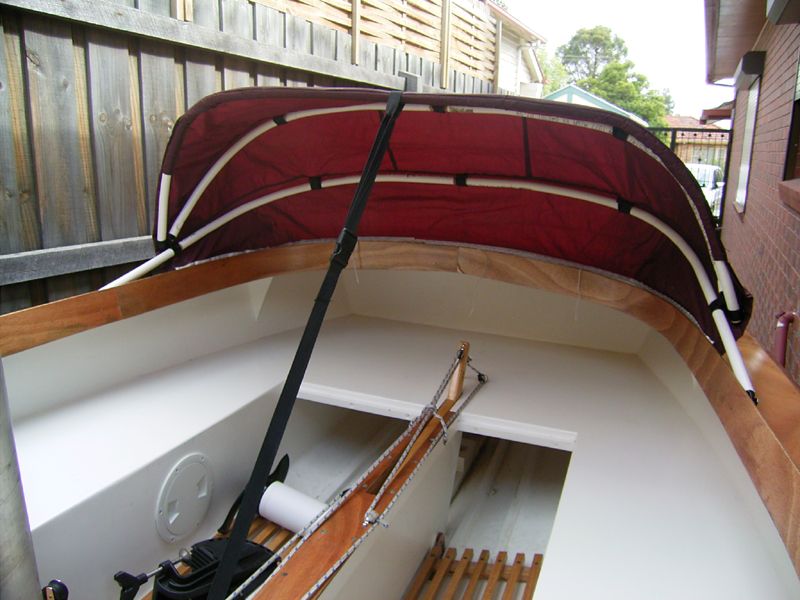

Hi Harry
You might find this site helpful re a mini dodger
http://www.batchelors.net/personal/boat/cs17/index.html
Quite a nice job of it as shown on these photos
[attachment=1]
[attachment=2]

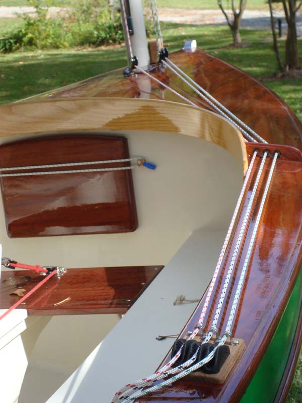

For the times you might be sailing in cold conditions, a dodger that works under eh mainsail should be nice.  In warm weather, a little water on the tush is not bad.  The photo shows the coaming I put on Lapwing.  I added a splash deflector that serves as fairleads for sail controls.  this directs some of the splash off the sides.  When all is said, the best spray deflector is a crew sitting to windward of you :lol:
Dean, I think that the coaming is one of those design details that can be customized by owners.  If one wanted, he could run a coaming completely back to the transom and that would be the driest configuration.  Or, one could build a short coaming just at the front like Tom's.  I'll be doing the latter.  This will let me sit on the side decks more comfortably when hiking.
Also, I'm betting that the Lapwing is a drier boat than the CS anyway.  Those lapped strakes should deflect some of the water as it's running up the bow in its attempt to find me and soak my pants.  But, what do I know?
I haven't actually seen a full set of plans for Lapwing.  Most of my builds of Graham's boats were done with preliminary plans. The Coaming was just to suit myself and I do prefer not to create a crease in my backside when hiking.  Lapwing does seem like a dry boat but I don't know if it's drier than  CS.  It is a lot drier than the Bay River Skiff 15 and most of the small boats I've sailed.  It is definitely a little noisier, but I like the sound of water rippling off the strakes.
The control lines are for the mainsail snotter, halyard and downhaul.  Snotter and downhaul are needed close at hand for good control of sail shape.
