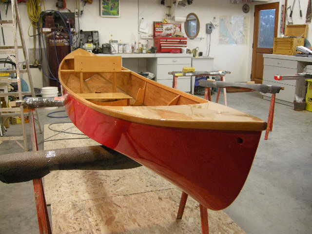

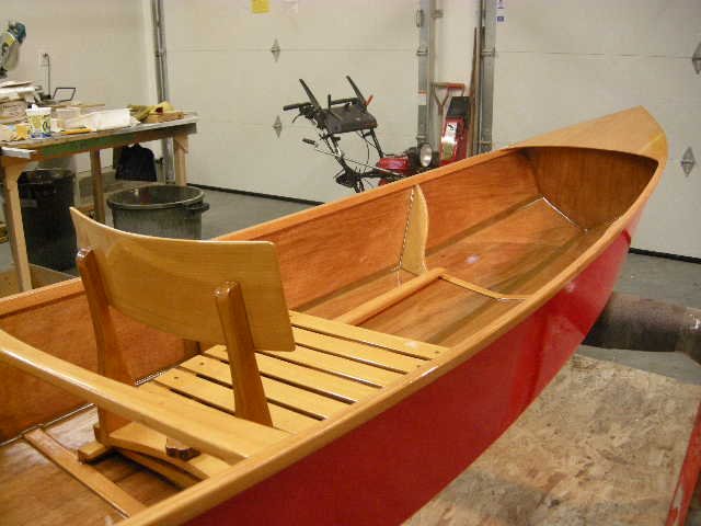

  3. Here are a couple of pictures of my slightly modified Flyfisher canoe I just finished. First time trying to post photos hope it works. I now have drawings for CS17 hull# 289 and hope to be ordering material soon. Harry Gunther
