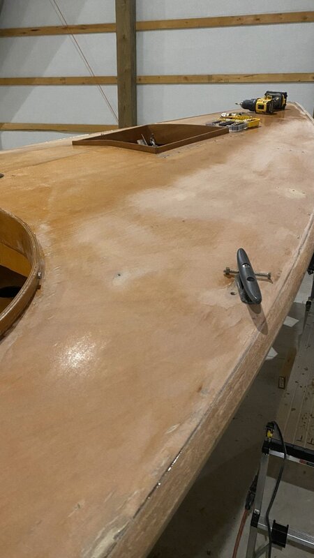

I got some good work done today!  got all the hardware off the deck--that was harder than I thought it would be.  Different screws and bolts, and applied differently.  Some just right through the deck, some with bolts in various stages of rusting, and two pernicious ones with small bolts recessed up in holes.  A big thanks to child number 3 for his help!  He even wedged down into the forward compartment to get at one bolt!
We are starting with the deck because it has many areas where the varnish is blistering or peeling off.  I scraped those and then we got to work with the orbital sander.  First 80 grit, which was very useful for digging into the very rough areas.  Then 150 and 220.
