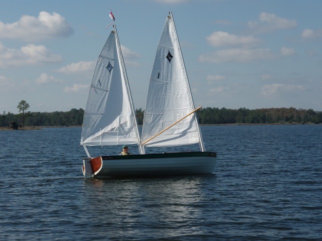

  3. My CS20 sails solo in plenty of big water. I prefer to keep the boat light myself, and plane over the waves. The idea of weight bouncing around in the boat doesn't appeal at all. I do like the hiking strap. I use a clip on harness myself, plus sometimes rig a line to the mizzen just for hanging on to. Hiking out does help to keep the boat running flat and fast. I also carry good water proof clothing, knowing I am going to get wet when sailing fast in a chop. In big wind I reef down and keep the boat running flat. The boat is acutally faster reefed than sailing under full sail with a rail continually in the water. Running wider angles on the wind helps when the stink is really blowing. I would expect you know all about that sailing in Oklahoma. The additional gear I carry for expeditions creates a small but noticeable impact on boat performance versus day sailing weight, and a second person an even more noticable impact. I expect the shorter water line Lapwing to be more weight sensitive. Before adding dead weight I recommend experimenting with loading the boat with appropriate provisions, keeping the cargo low and forward of the mizzen. Consider a selection of wines to pair with some fine beef nicely iced down. Take the dutch oven for cooking rasberry cobler on the beach at sundown. Carry a gallon of water per day per person, plus a few more. I like having a beach chair... Take the boat out at expedition weight and then decide if you want more weight.

  7. Good on you for getting out there. When reefed pay close attention to the Halyard, you may find dropping the halyard a few inches greatly improves the sprit angle allowing to achieve a much flatter and faster mizzen. Also don't be afraid to crack off a few degrees compared to the sloopes, making up speed for pointing high.
  8. Sailed out of Woodland Beach into Delaware bay into 15+ knots of wind with white caps plenty and 3 foot swells. A deep reach riding on the rail took us almost to the New Jersey, then turned for about a 10 mile trip west up on plane the entire way! Rode the down hill side of a single large wave for a very long time. It was a very sweet sail. Topped it off with a crab dinner fresh from my crab traps. Thanks Graham for a great boat.
