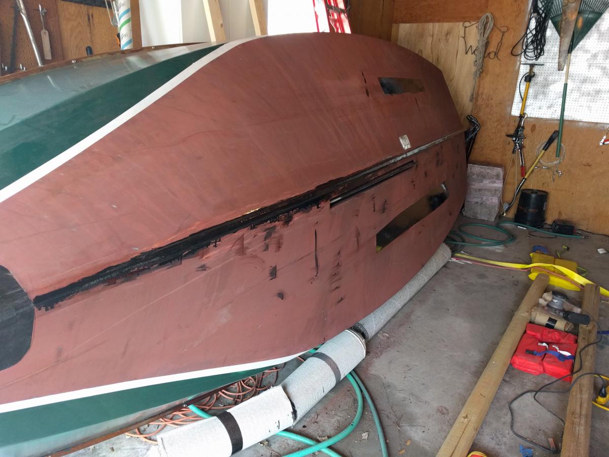

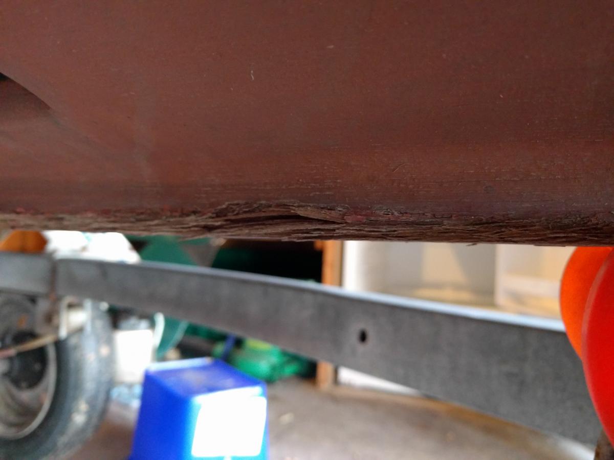

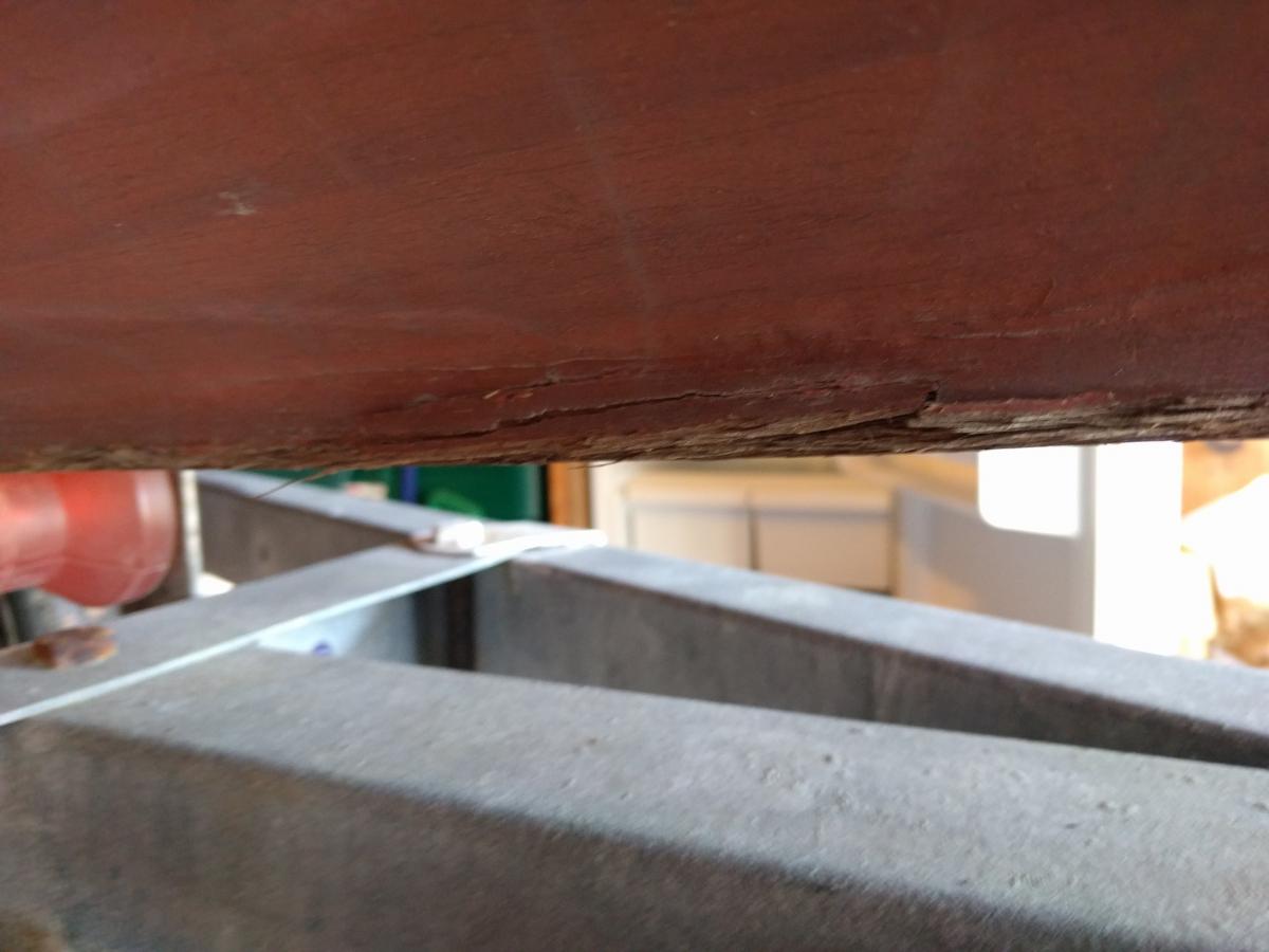

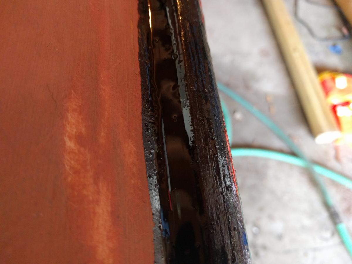

I started this thread and thought I would provide a follow-up to the original post.  After a little bit of work, I was able to get the boat off of the trailer and up on its side in my garage.  From there I was able to inspect the keel strip more closely.  With nothing more than rough sandpaper, I was able to remove the damaged wood with little work.  What I ended up with was the original keel mostly intact except for the front third whose edges were a tad more rounded. Since the damage didn't seem that significant and since summer will be here and gone quickly where I boat in northern Minnesota, I decided not to replace or scarf in a new section.  Instead, I decided to layer on wood flour fortified epoxy in some of the most damaged areas.  After this had set up, I also put a coat of carbon powder infused epoxy over the whole keel area.  I also patched over two rectangles where the paint had been rubbed off a little ( from the trailer?  I don't know.) with the same carbon epoxy paint.  The carbon epoxy idea I got from reading something on duckworks.  A lot of people swear by the stuff.  I'm attaching pictures in the next post. You will see a rather ugly job since this is the first time I've worked with epoxy in this type of application.  Drips are everywhere.  Next time, I will. be more careful and use tape and newspaper to cover areas I want to keep clean.  I'm going to see how this repair holds up over the summer and then possibly repaint the whole bottom this fall.  Thanks for all your help.
Good decision, use the boat have fun and make a thorough job in the off season. I've had good success on all my boats using Epoxy/graphite, easy to see any problems and quick to repair, if you disregard curing time.
