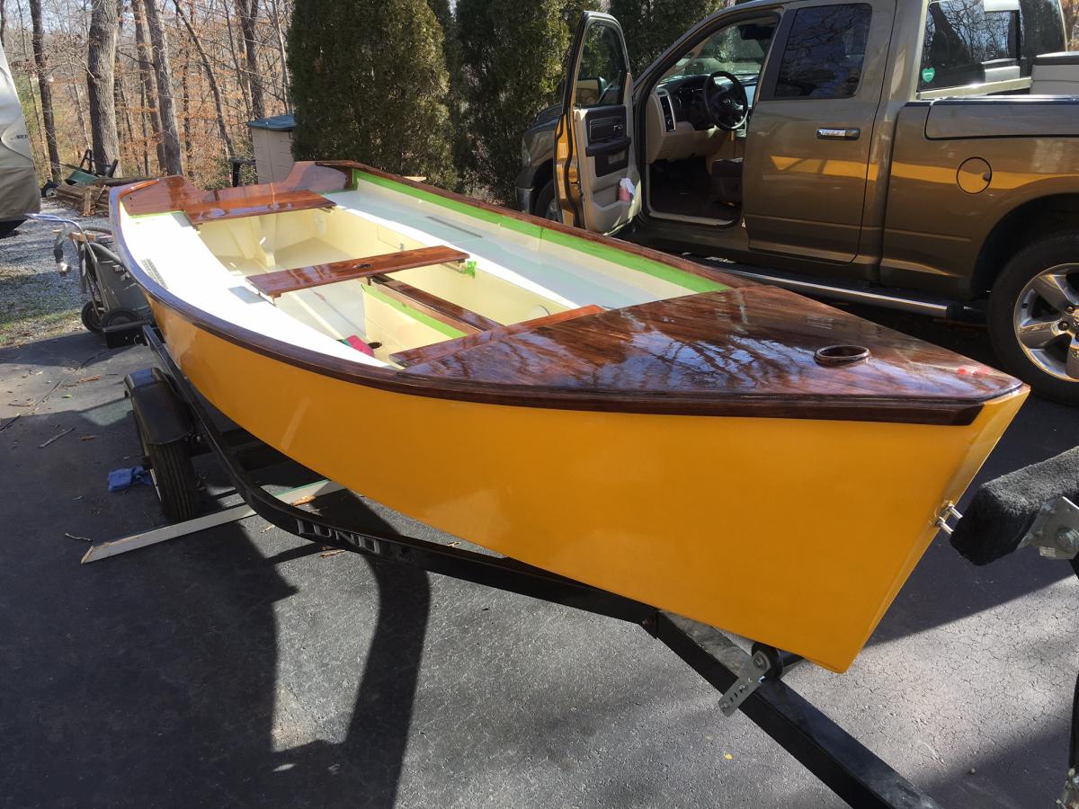

Don Silsbe Posted March 11, 2016 Author Posted March 11, 2016 I've been varnishing brightwork all week. Like the cat said, when she got her tail caught in the lawnmower "it won't be long now". Quote
Action Tiger Posted March 11, 2016 Posted March 11, 2016 The perspective in that first shot makes it look like a Dynamite Payson model building photo. It's a cool photo. From the roof? The second shot really shows how pretty your boat's going to look. The walnut and yellow look awesome together! Quote
Chick Ludwig Posted March 11, 2016 Posted March 11, 2016 Don does purty work! Of course he has about a dozen coats of paint on the hull and 30 or 40 coats of varnish on the brightwork... Nothin' else to do up here in the mountains during winter. Hey y'all----I'm funnin' ya! Quote

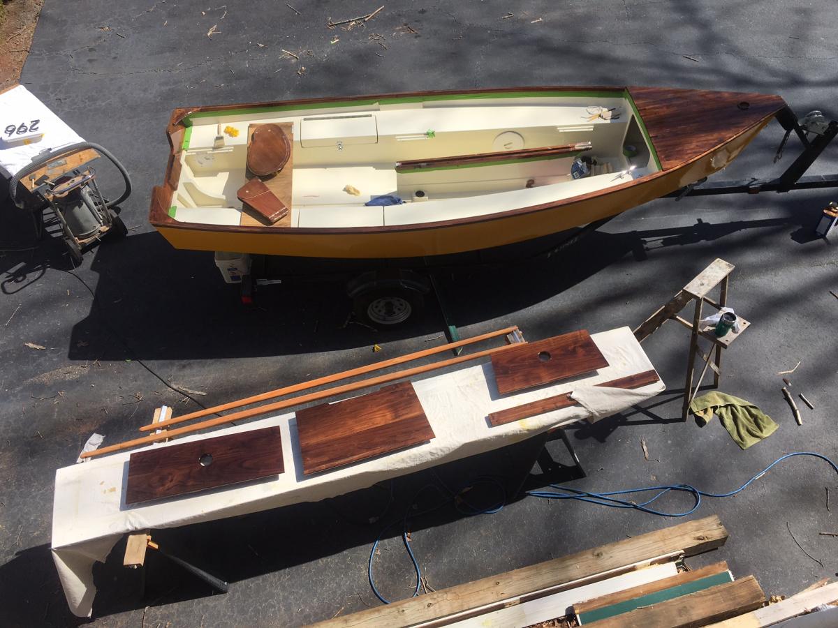

Don Silsbe Posted March 12, 2016 Author Posted March 12, 2016 I got my leathers laced on today, besides another coat of Captain's. I think I'm starting to get the hang of the varnishing! (Famous last words...) Quote
Chick Ludwig Posted March 12, 2016 Posted March 12, 2016 Lookit the cool leather stuff. Will you help/teach me to do that lacing for my sprits? I won't say anything about the varnish cause it'll jinx ya.... Quote
Paul356 Posted March 12, 2016 Posted March 12, 2016 Did you use a kit for the leathers, or just make them up from scratch? What sort of leather and tanning? Very nice work. Quote

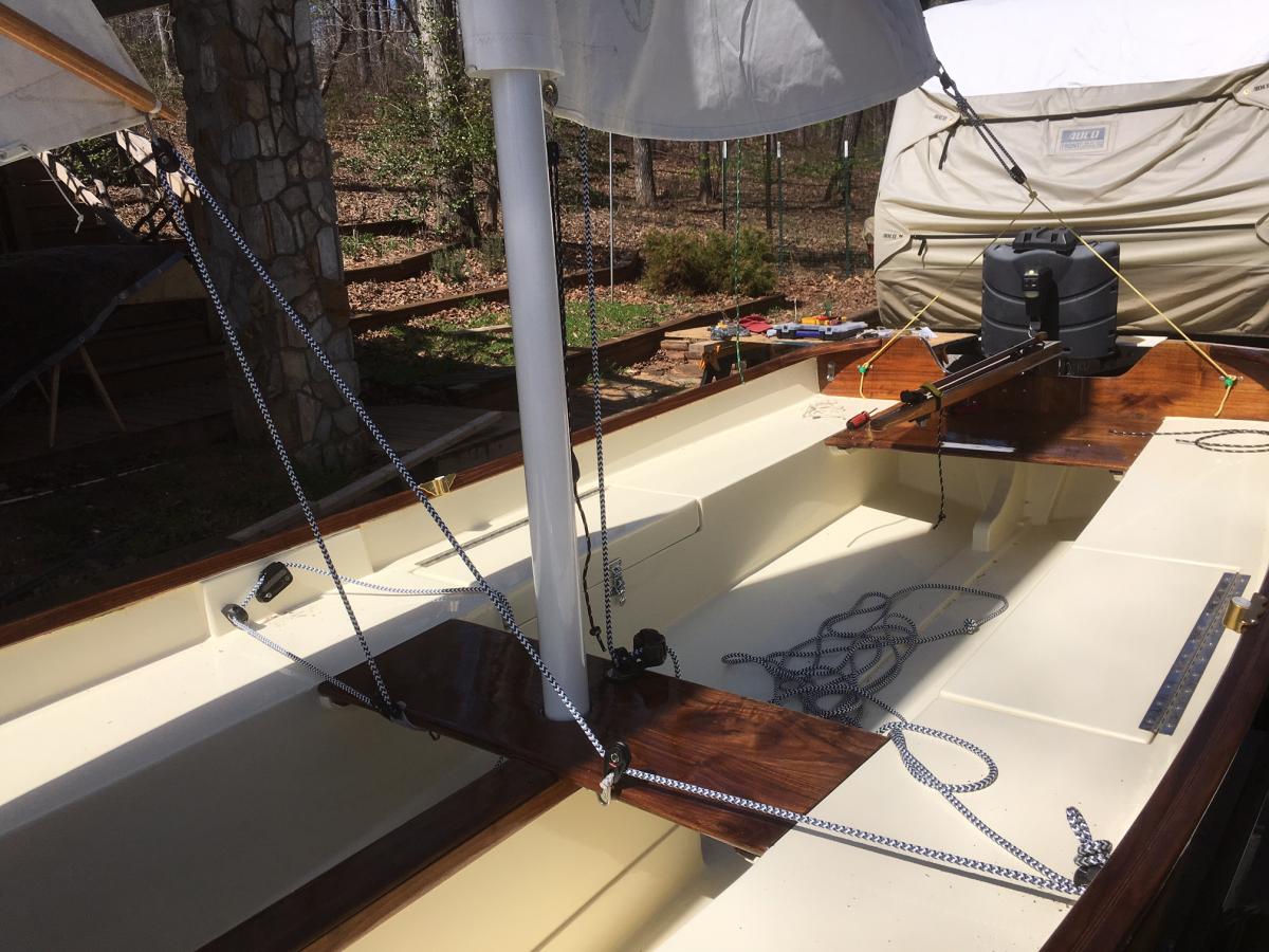

Don Silsbe Posted March 13, 2016 Author Posted March 13, 2016 Thanks, Paul. I used a kit for the oars, but the sprits were done from scratch. I bought the leather from Tandy-- a belly patch. I also bought a tool from them, to punch the holes. (See photo.) I highly recommend having one of those! By way of an update of my build, the pine pollen bloom here has brought my varnishing efforts to a screeching halt. I was hoping for another coat or two on my deck. Guess that'll have to wait for 5 or 6 weeks. Quote

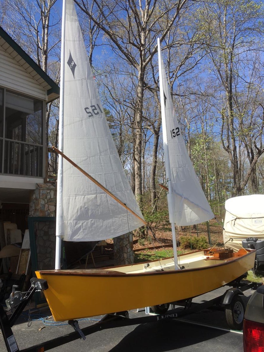

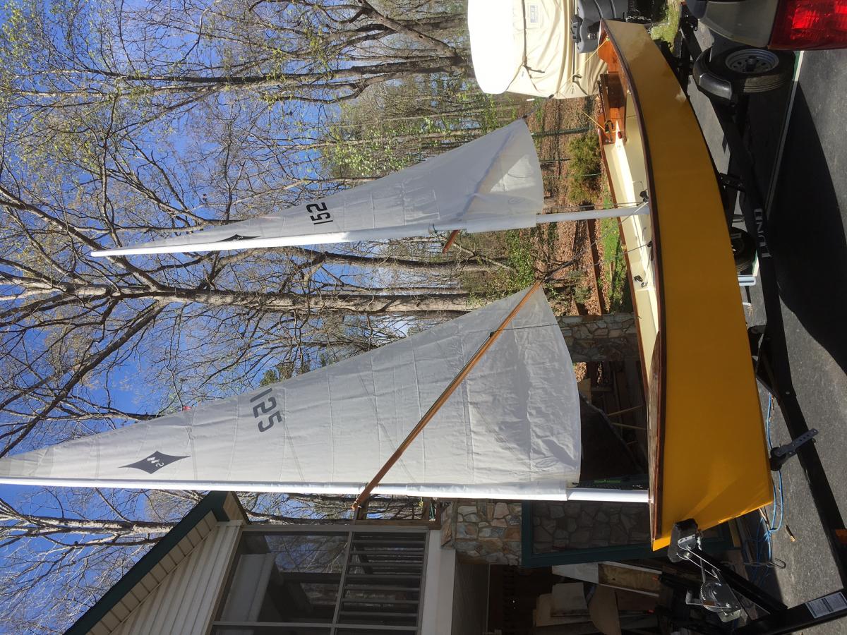

Don Silsbe Posted March 19, 2016 Author Posted March 19, 2016 I'm almost ready for launch now. Looks like the hold-up is my bride, who is out of town for a few more days. In the meantime, here are some photos of my rig. This includes my mizzen sheeting set-up. What's the trick for getting photos rotated? It appears OK when I view it on my computer. Quote

Action Tiger Posted March 19, 2016 Posted March 19, 2016 I agree. That is one very handsome skiff. Well, two handsome skiffs. That old black and white decided me to go fishing tomorrow, even though it's Saturday. Everyone knows Saturday is amateur day. This yellow BR, though. I honestly think it's the yellow that adds the last bit of fantastic. The dark rail makes the sweet sheer POP! I have absolutely no computer knowledge, though. If this phone thing won't do what I want, I ask one of my kids. Quote
Alex Posted March 19, 2016 Posted March 19, 2016 Hi Thrillsbe, Locate the photo you want and right click on it and you will find the option to rotate clockwise or anti-clockwise. It is as simple as that. Have a go and try it. By the way your boat looks great and I can't wait to hear how well she sails. Quote
meester Posted March 21, 2016 Posted March 21, 2016 A thing of beauty - upright, sideways or upside down. Just make sure the long pointy things are up when it's on the water. Quote
