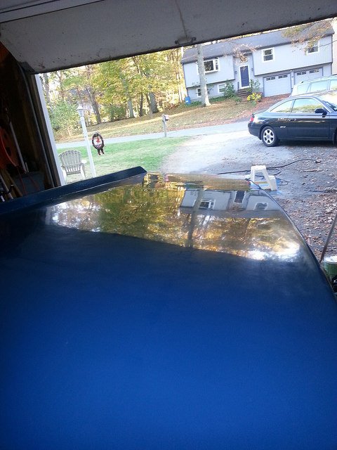

Dnjost Posted November 22, 2014 Posted November 22, 2014 Gallon of each for the exterior. If i were to do it again. I would have sanded the primer better, as it would have cut down on the amount of top coat needed to get a good finish when brushing. I found that a roller and tip with a foam brush left a tolerable coat that could be buffed. Brushing not as good. some folks used a sprayer and reported good results. I have attached a photo that shows the starboard bottom that has been wet sanded and buffed. Quote
