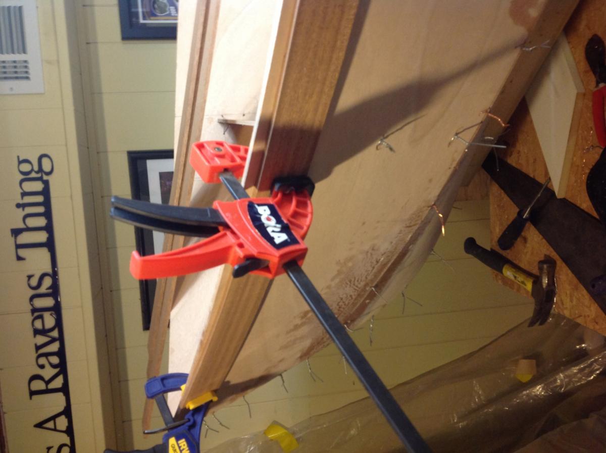

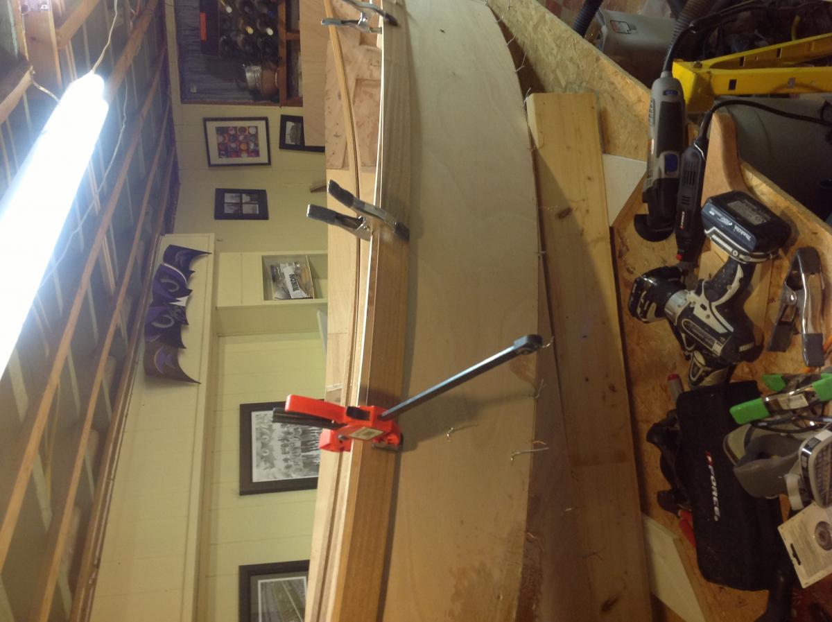

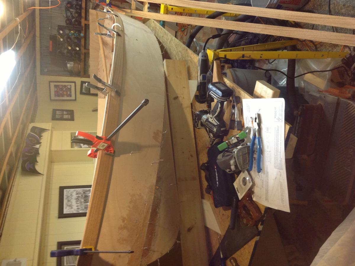

  3. Ok Thanks, Yes, you are right, the gunwales are higher than the 1.5" suggested. They're about 2 1/8". I hadn't considered the edge bending and since I had the width of the boards I thought I'd leave it. They're Mahogany and I plan on leaving the Gunwales Bright so I thought it would look nice having them be a little wider. I'll cut them down tomorrow and see if that makes a difference. I was careful when lofting and cutting out the pieces so I'm pretty sure that the sides match up. I'll double check tonight. I'll trim the boards down and see if I can get them to follow the sheer. I'll also try to take a picture of the sheer without the gunwales on so you guys can see if they look correct. Thanks for your help Collin
  4. I'm having a problem attaching my gunnels to my Spindrift 10n. I have them lined up and clamped from the bow to the stern. The problem is that part of the hull about 2 feet back from the bow sticks up higher than the gunnels. I've tried to re clamp them a few times. I know I can just plane down the hull but I wanted to get some advice before I glue everything up. Is this normal? Here it is mocked up so you can visualize it. Sorry they're sideways. I can't figure out how to get them to rotate when I upload them
