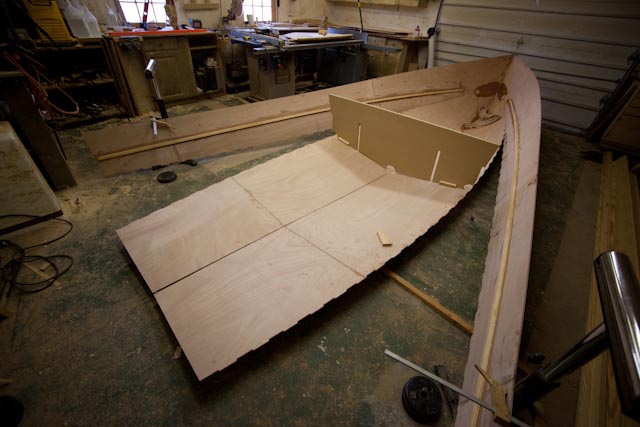

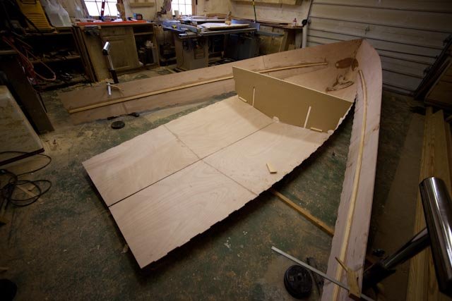

Also my temporary bulkhead is off center by about 3/32 to a 1/4 of an inch? Anything to be concerned about? I should also mention that I noticed this discrepancy after I "spot welded" the hull bottom and tacked and glassed the chines!

As for center temp bulkhead being off 1/4" - eyeball the hull and if you can't see any obvious flaws in the fairness of the chines, then no problem. I doubt a1/4" affected anything. Just hurry along so you rip out the temp bulkhead - once gone not even you will notice the tiny error. :-)
