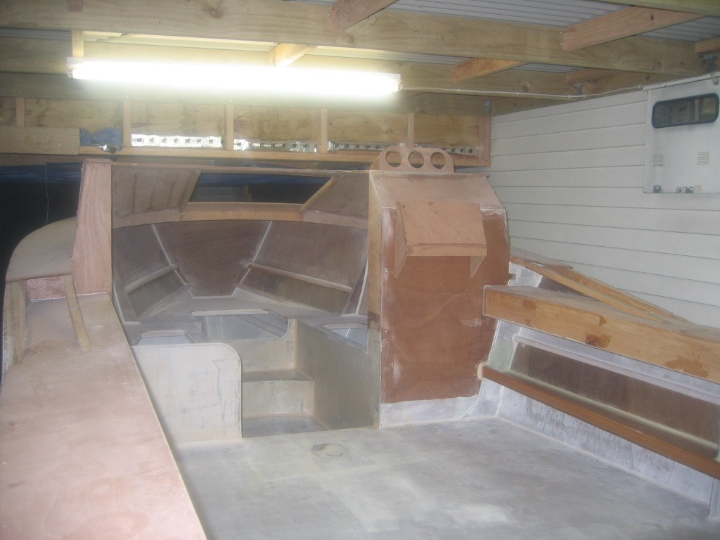

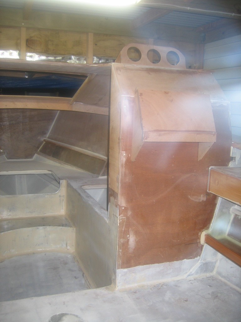

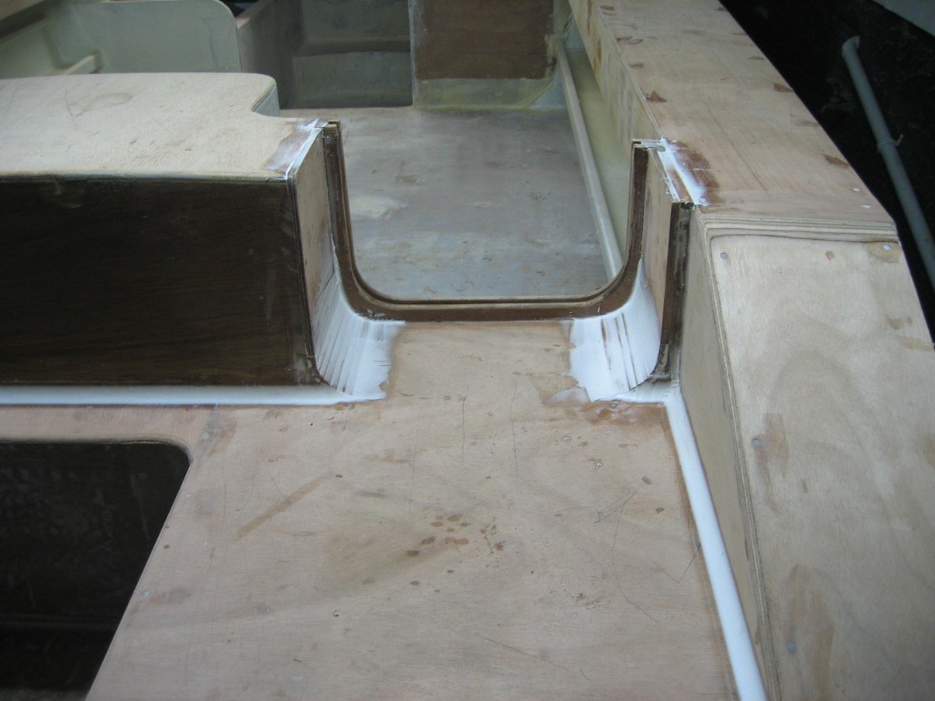

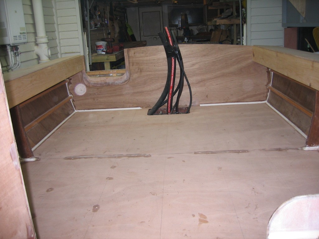

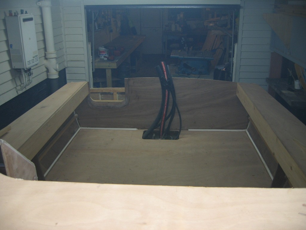

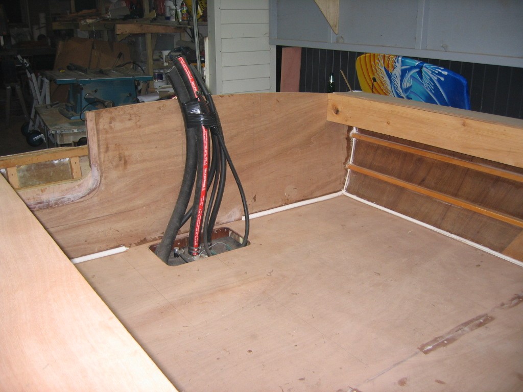

nzlance Posted April 19, 2012 Author Report Share Posted April 19, 2012 Floor and side shelves glassed. Quote Link to comment Share on other sites More sharing options...

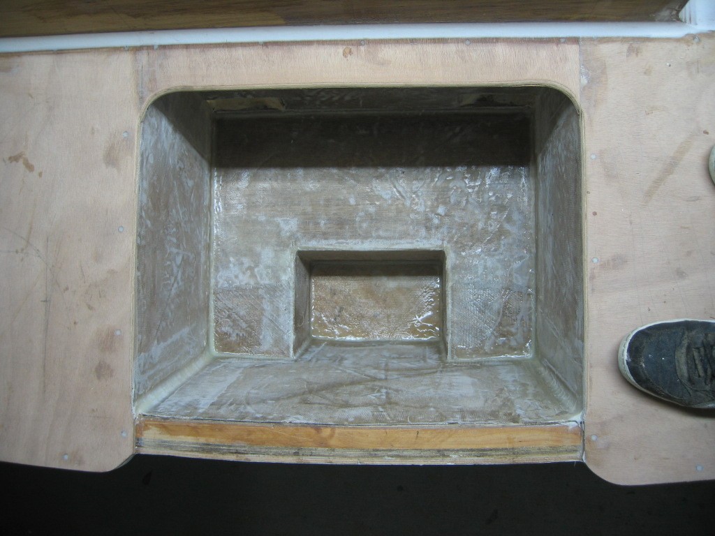

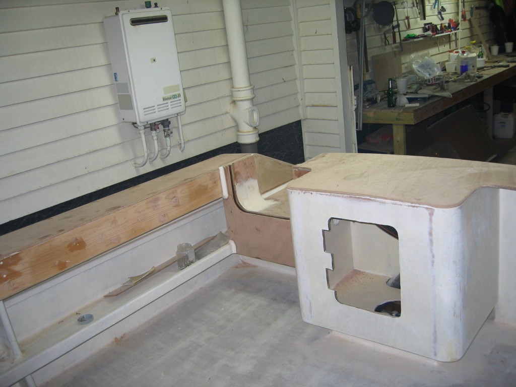

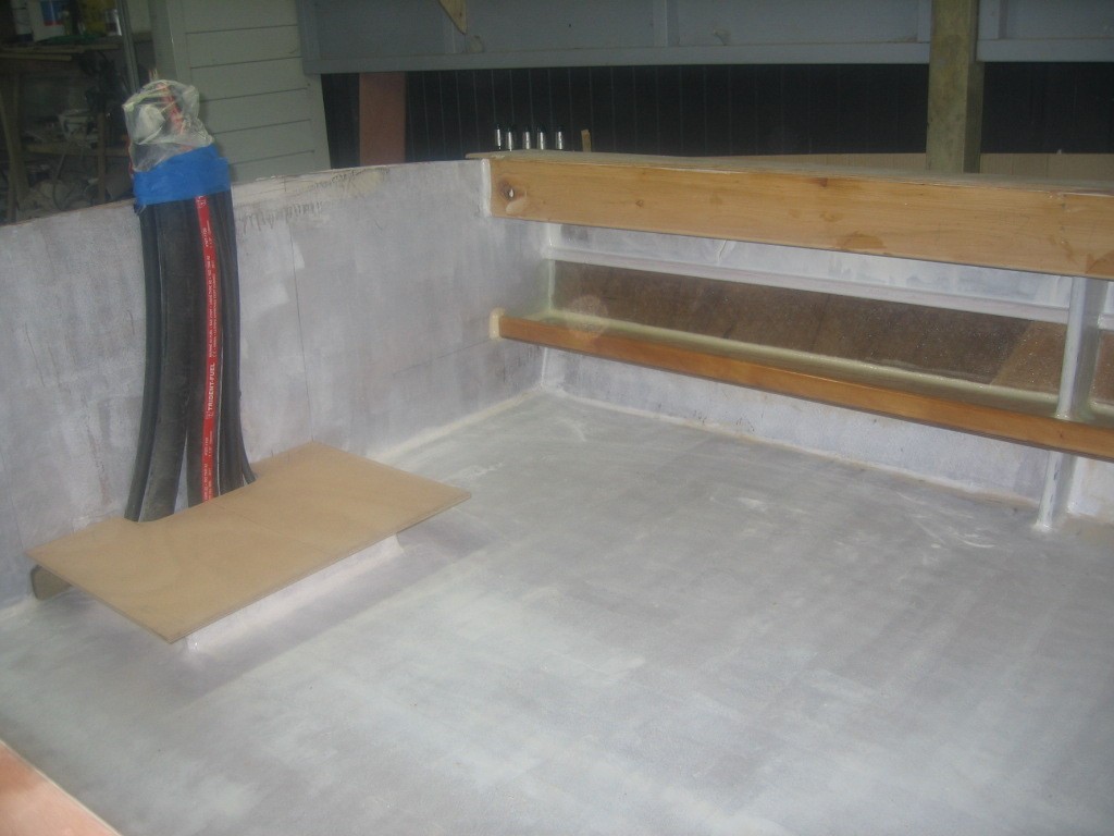

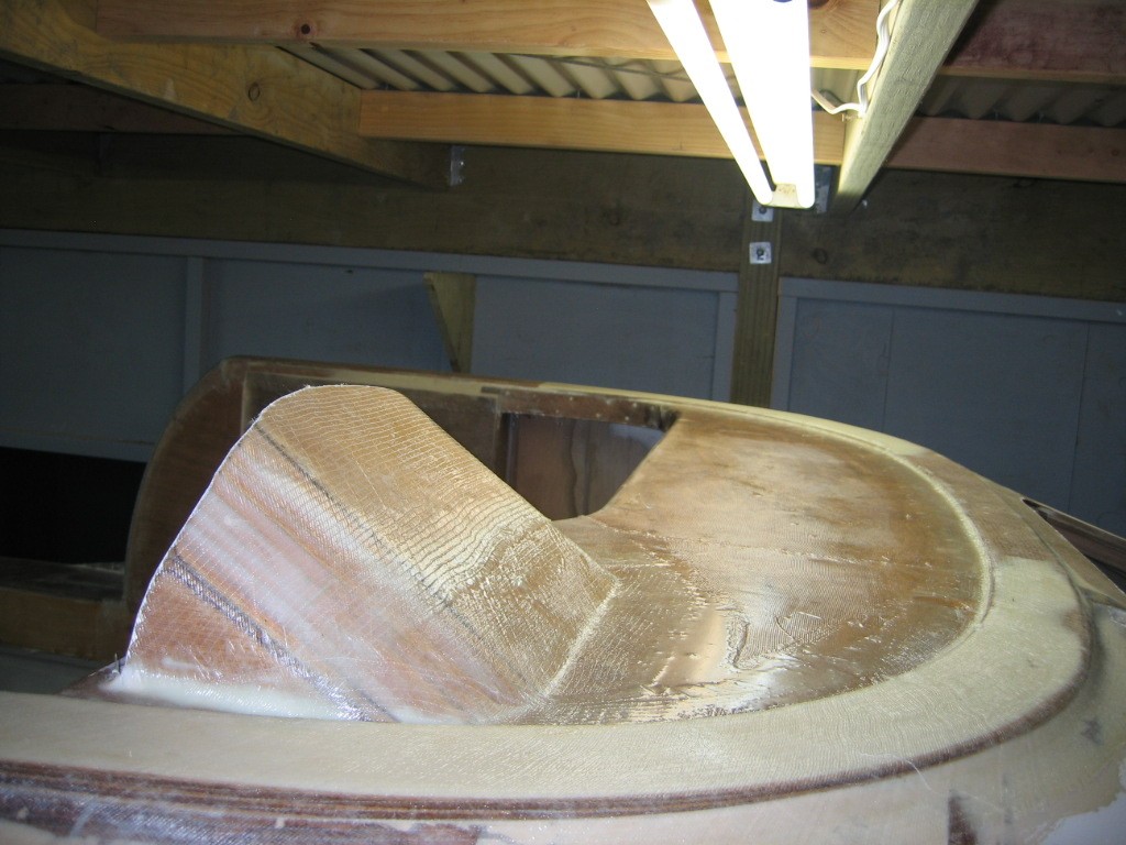

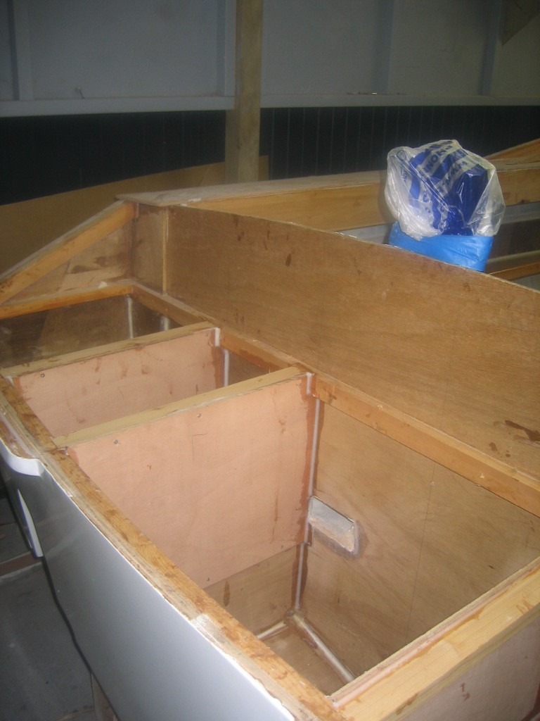

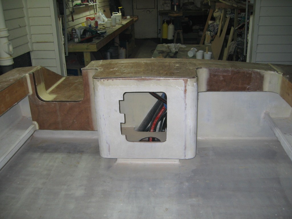

nzlance Posted April 22, 2012 Author Report Share Posted April 22, 2012 Transom locker. Quote Link to comment Share on other sites More sharing options...
nzlance Posted April 22, 2012 Author Report Share Posted April 22, 2012 Stupid computer... it is surposed to read "transom" will post more pics when this thing will upload them. Quote Link to comment Share on other sites More sharing options...

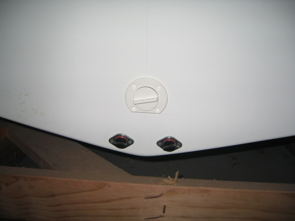

rattus Posted April 23, 2012 Report Share Posted April 23, 2012 I like the idea of a T <photo> "ransom locker". Every boat should have a full one ;-) Mike Quote Link to comment Share on other sites More sharing options...
nzlance Posted April 24, 2012 Author Report Share Posted April 24, 2012 You are right Mike.... it would certainly help fund the build! Quote Link to comment Share on other sites More sharing options...

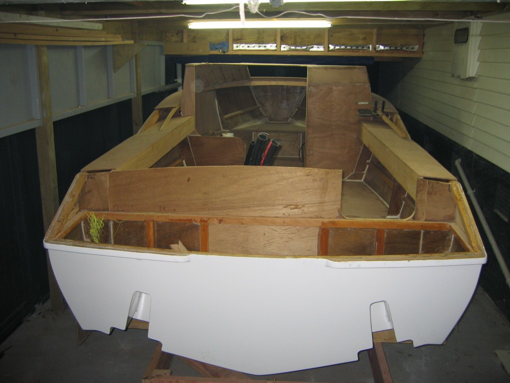

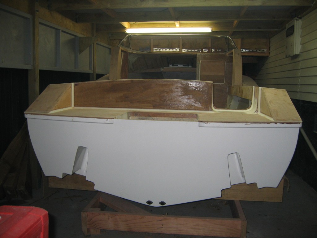

nzlance Posted May 22, 2012 Author Report Share Posted May 22, 2012 Hey look at that .....it works. Thankyou Frank. Nearly complete "ransom locker" and portifino stern. Have to form sump for bilge pump. Transom itself is over 2 inchs of solid timber , glassed twice inside. Quote Link to comment Share on other sites More sharing options...

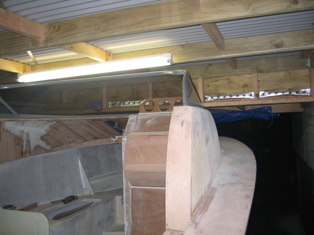

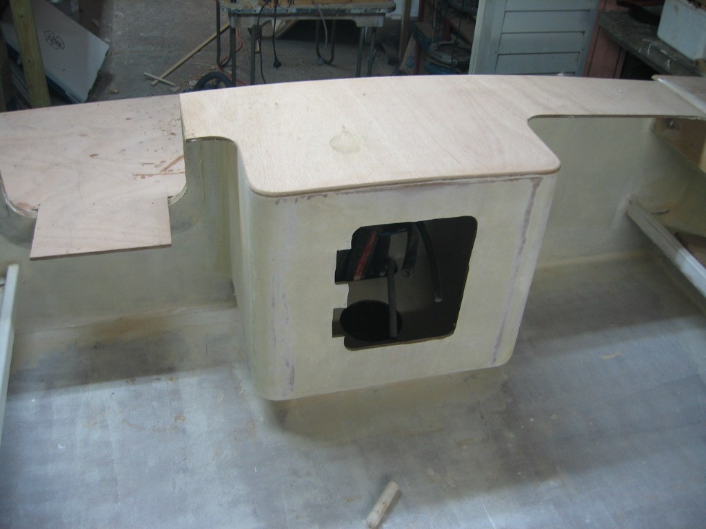

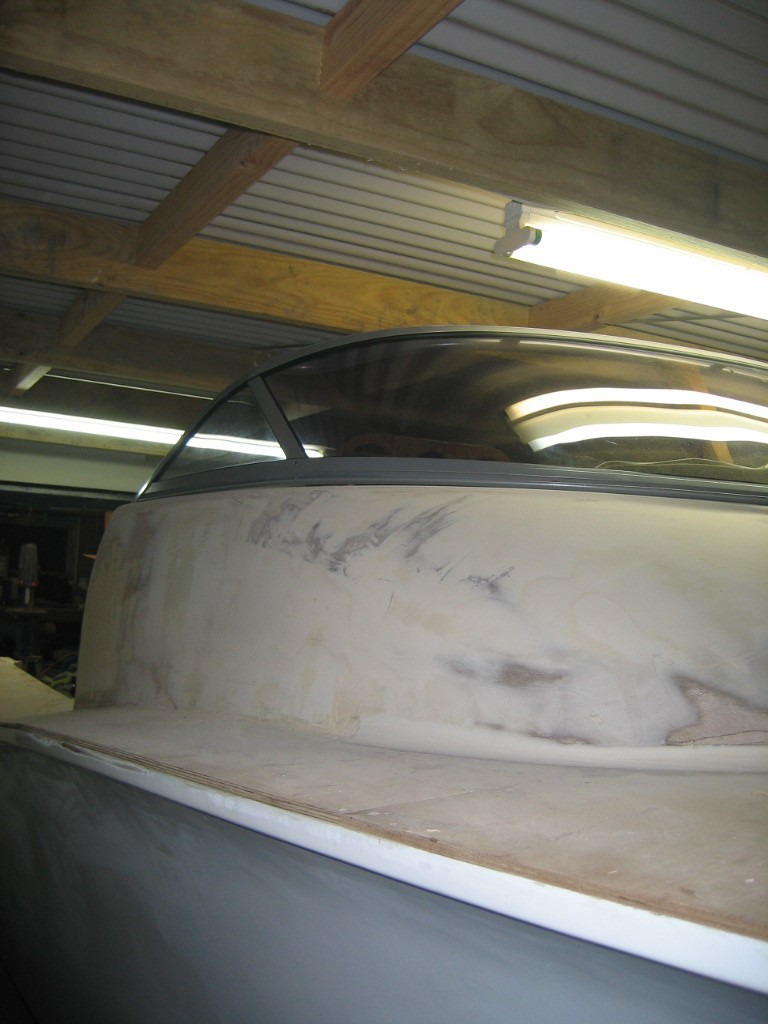

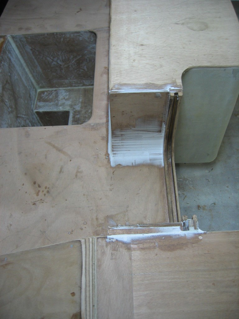

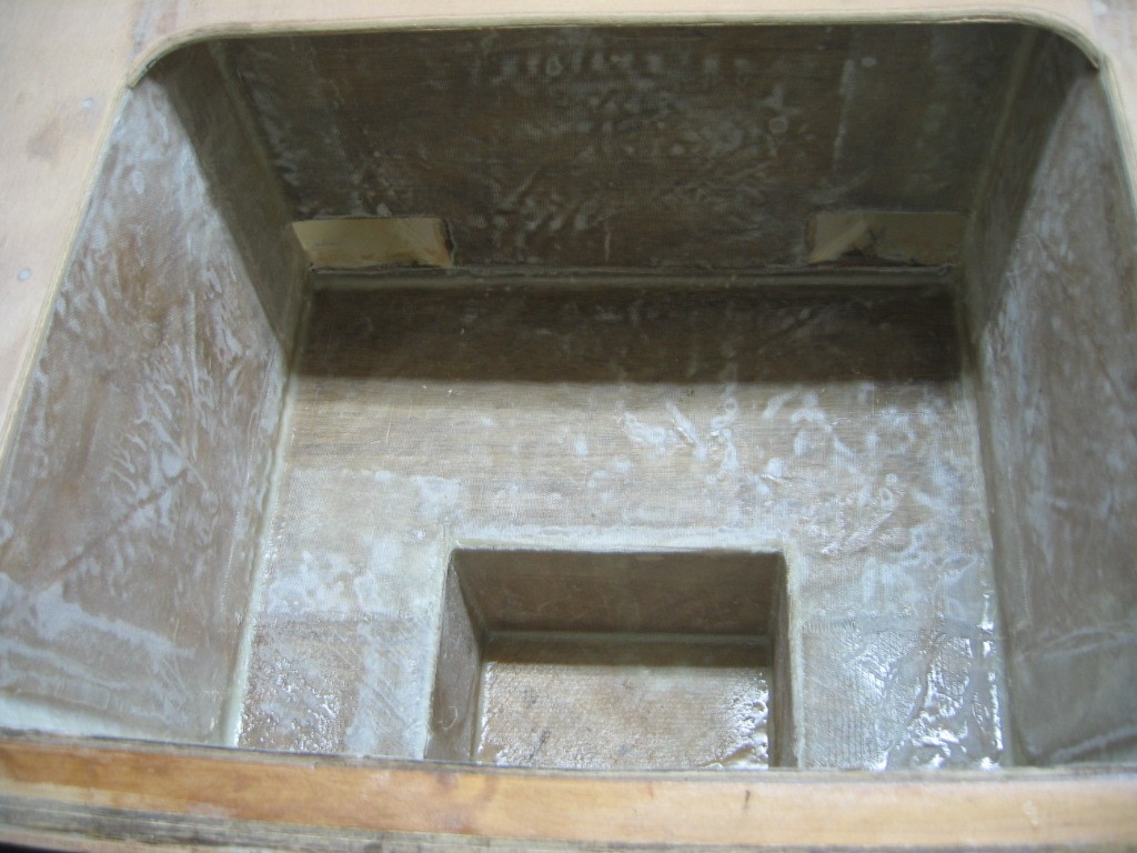

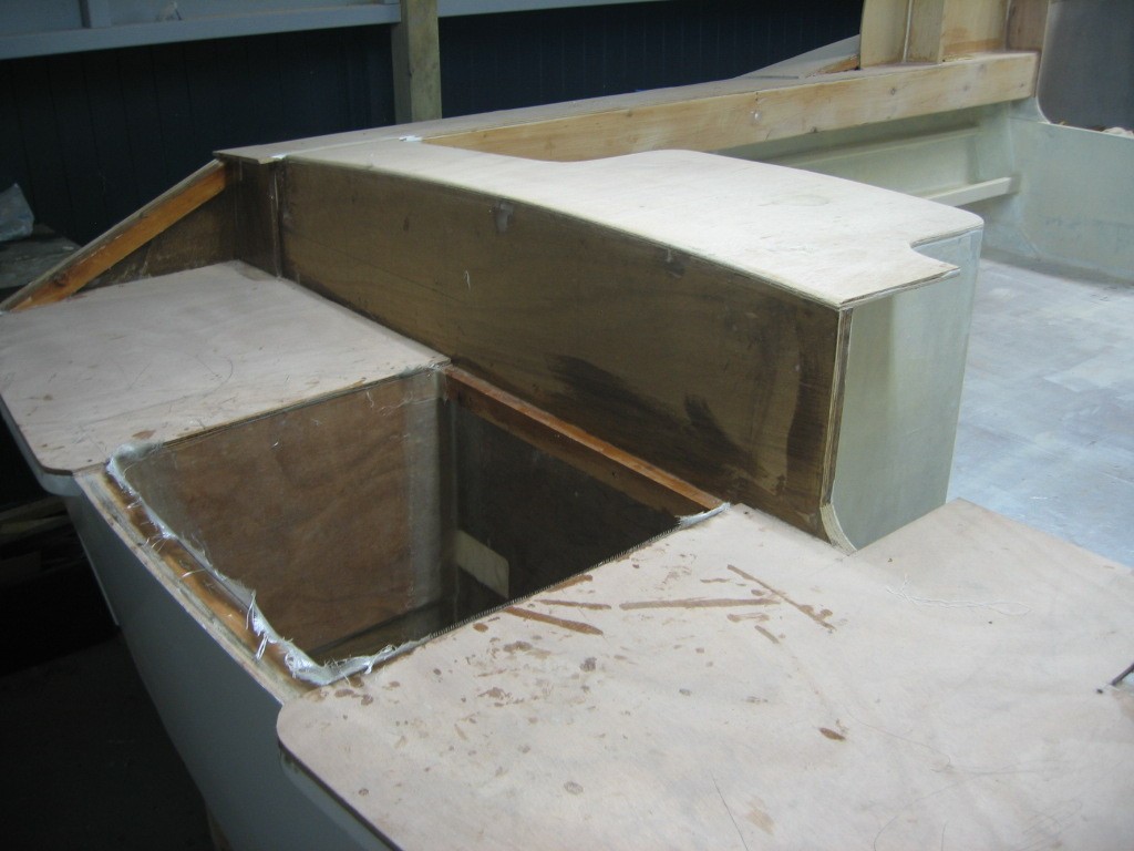

nzlance Posted May 28, 2012 Author Report Share Posted May 28, 2012 Transom nearly complete. Lots of filleting and sanding before glass though. The outboard well is going to be a live bait tank. Have to glass in a sloping top on it and cut in an acrylic hatch (apparently light helps de-stress the fish. Who the hell would ever know? ) Tank first has to be faired and coated before all this can happen. Walk through is nearly done. A pull out 12mm panel will slot into the recess created. Tinted wrap-around wind sheild turns up this week. Once I place it into position I will be able to trim the side wings to a matching curve and complete the cabin. Quote Link to comment Share on other sites More sharing options...

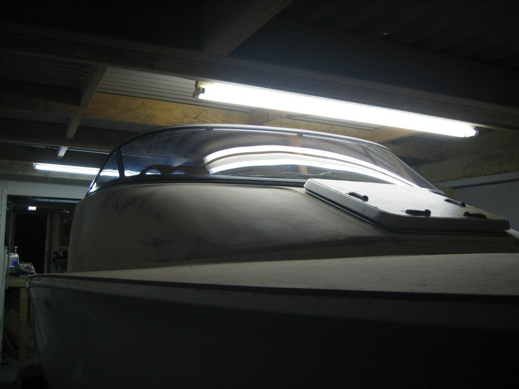

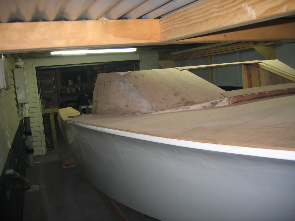

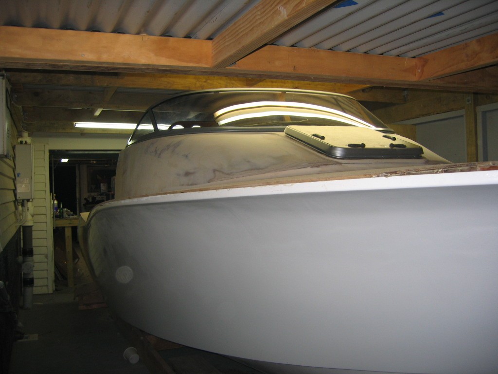

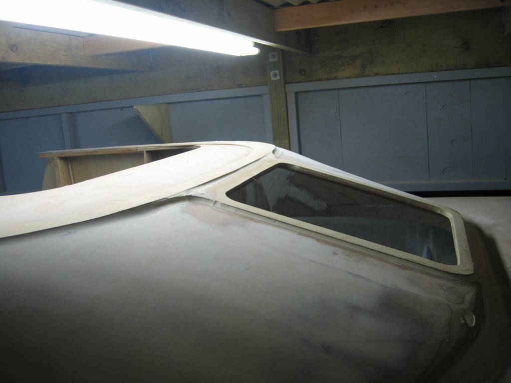

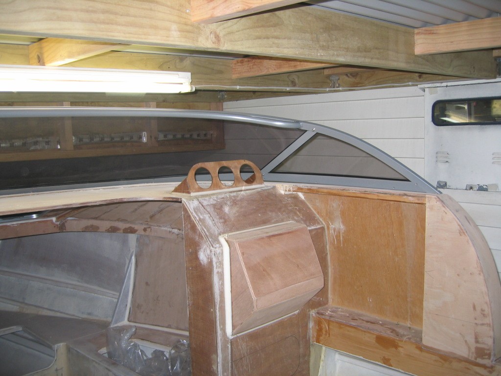

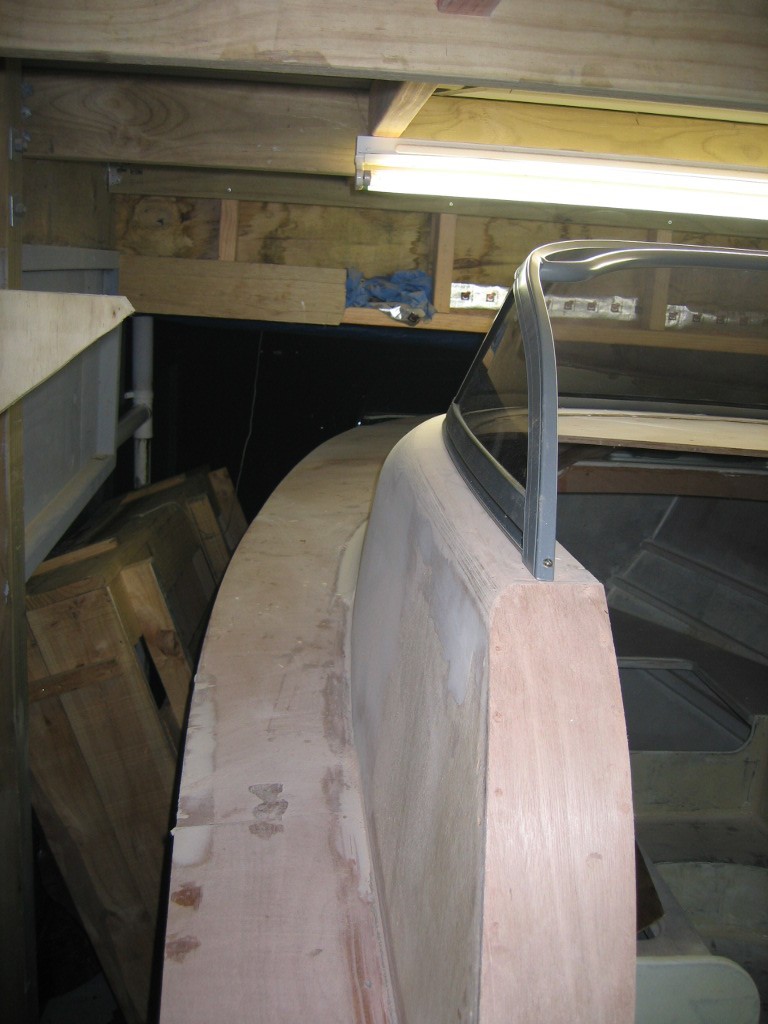

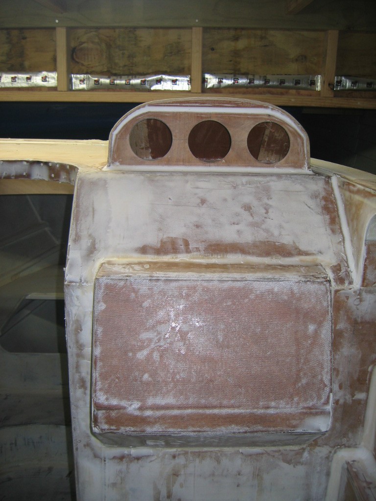

nzlance Posted June 8, 2012 Author Report Share Posted June 8, 2012 Ok heres a couple of pics with screen and forward hatch dry fitted. Building the cabin has been bloody difficult to say the least. It didnt help that I changed my mind on windscreen shape after cabin was formed, only to have to chop back into it with multi-tool and change the curve to suit better (more expensive) screen. All up though it has come up really good. I have nearly finshed all timber construction. Storage pockets to be formed on cabin side wings, finish anchor well/ bow sprit. Then on to weeks of glassing, fairing and sanding. God - I cant wait. Quote Link to comment Share on other sites More sharing options...
Peter HK Posted June 8, 2012 Report Share Posted June 8, 2012 It looks fabulous. Try meditation while sanding. No...it doesn't help Just keep sanding. Cheers Peter HK Quote Link to comment Share on other sites More sharing options...
boardmian Posted June 9, 2012 Report Share Posted June 9, 2012 Hi Lance, After almost six weeks, we are finally back on air, (after a visit from the "Farmside" man on Thursday) and your boat is looking pretty amazing. Windscreen has worked well. She is beginning to look like something out of Hawaii Five O. Nice work. Cheers Kaimai6 Quote Link to comment Share on other sites More sharing options...
nzlance Posted June 11, 2012 Author Report Share Posted June 11, 2012 Hey thanks alot Dad. Good to see you are back online. If you get bored of retired life, fishing, cafes etc there is hours of fun to be had here with a sander. And thankyou Peter, but dunno about meditation while sanding..... I just keep sanding! Quote Link to comment Share on other sites More sharing options...

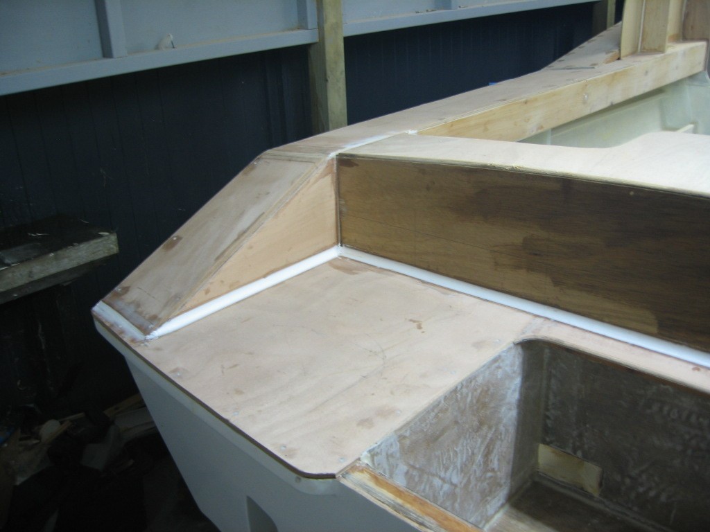

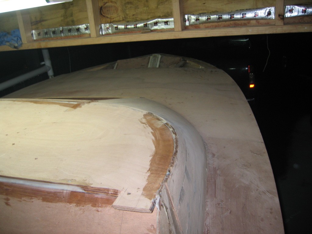

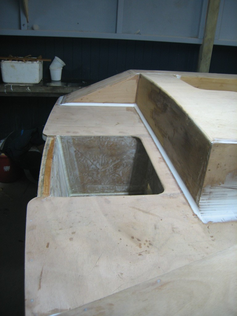

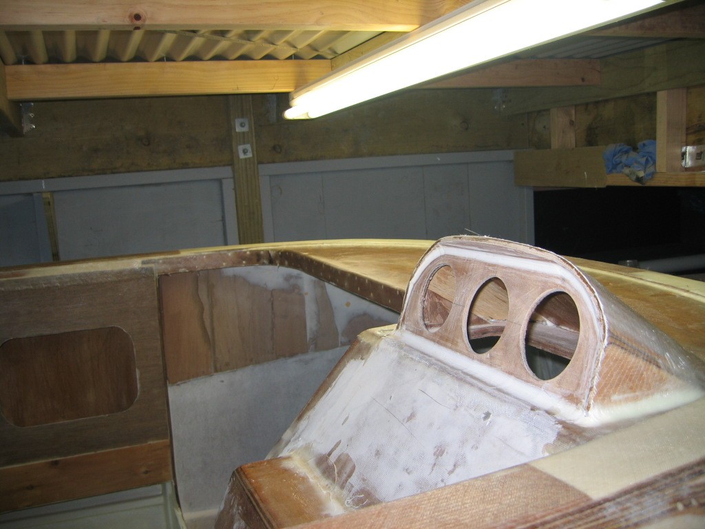

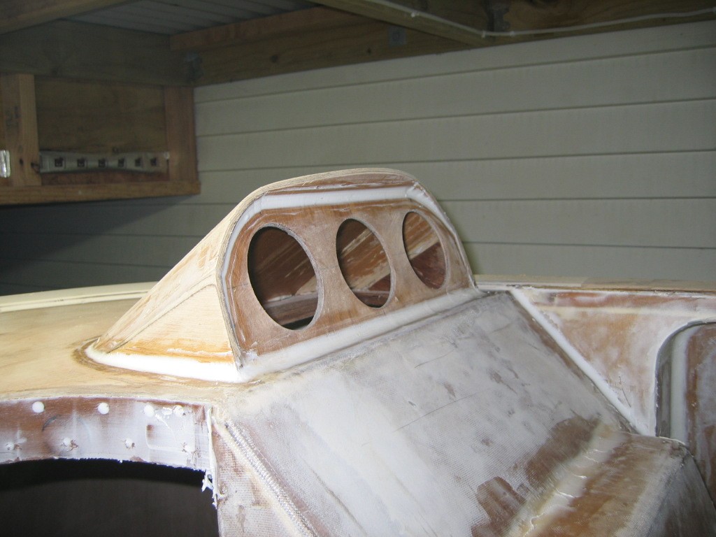

nzlance Posted June 23, 2012 Author Report Share Posted June 23, 2012 Glassed transom and gunnels, finished instrument pod. The cabin and topsides will be glassed next. currently working on anchor well. Once that is complete that is more or less all the timber construction done. Quote Link to comment Share on other sites More sharing options...

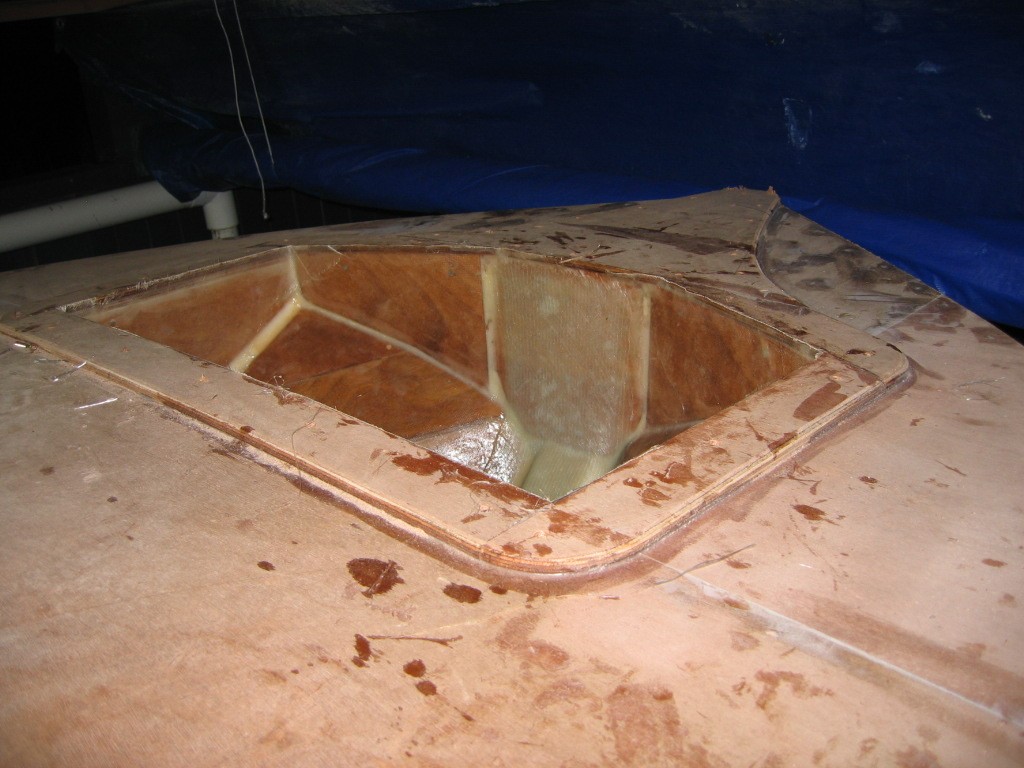

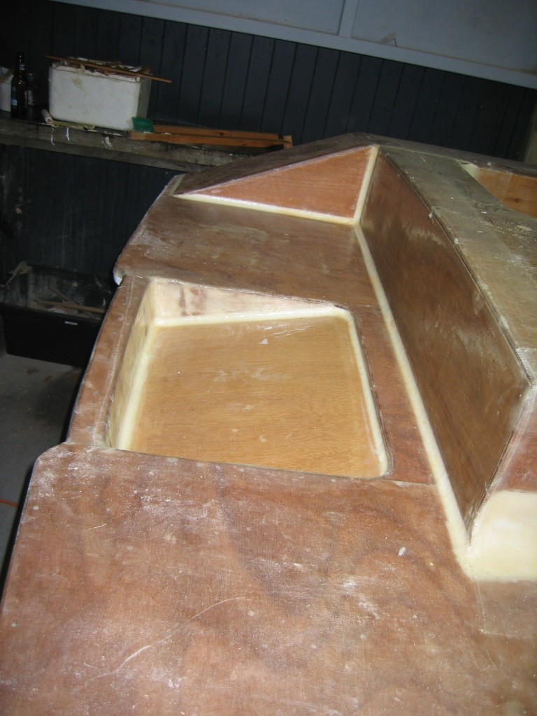

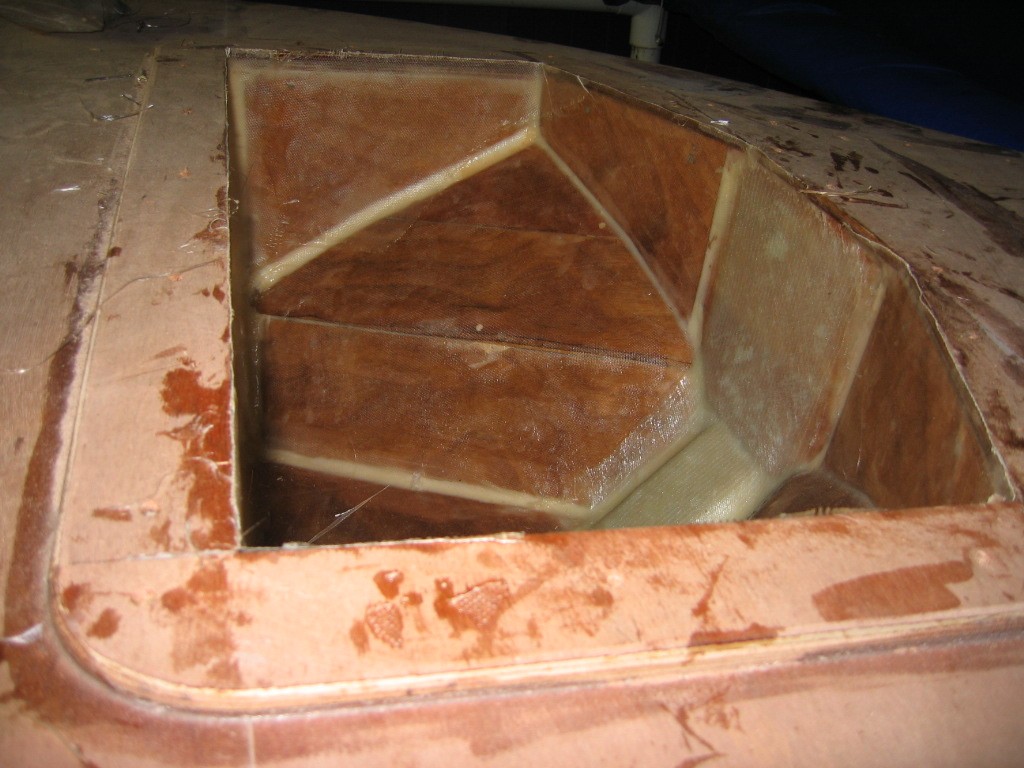

nzlance Posted June 26, 2012 Author Report Share Posted June 26, 2012 Doing a bit of work on anchor well over last weekend. Brought nice stainless self-launching bow roller which will look quite nice stuck out front. Nearly finished glassing.Just cabin sides and front hatch to go. Quote Link to comment Share on other sites More sharing options...
