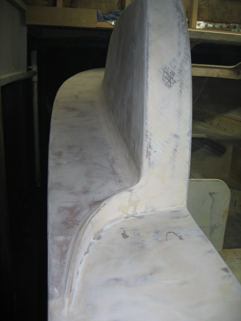

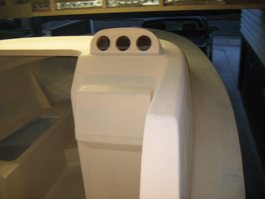

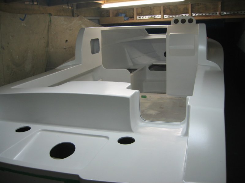

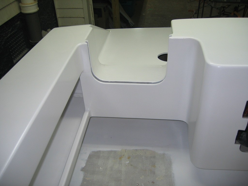

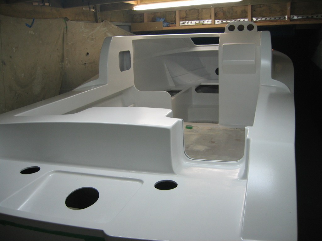

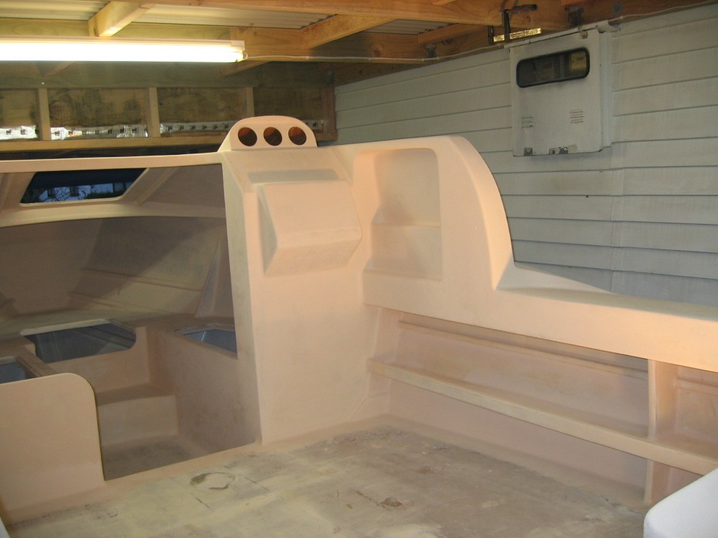

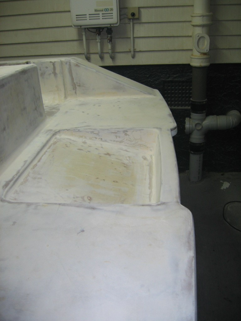

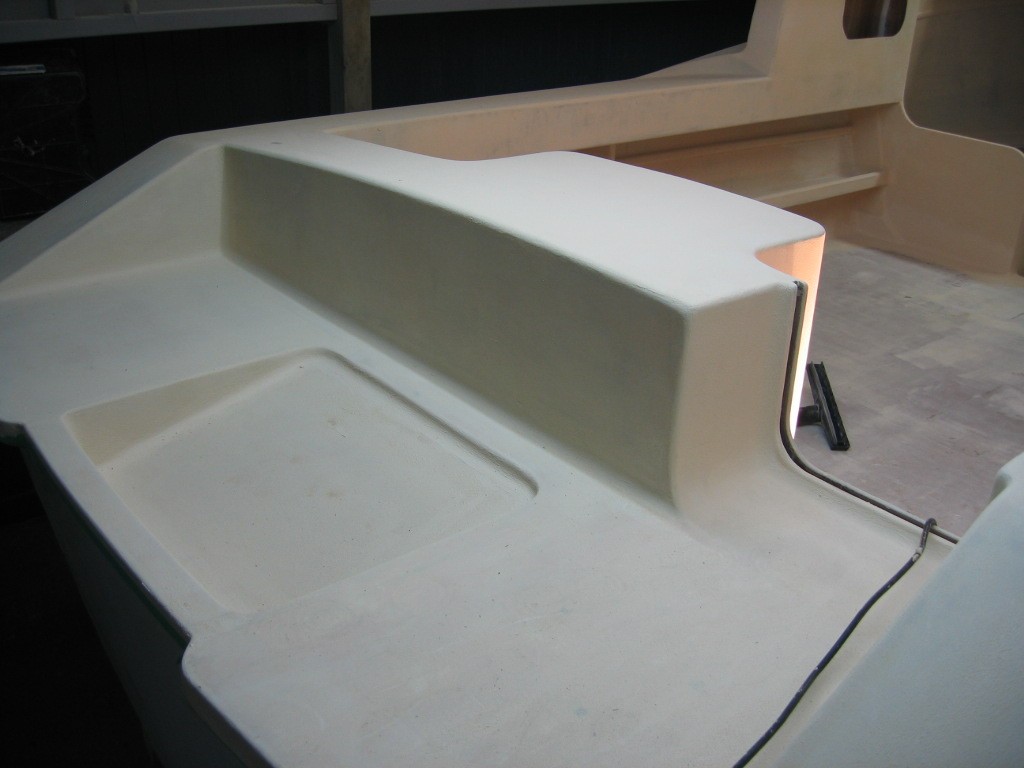

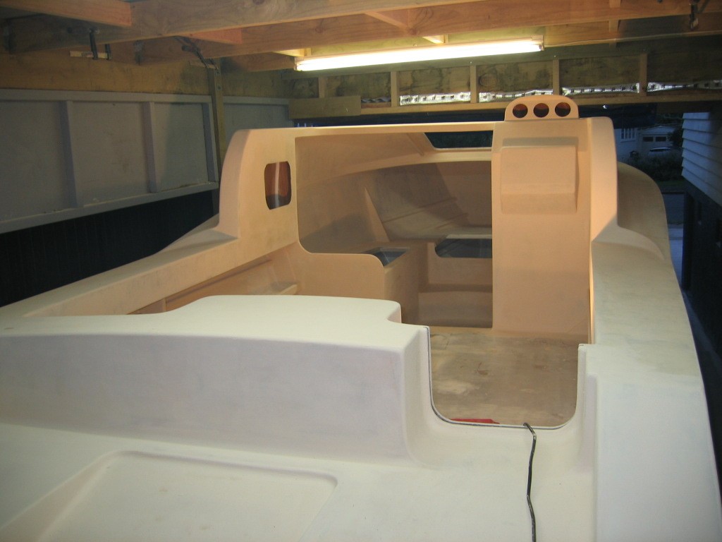

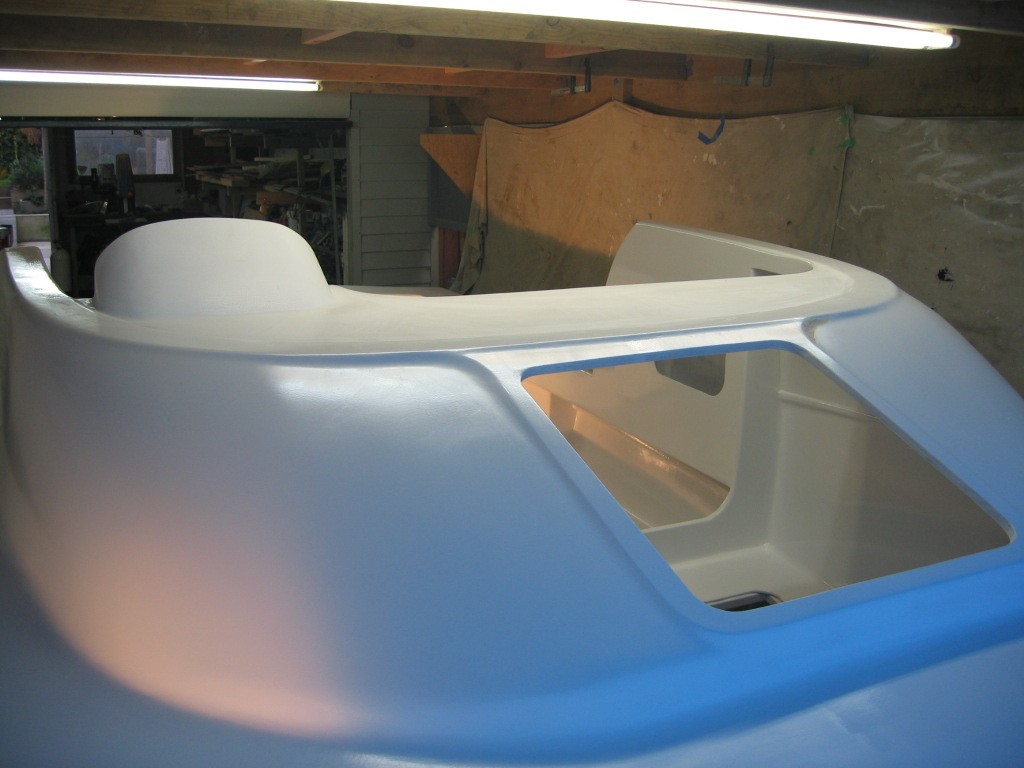

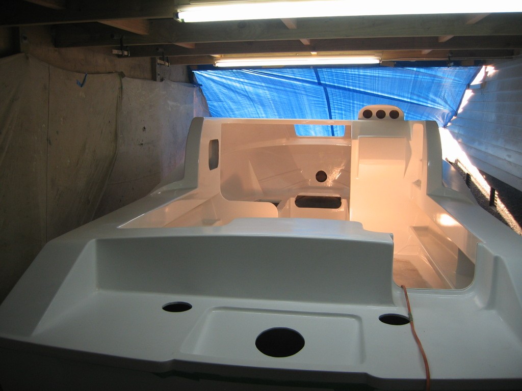

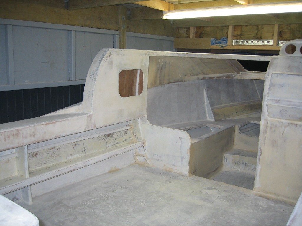

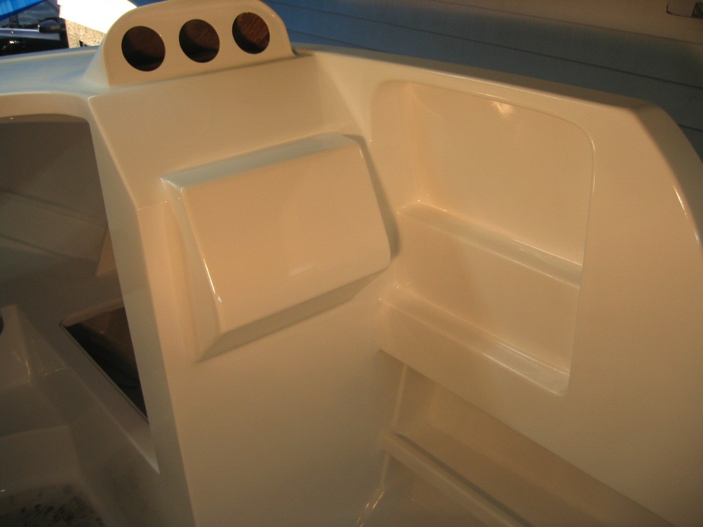

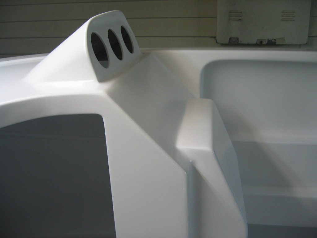

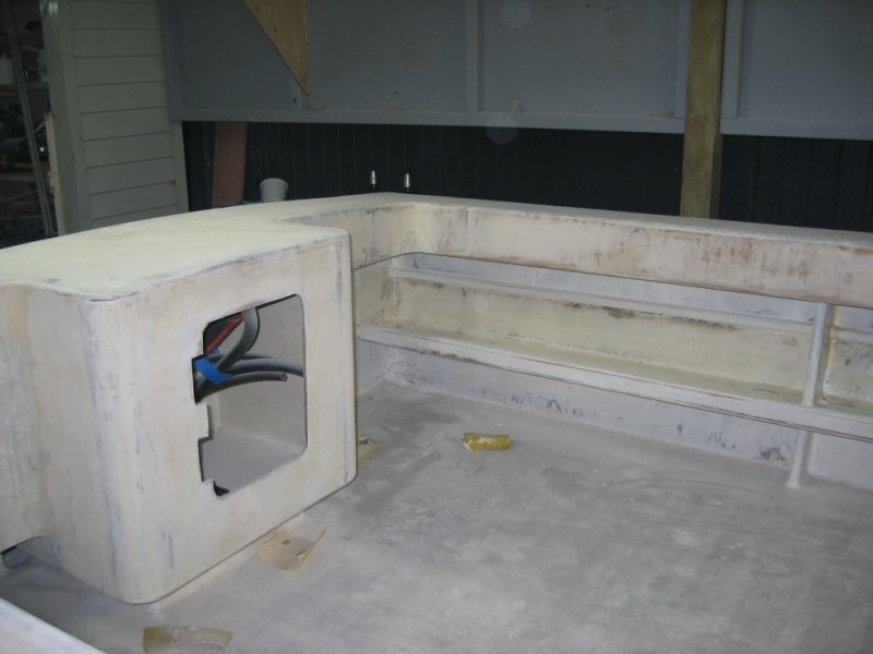

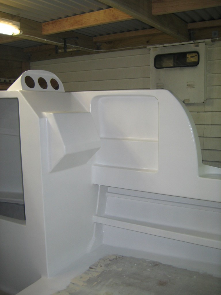

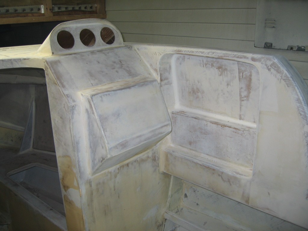

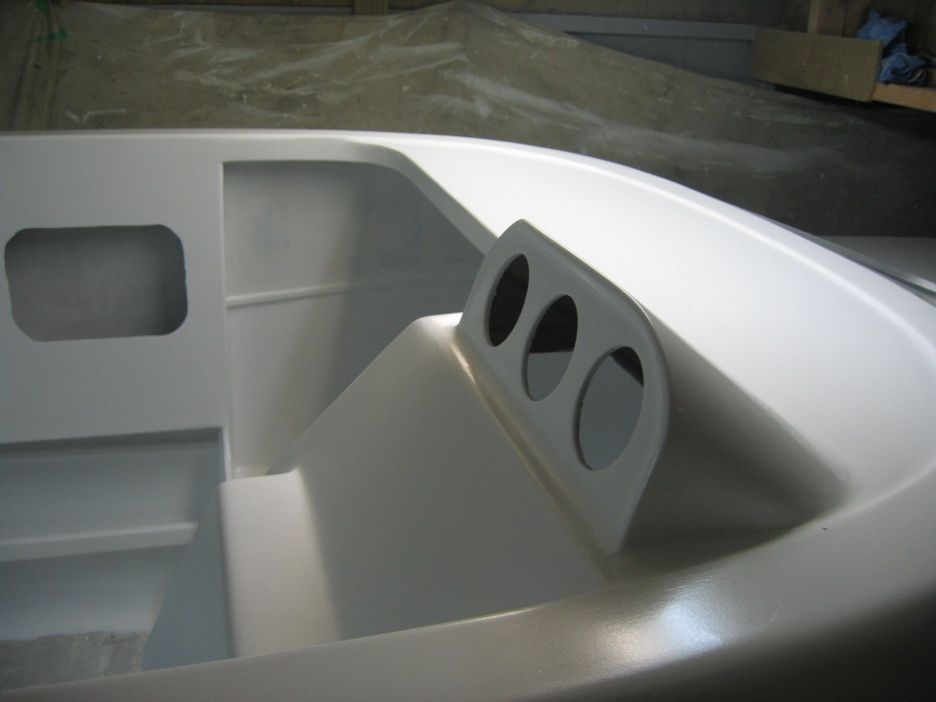

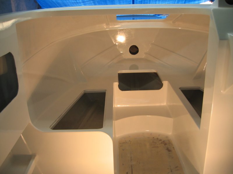

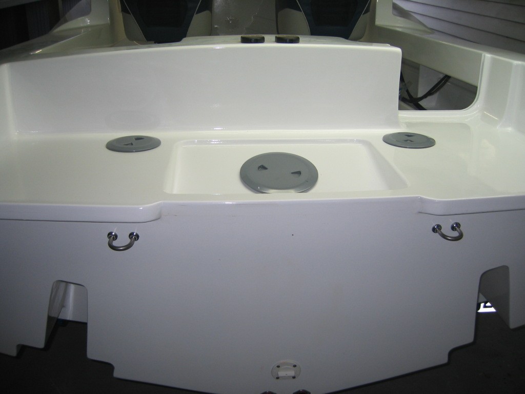

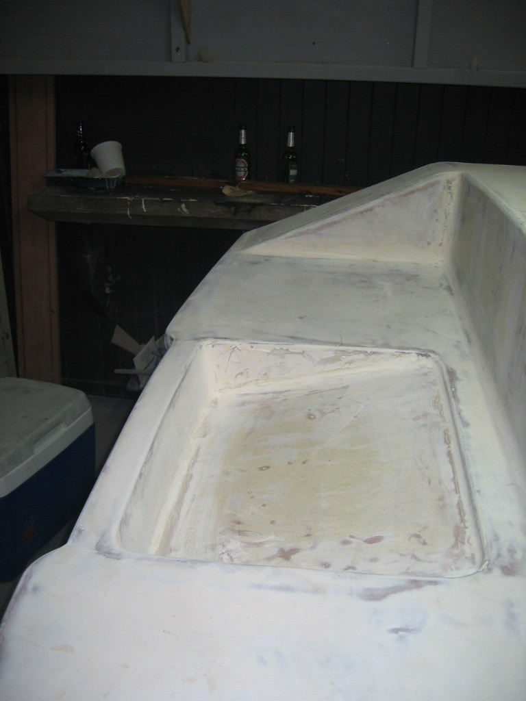

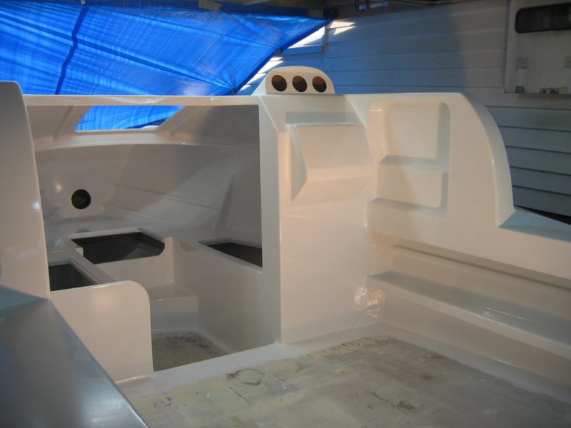

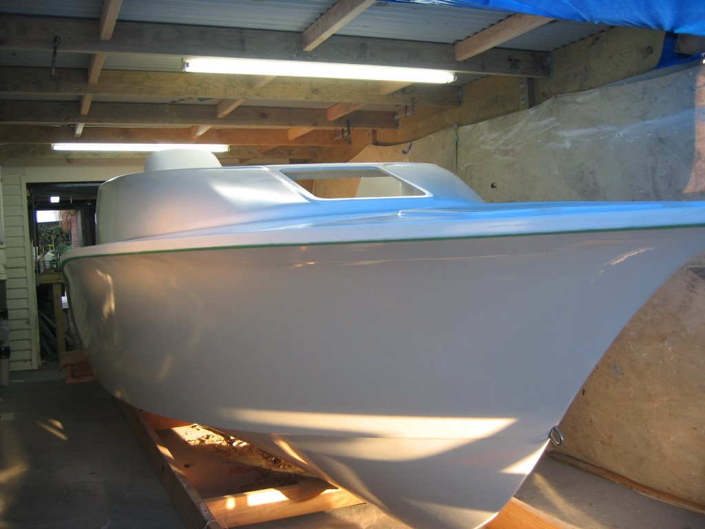

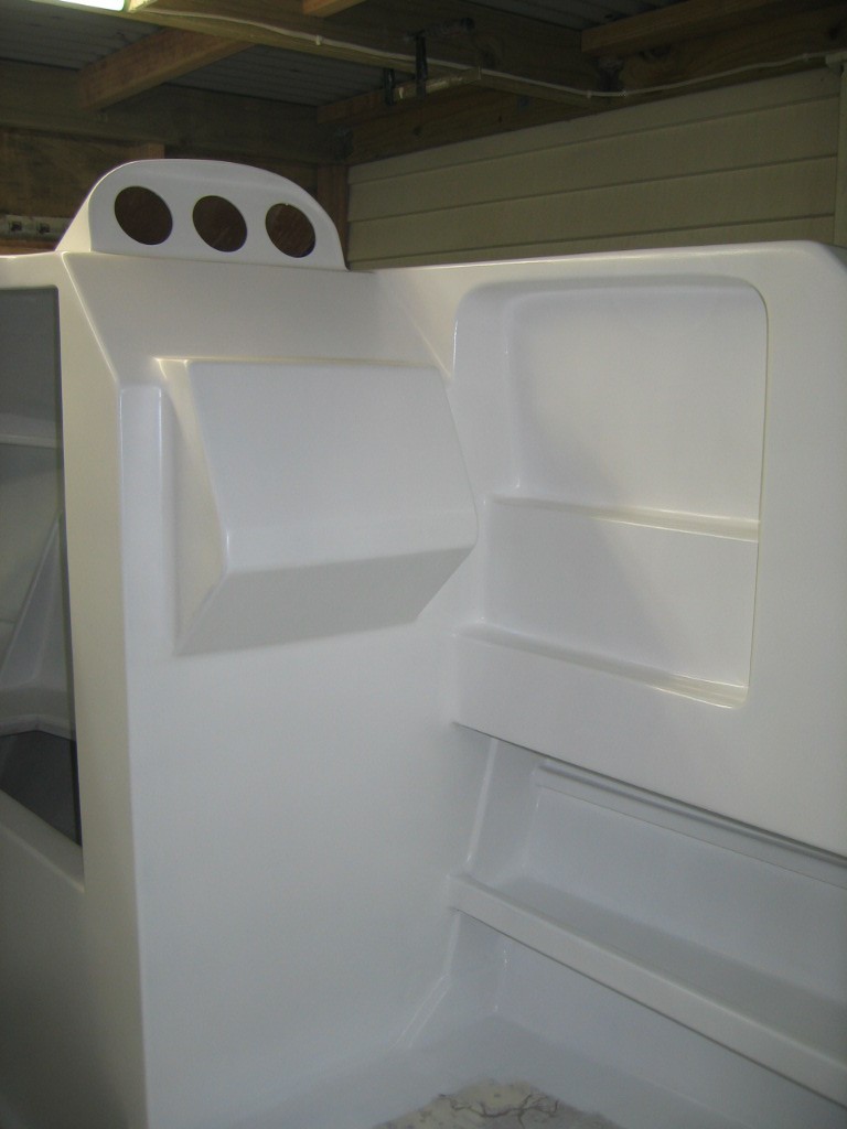

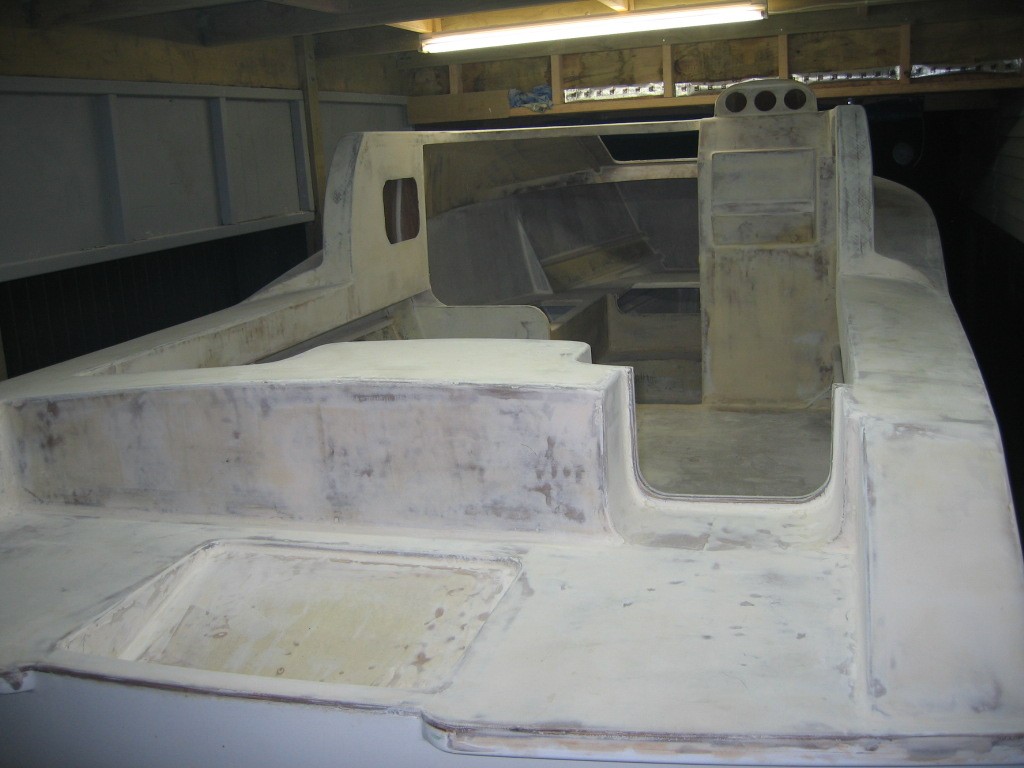

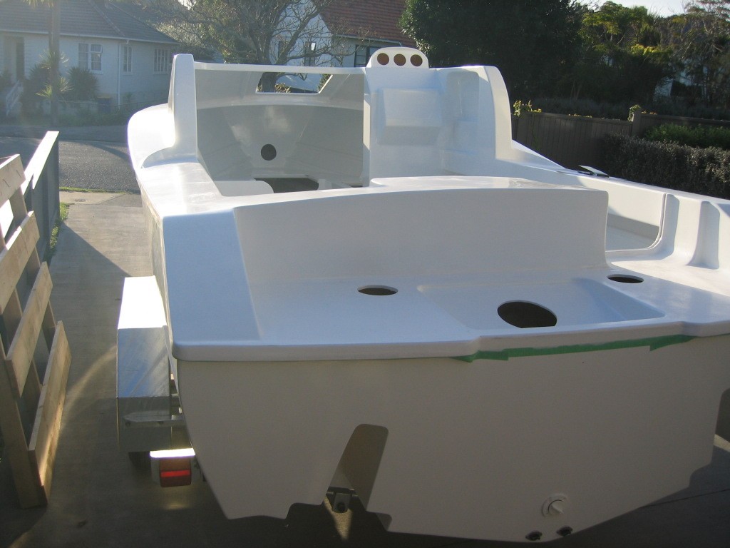

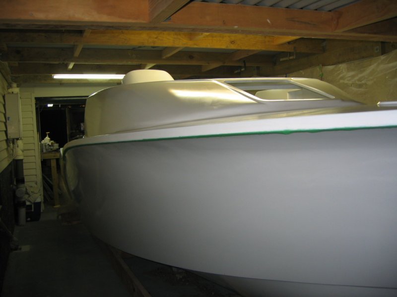

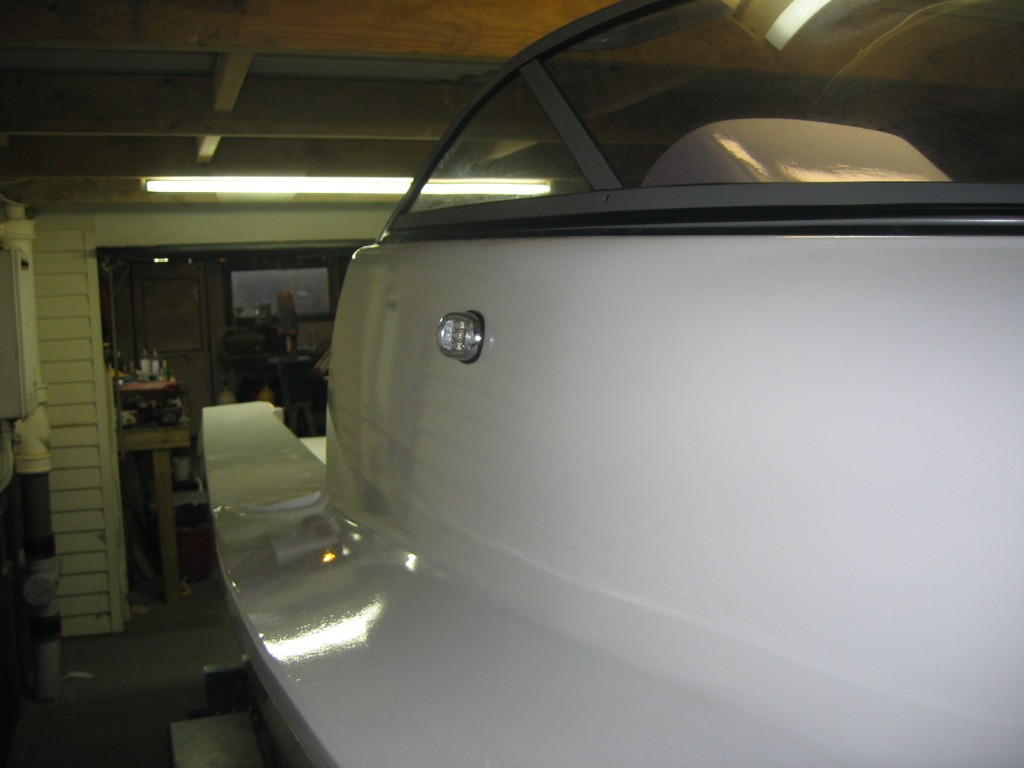

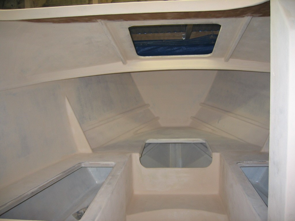

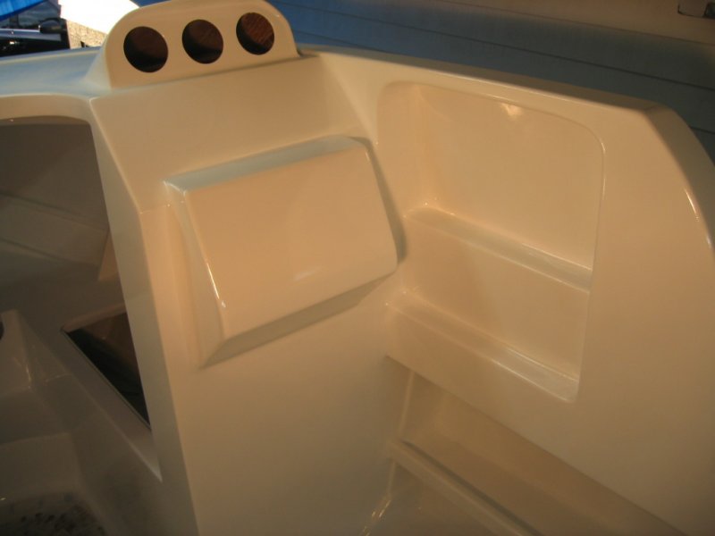

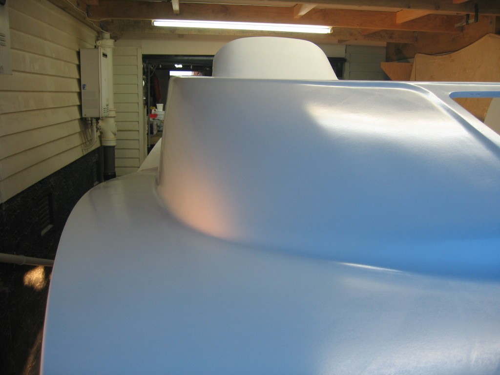

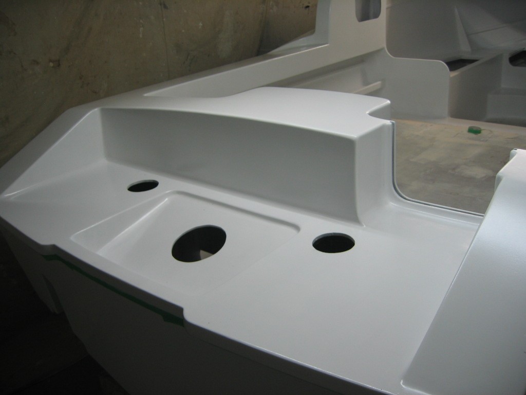

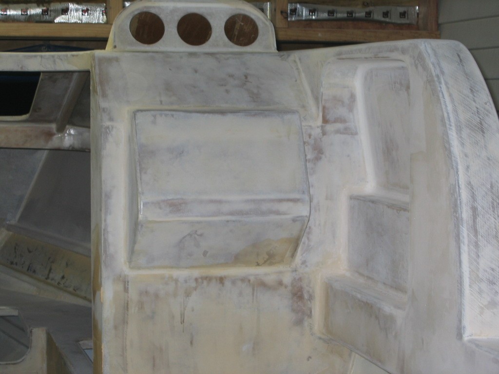

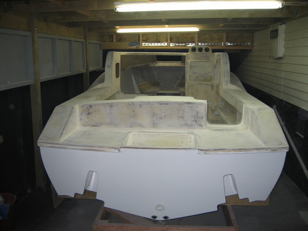

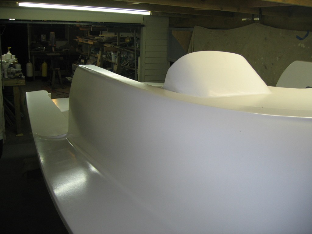

Just been sanding, sanding and more bloody sanding. Going pretty well though. Once glassing was finished and filled it was out with the west systems 411. This stuff sands down beautifully. Back half of the boat nearly complete. Cabin... both inside and out need more work. From here its coat the entire topside with resin mixed with white pigment to provide a barrier coat and colour base. Then high build primer, then undercoats. All this will be applied by hand.... carport is way to small to use spray equipment. Then the boat will be sent away to have the topsides professionally sprayed with finish coats. The surface area of the inside is way to vast to keep a wet edge when putting on top coats with roller.

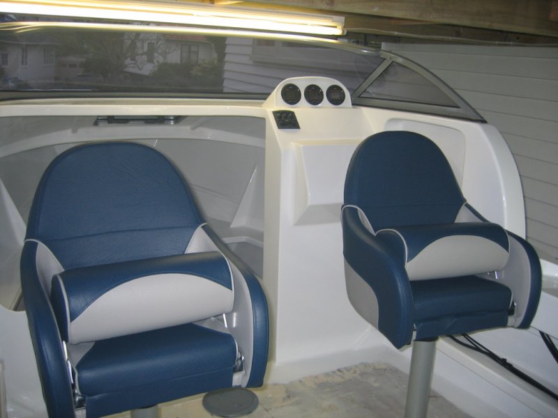

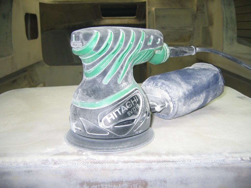

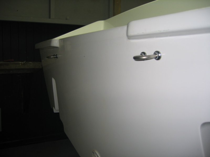

I put in a pic of my little Hitachi finishing sander..... if anyone out there is contemplating purchasing a new finish sander , this thing gets my vote. It absolutley rips. Plenty of power... quiet(ish). Great for tight spots but can still be used on large areas with great results... and the finish it brings up is superb. no swirl marks. I know there are alot of different brands of these things on the market... especially in the USA, you are spoilt for choice, The hitachi is really good value for money, over here its $100.00 cheaper than the competing Makita.... The makita has a tad more power though.........post-1597-0-89007700-1342432735_thumb.jpgpost-1597-0-48877100-1342432749_thumb.jpgpost-1597-0-78567500-1342432764_thumb.jpgpost-1597-0-13514200-1342432781_thumb.jpgpost-1597-0-32501100-1342432796_thumb.jpgpost-1597-0-14672200-1342432818_thumb.jpgpost-1597-0-38615400-1342432835_thumb.jpgpost-1597-0-43207100-1342432861_thumb.jpgpost-1597-0-33856400-1342432878_thumb.jpgpost-1597-0-54575000-1342432895_thumb.jpg

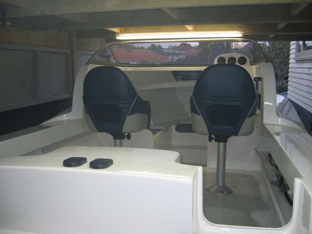

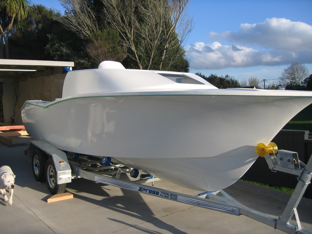

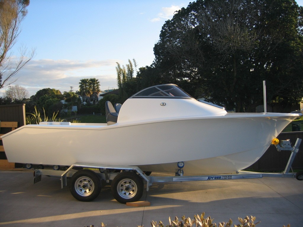

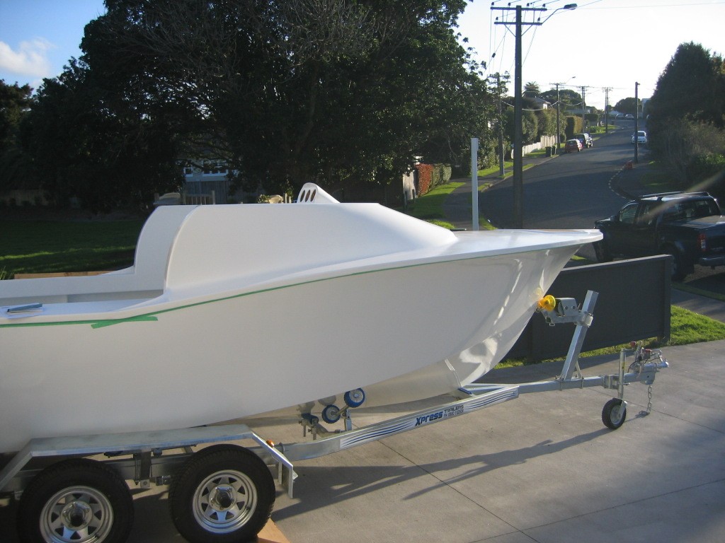

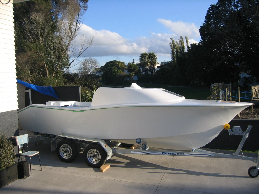

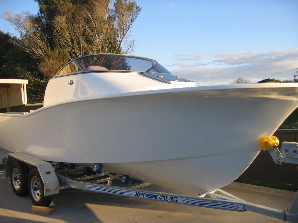

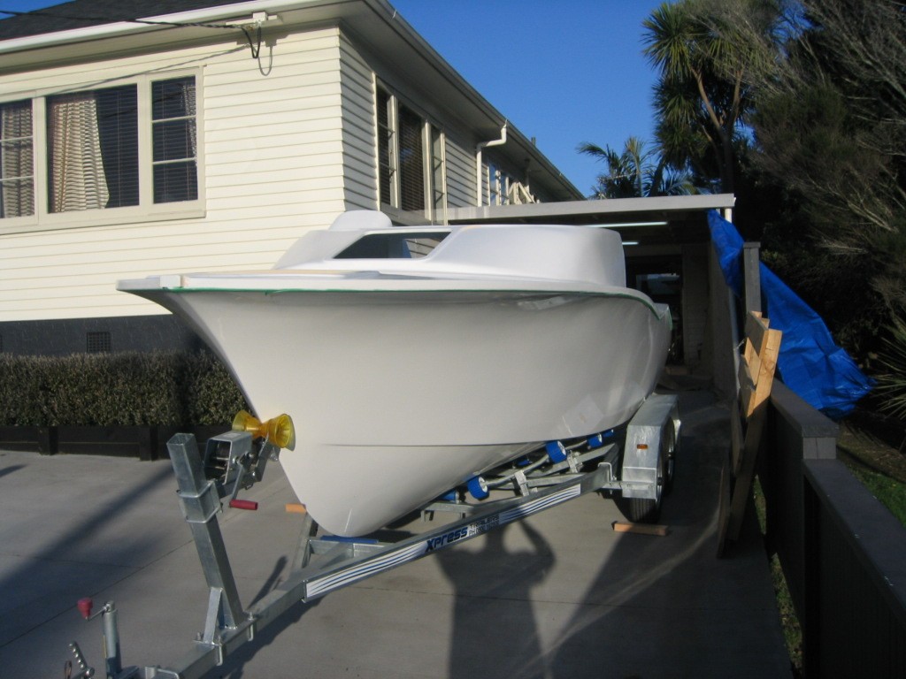

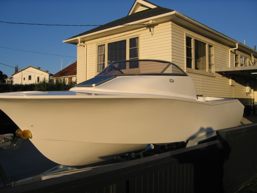

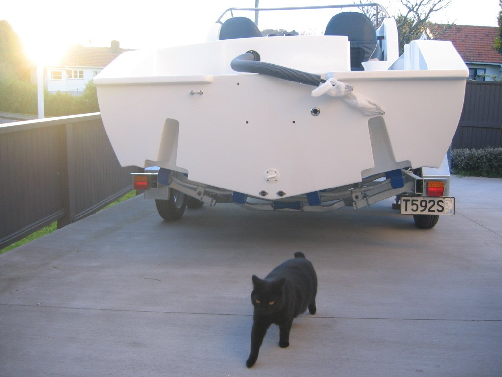

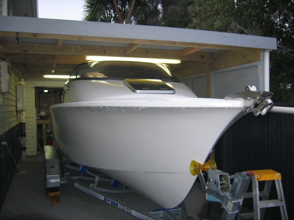

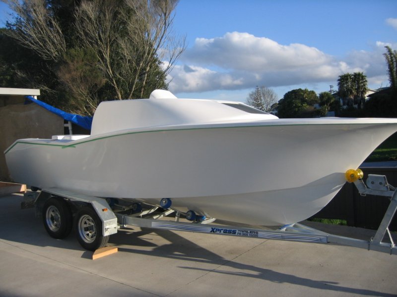

post-1597-0-22461900-1346056355_thumb.jpgpost-1597-0-89268000-1346056380_thumb.jpgpost-1597-0-25163700-1346056397_thumb.jpgpost-1597-0-93156700-1346056416_thumb.jpgpost-1597-0-53397800-1346056431_thumb.jpgpost-1597-0-66744500-1346056459_thumb.jpgHad trailer arrive today and winched boat out into a beautiful late winters afternoon. First time I have been able to step back and look at the thing side on for over a year. I was pretty happy.
Thankyou very much lads. Still have to finish the exterior paint on cabin and topsides etc, but shes nearly there. Also gonna change trailer mudguards to some nice rounded stainless items. Stock items only giving 30mm clearance either side of hull and they look a touch 'agracultural'.
Very nice and all your customisations look like they were designed original. She is definitely a beauty, also in a fairly short build time for a craft like this!! All in such a small shop, very impressive. :)

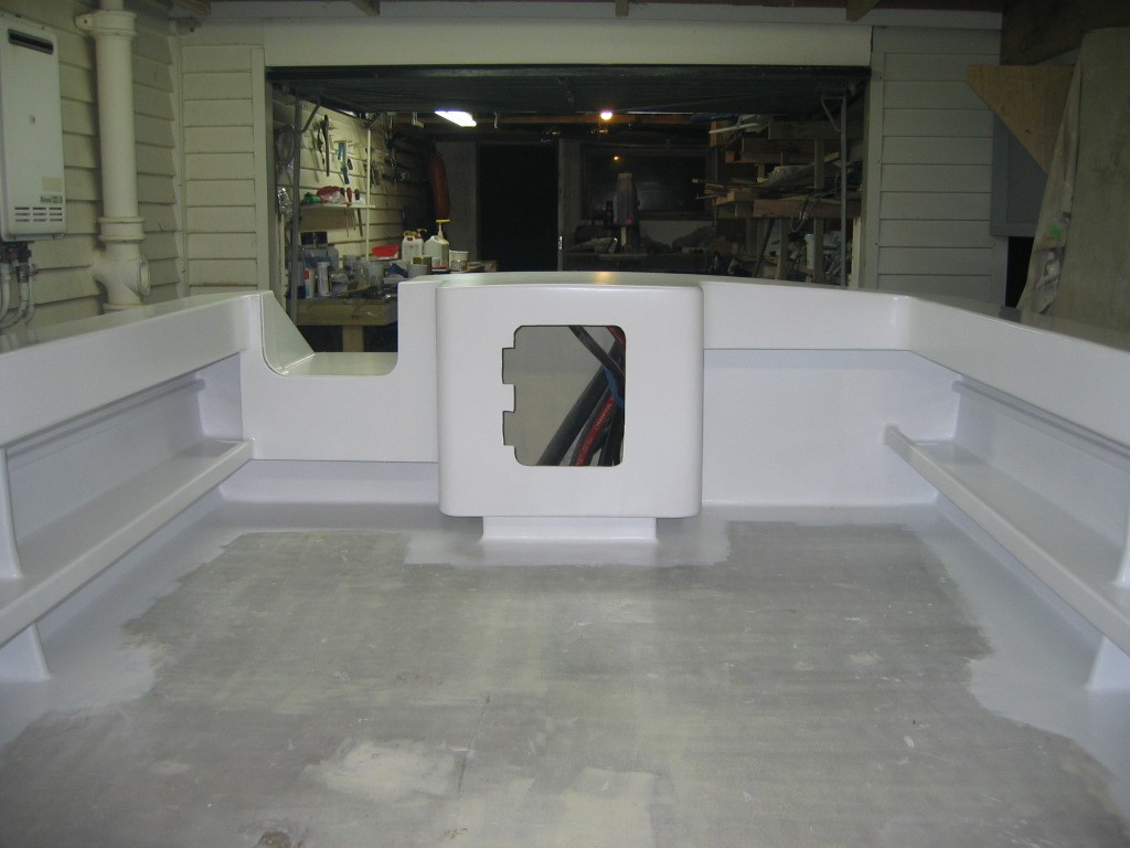

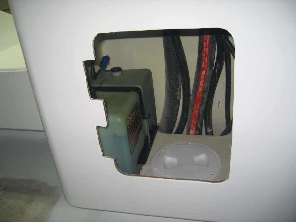

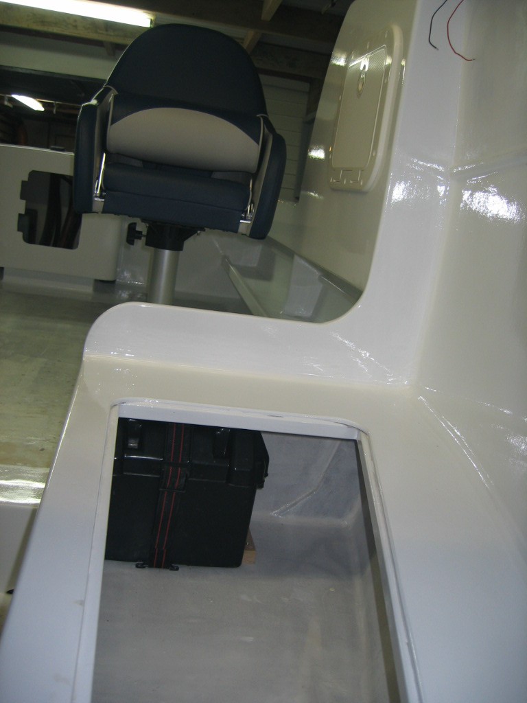

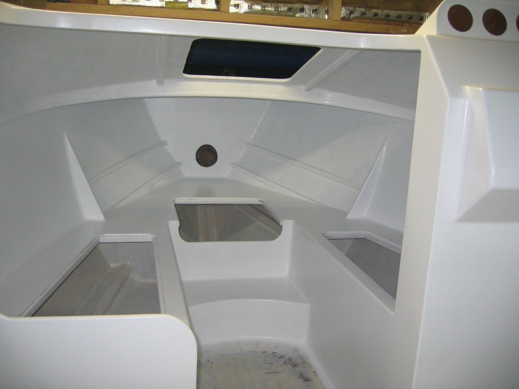

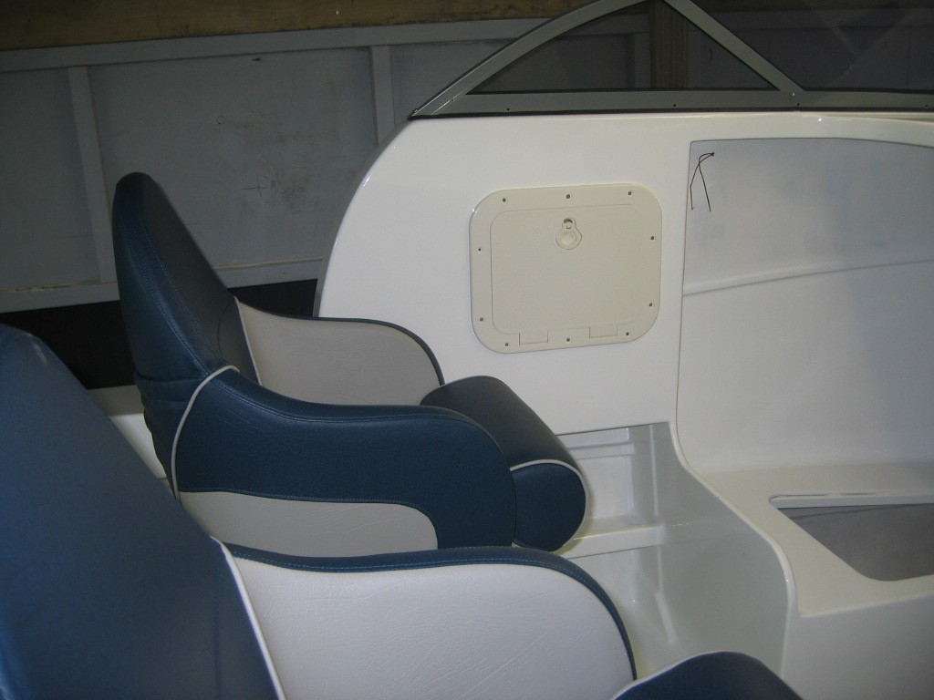

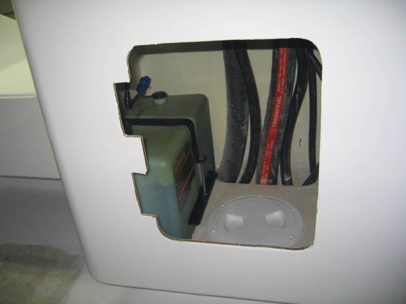

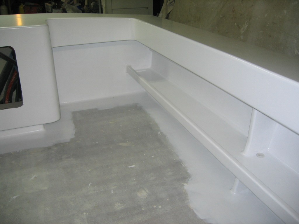

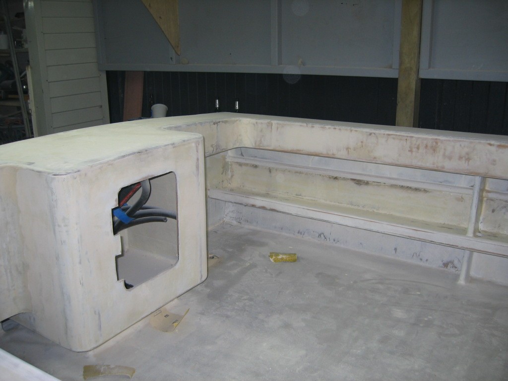

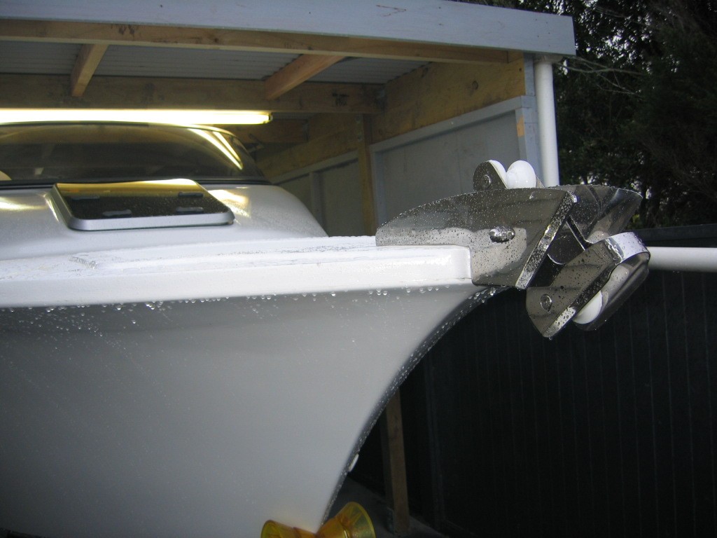

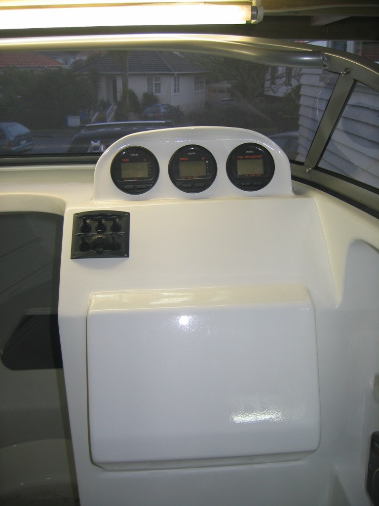

Yeah hokey, I think when it comes time to fitting keel strip keeping it simple is the best option. I looked at a 3m keelsheild but they cant be stuck onto boats that have rollers touching it. Latest pics. Trying to fit off as much as possible before boat goes off and has motor fitted. Seats will come back out so carpet can be fitted. Twin batterys go under cabin seats, not much room in transom locker plus didnt want all the weight in the stern. Anchor bollard will be fitted once I have anchor and chain to measure its exact position as bollard pin goes through chain link to secure it. (no windlas at this stage.) All in all things going pretty well. will get some decent pics as soon as the weather clears up and I can wheel her outside. Good ol kiwi springtime at the moment....sun, rain, wind, more rain, sun...........post-1597-0-76809600-1347181109_thumb.jpgpost-1597-0-76243900-1347181122_thumb.jpgpost-1597-0-18715600-1347181142_thumb.jpgpost-1597-0-36483000-1347181163_thumb.jpgpost-1597-0-34621500-1347181186_thumb.jpgpost-1597-0-33274500-1347181207_thumb.jpgpost-1597-0-56356500-1347181231_thumb.jpgpost-1597-0-31720500-1347181278_thumb.jpgpost-1597-0-95009600-1347181295_thumb.jpgpost-1597-0-81440500-1347181311_thumb.jpgpost-1597-0-48005200-1347181330_thumb.jpgpost-1597-0-78863900-1347181466_thumb.jpgpost-1597-0-58025500-1347181510_thumb.jpgpost-1597-0-54185500-1347181556_thumb.jpgpost-1597-0-60276400-1347181579_thumb.jpgpost-1597-0-33752500-1347181604_thumb.jpgpost-1597-0-52930700-1347181642_thumb.jpg

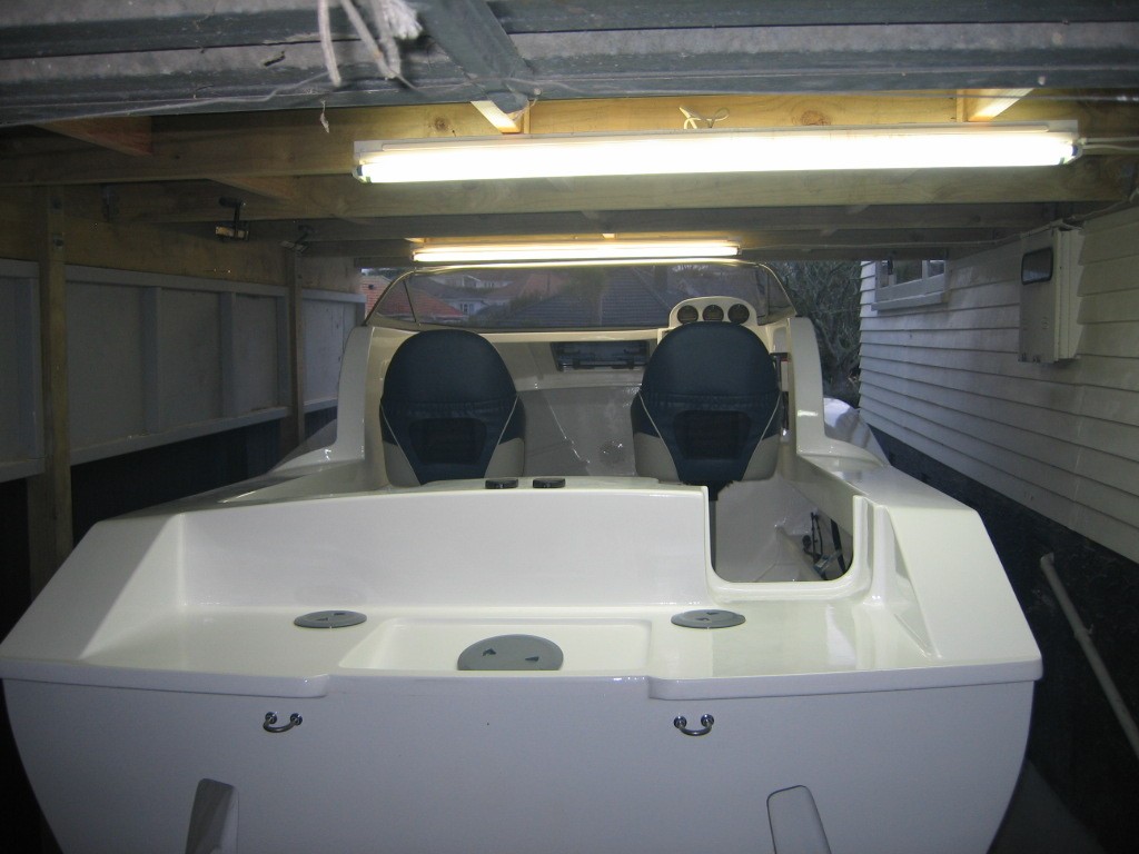

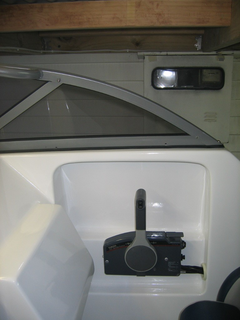

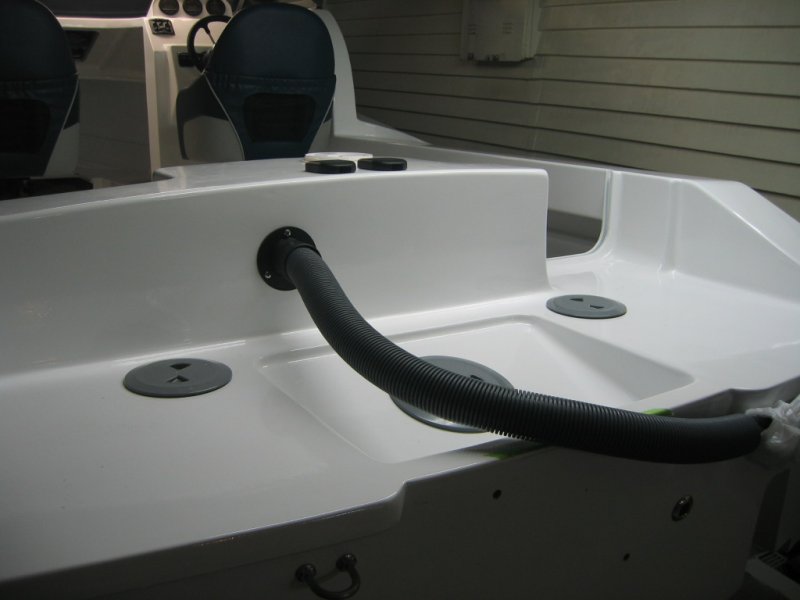

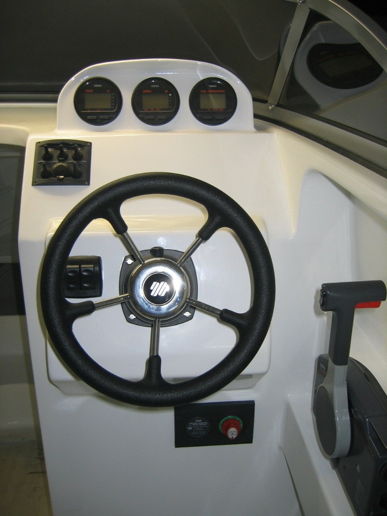

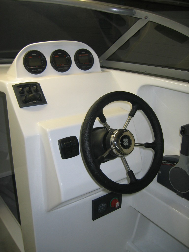

A bit more progress on helm. hydro steering , trim tab controls and battery vsr installed. who ever invented the multi-tool should receive a knighthood. Also fitted flexi-hose to take pipes and wires to engine.post-1597-0-63295600-1347529819_thumb.jpgpost-1597-0-00651700-1347529835_thumb.jpgpost-1597-0-09094000-1347529848_thumb.jpg
Managed to wheel her out out this afternoon. Next job is to fit stainless belting around the gunnels.... and get outboard fitted next week. Should be able to get some performance figures then. Have to fit trim tabs, fuel filter and tank-changeover tap in the transome locker aswell. Carpet will be done once shes been in the water and all set up. 6 rodholders , non-skid to be done in very near future too.post-1597-0-60729800-1347609632_thumb.jpgpost-1597-0-85807300-1347609654_thumb.jpgpost-1597-0-35635400-1347609678_thumb.jpgpost-1597-0-61068100-1347609704_thumb.jpg
