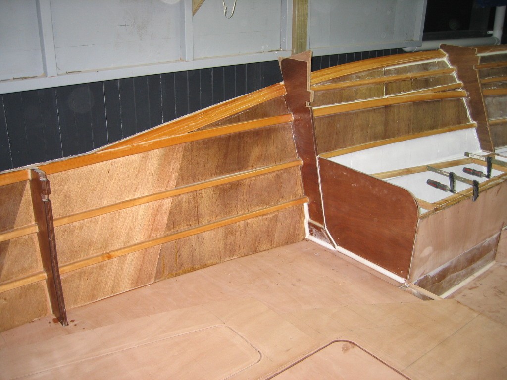

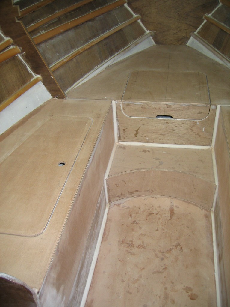

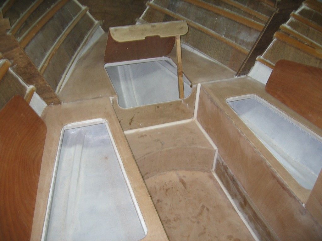

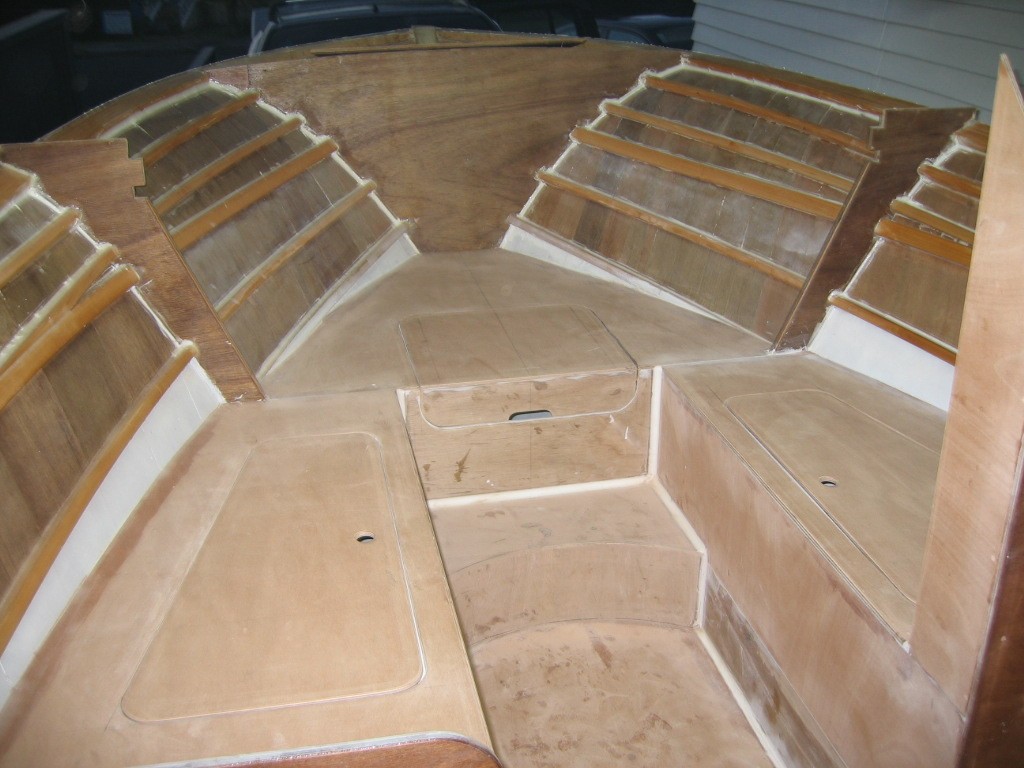

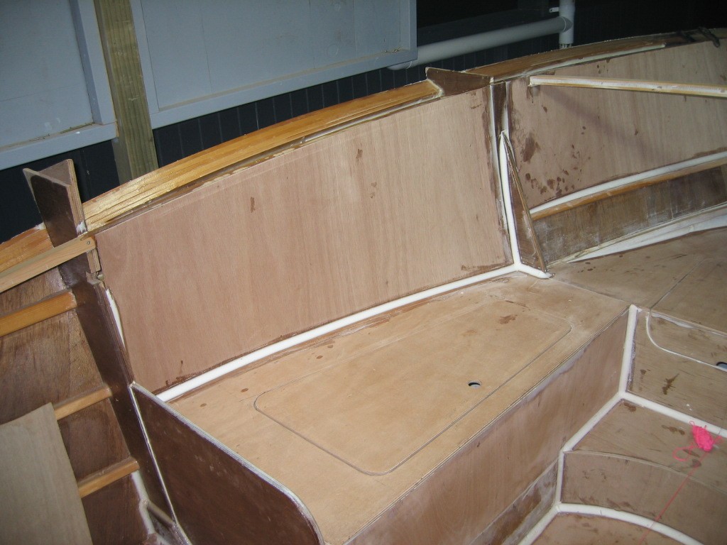

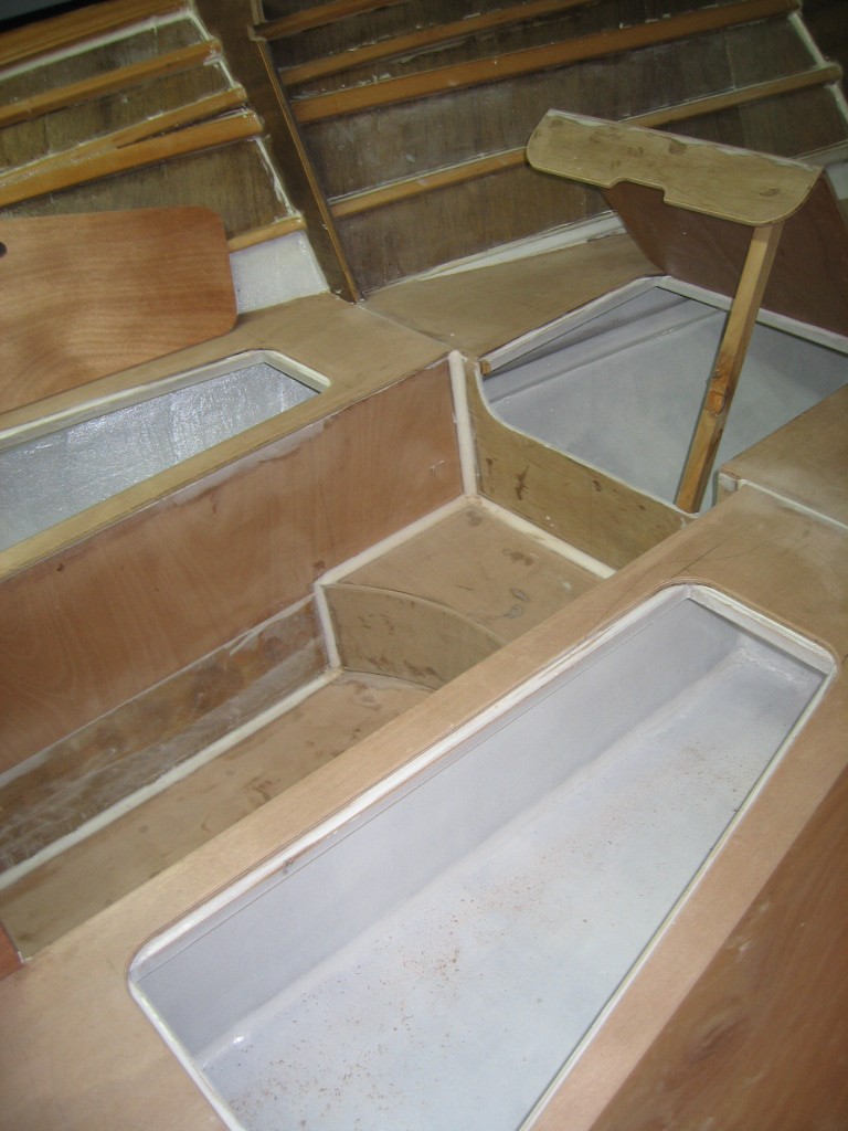

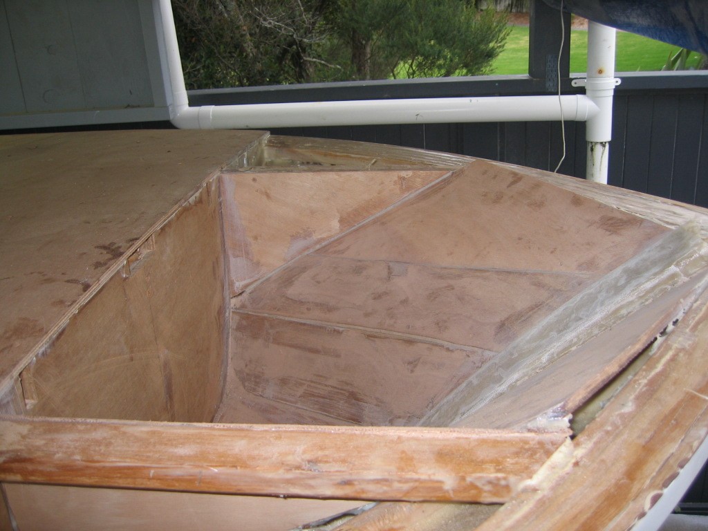

nzlance Posted January 29, 2012 Author Report Share Posted January 29, 2012 Some picks of forward bunks and toilet area. The panels to go on top are pre-cut, routered and hot coated on the underside ready to go. Quote Link to comment Share on other sites More sharing options...

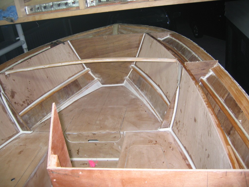

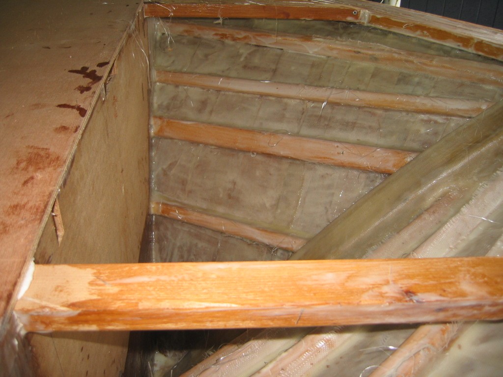

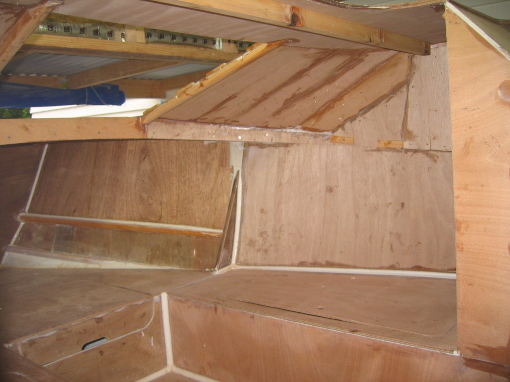

nzlance Posted January 29, 2012 Author Report Share Posted January 29, 2012 The storage areas have been glassed then have rolled on a couple coats of pigmented resin. Keeping the inside of the hull clean during the planking stage has really payed dividens. The cabin section is going to be sheathed in 4mm ply for a nice clean look but the cockpit sides will be exposed apart from gunnel tops and storage shelves. Quote Link to comment Share on other sites More sharing options...

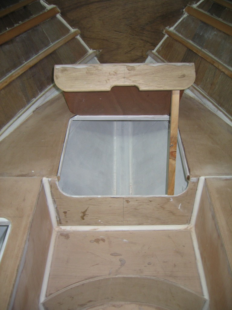

nzlance Posted January 31, 2012 Author Report Share Posted January 31, 2012 Lids glued down and ready for hot coating.The footwell will be sheathed with glass up to the top of the bunks. From here I will begin forming the forward gunnels so the cabin structure can begin to take shape. Lids glued down and ready for hot coating.The footwell will be sheathed with glass up to the top of the bunks. From here I will begin forming the forward gunnels so the cabin structure can begin to take shape. Quote Link to comment Share on other sites More sharing options...

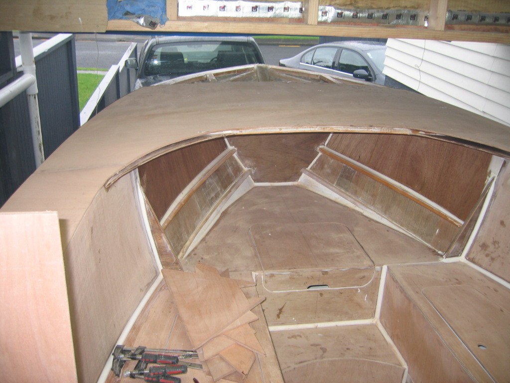

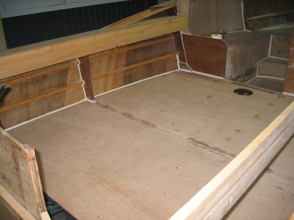

nzlance Posted February 16, 2012 Author Report Share Posted February 16, 2012 Cheers David. A couple of pics with interior lined. 1 Quote Link to comment Share on other sites More sharing options...

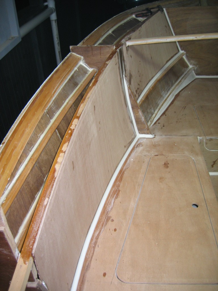

Skott Posted February 21, 2012 Report Share Posted February 21, 2012 What is the white fillet material you used in the last couple of pictures? It is not the same as the fillets attaching the stringers and frames to the outside planking? correct?? Quote Link to comment Share on other sites More sharing options...
nzlance Posted March 3, 2012 Author Report Share Posted March 3, 2012 Hey thankyou Scott pretty happy with things so far. Sorry for long delay in reply but been away for a bit.....in USA of all places, now back and looking forward to getting going again. Had plenty of time with a sketch pad to nut out a few design details..... cabin shape, transom lockers, side storage shelves etc. Hopefully all the grand ideas will be put into practice. And yes Skott the filleting in the cabin is the same as the planking. West Systems with 411. I ground down the end of a putty knife to a nice even radius to make the big fillets on the interior. Works a treat. Quote Link to comment Share on other sites More sharing options...

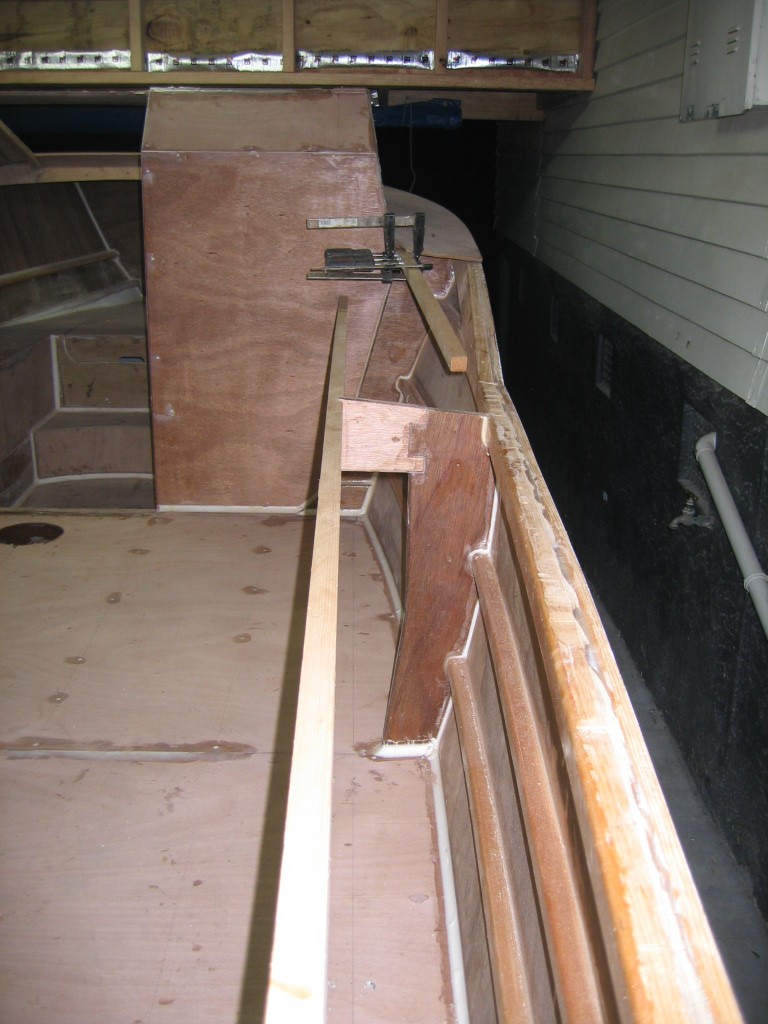

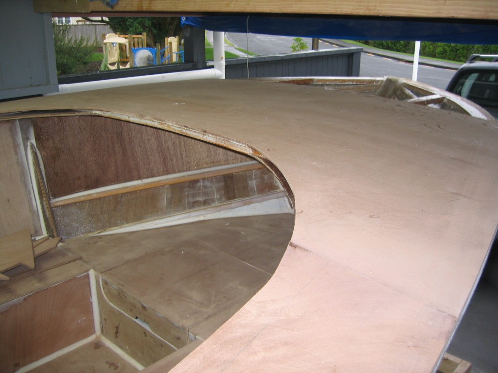

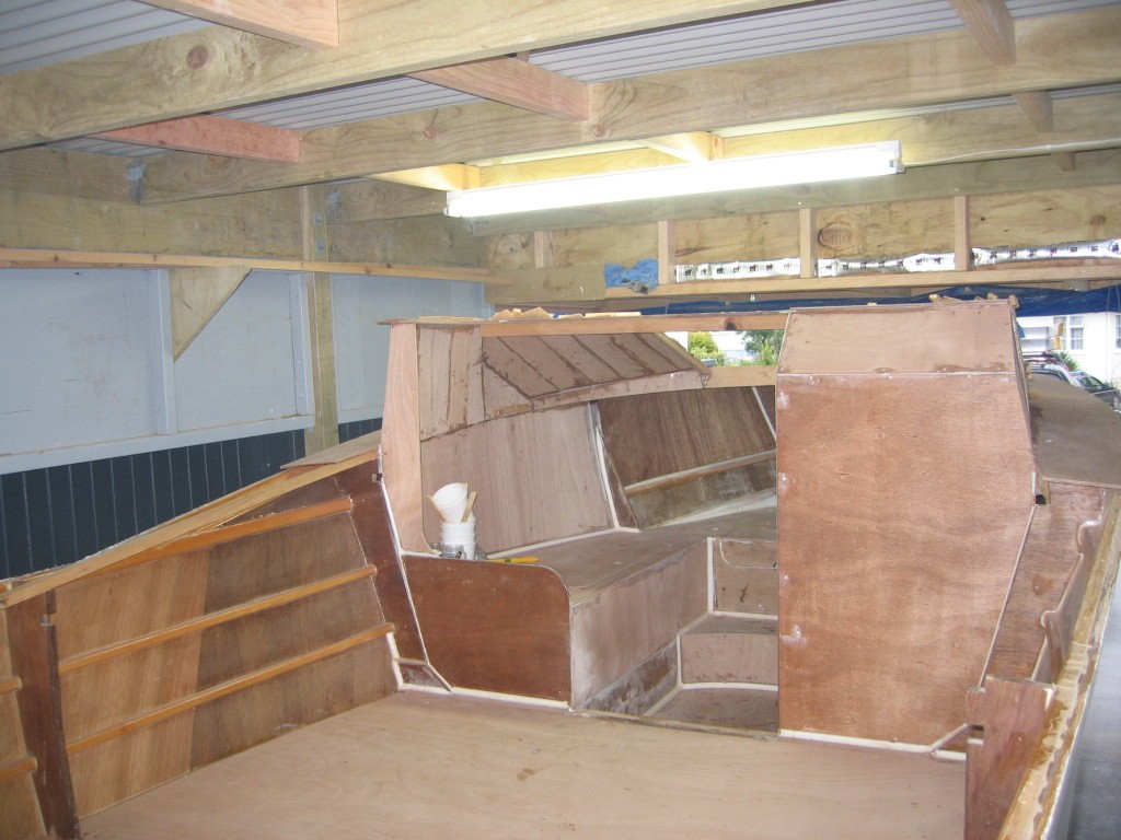

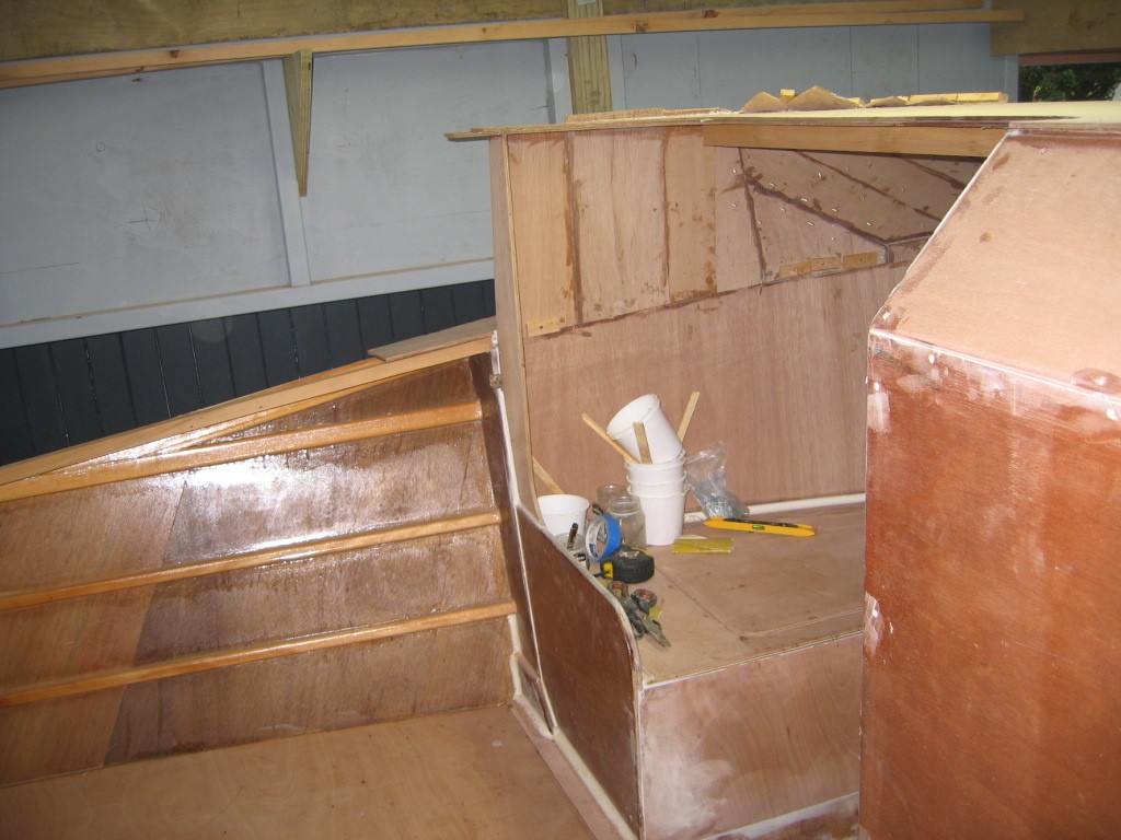

nzlance Posted March 11, 2012 Author Report Share Posted March 11, 2012 Starting to form the cabin structure. Will have to get a windscreen built from a production boat so I can get the curve of the cabin top to match bottom of the screen. Also heavily glassed the inside of the anchor well. This will be lined with 9mm ply and glassed again on the inside to protect the timber from the chain and to provide overall strength to this part of the hull. A stainless u-bolt will be drilled through the stem before the well is formed. Quote Link to comment Share on other sites More sharing options...

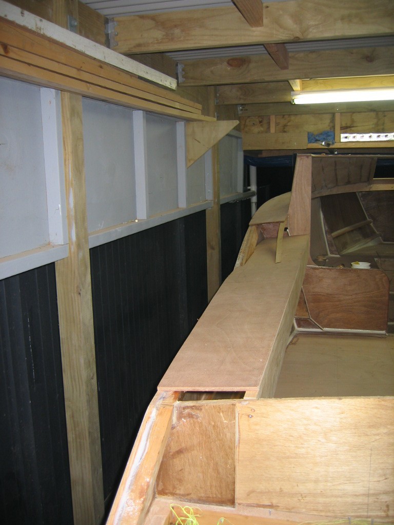

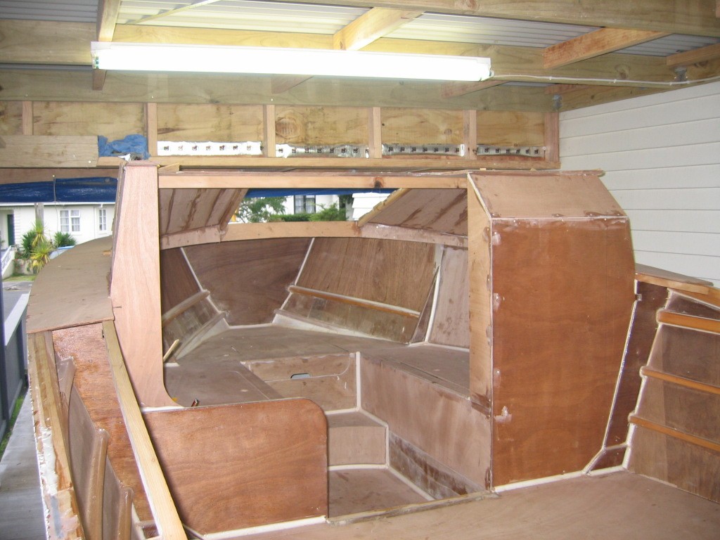

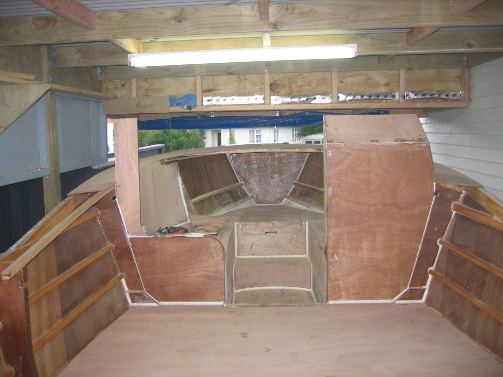

nzlance Posted March 18, 2012 Author Report Share Posted March 18, 2012 Started the cabin struture. Will be fitting a windscreen from a production boat as getting something custom built will cost around 3 times more. Quote Link to comment Share on other sites More sharing options...
nzlance Posted March 18, 2012 Author Report Share Posted March 18, 2012 A couple more. Quote Link to comment Share on other sites More sharing options...
hargrave Posted March 18, 2012 Report Share Posted March 18, 2012 It sure looks great, Lance! I've got to wonder though, what all of that structure is going to weigh. Our fearless designer is known for the efficiency of his designs, partly because he keeps structure light. I wonder if your boat won't be pushed down a bit on her lines. However, she sure looks beautiful, and if you can keep it balanced, I'm sure she will perform well. Quote Link to comment Share on other sites More sharing options...
nzlance Posted March 18, 2012 Author Report Share Posted March 18, 2012 Yes hargrave adding the cabin structure has deffinatly added weight and it is my biggest concern. I have tryed my best to keep cabin seats and cabin itself as simple (therefore lite) as possible. But you have to remember it wont have the stainless steel canopy structure - although the cabin and windscreen will weigh more than a cc helm. Keeping the boats lines is also a very big issue......... I have spent days trying to get the shapes and proportions right. You cant just go express style because there is not enough hight in the bow area so a cabin has to be added, meaning you need a hatch..... within a certain distance of the anchor well so the anchor can be retrieved without having to climb out on the bow. The windscreen is a curved wrap around item that will match the curve of the cabin and the length of the side wings. Keeping the whole thing balanced is my no.1 priority. Quote Link to comment Share on other sites More sharing options...

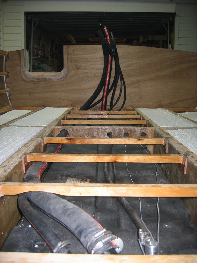

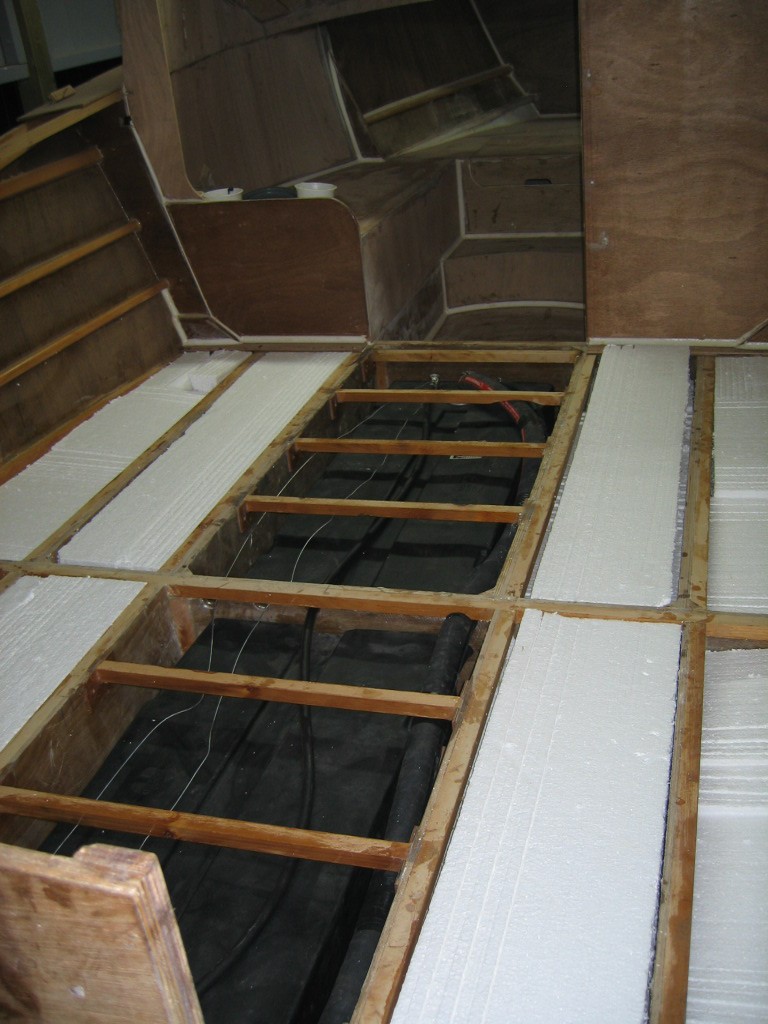

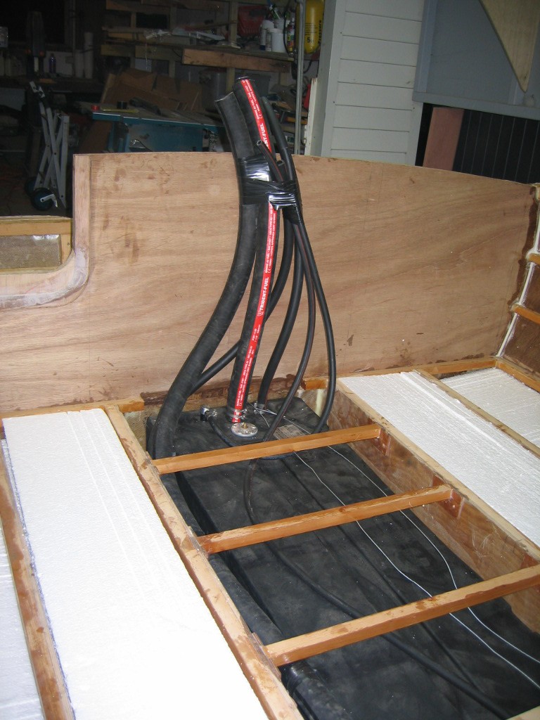

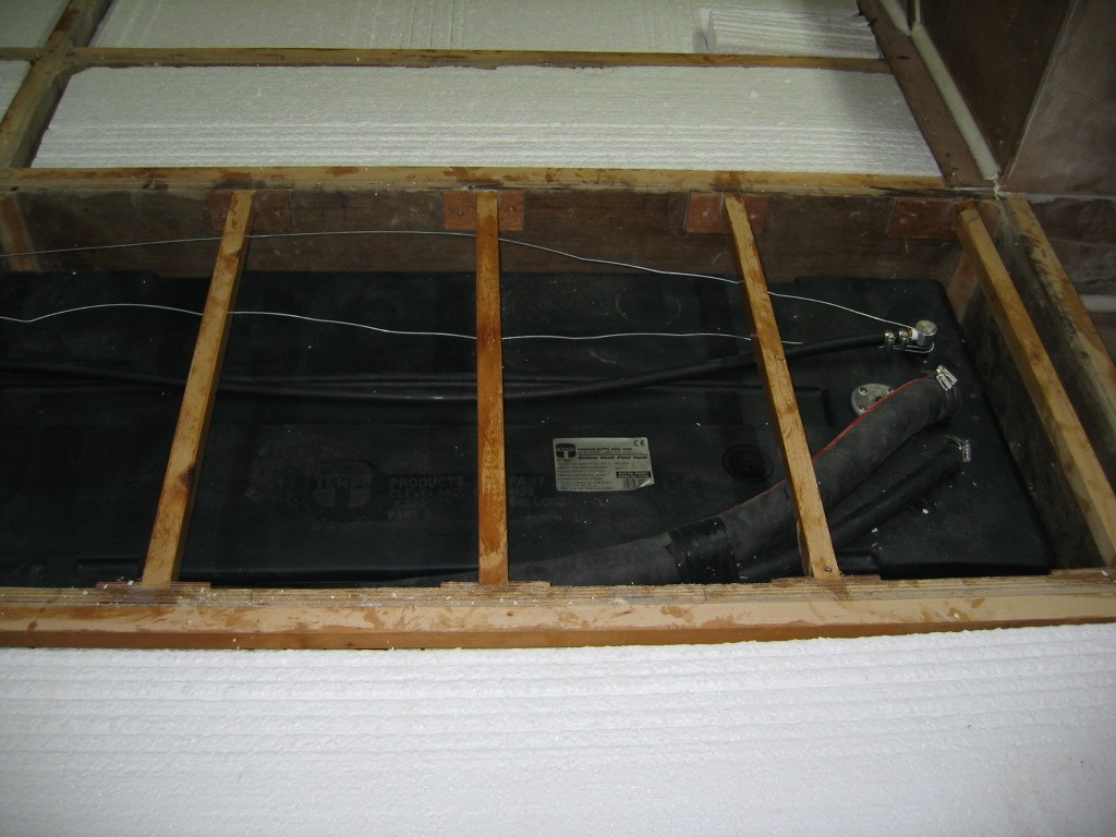

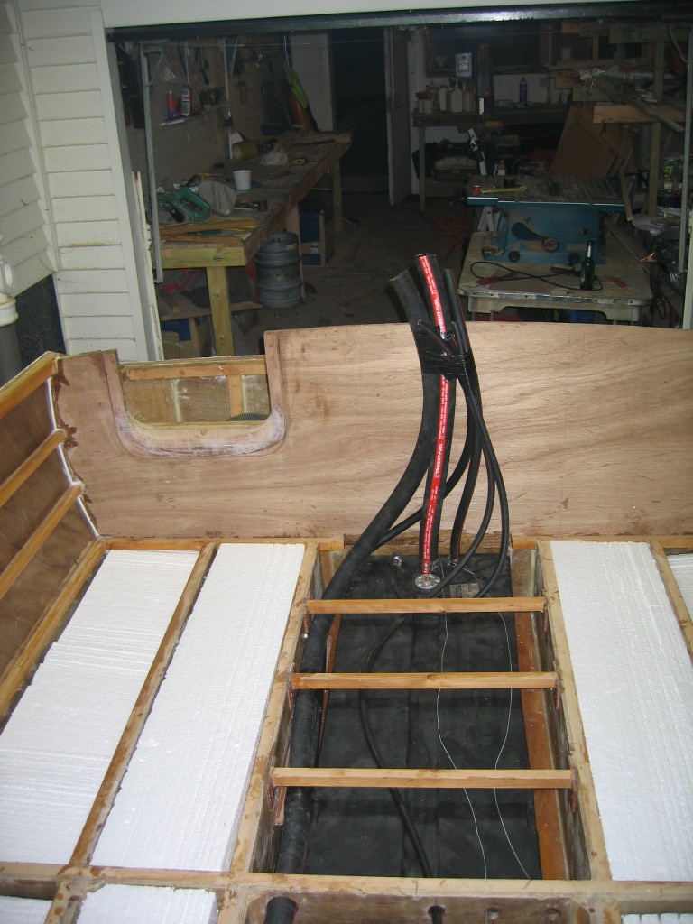

nzlance Posted March 27, 2012 Author Report Share Posted March 27, 2012 Installed fuel tanks, 2 x 25 gallon tempo plastic items. Things took a little longer as the front tank had to be sent to a plastic welder to have the fuel inlet and breather pipe bent over 90 degrees to give the fuel inlet pipe clearance under the floor. Things are still pretty tight but should be ok. The plywood around the tanks has been fully fibre glassed and while I was at it I added another layer of 10 oz double bias to the entire chine area ..... this is 3 layers on the inside now, I know it adds weight but I dont want this join to crack as the chines are quite wide towards the stern and there is no chine log to support the area where the bottom of hull meets the sides. In other words this part of the boat receives a hiding. polystyrine flotation was added to all the compartments (not around fuel tanks though) and was held up off the bottom of hull to allow any moisture to track back via limber holes to bilge. The fuel tanks themselves have been cleated into position .... front , back and sides. Sika adhesive was used on bottom of tank to bed it into position. Cleats still have to be added to hold the tank down before the floor is to be glued down. The 2 grey wires you see beside fuel pipes are draw wires for the fuel gauge senders. The boat will be sent to a marine electrician for wiring out, the last thing I want is a botched wire job right on top of 200 litres of gas. Quote Link to comment Share on other sites More sharing options...

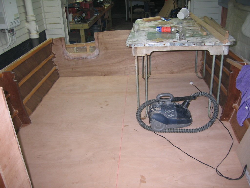

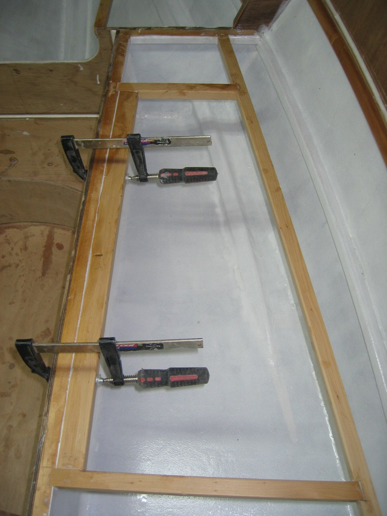

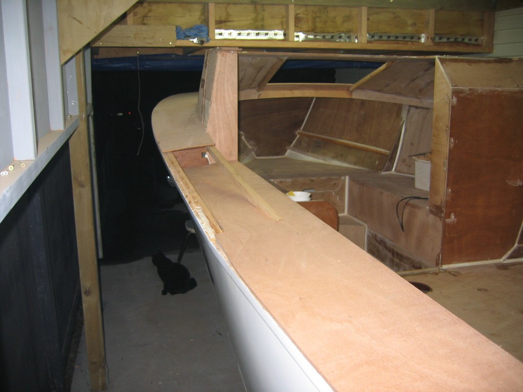

nzlance Posted April 1, 2012 Author Report Share Posted April 1, 2012 Floor glued down, started to form gunnels. Quote Link to comment Share on other sites More sharing options...
