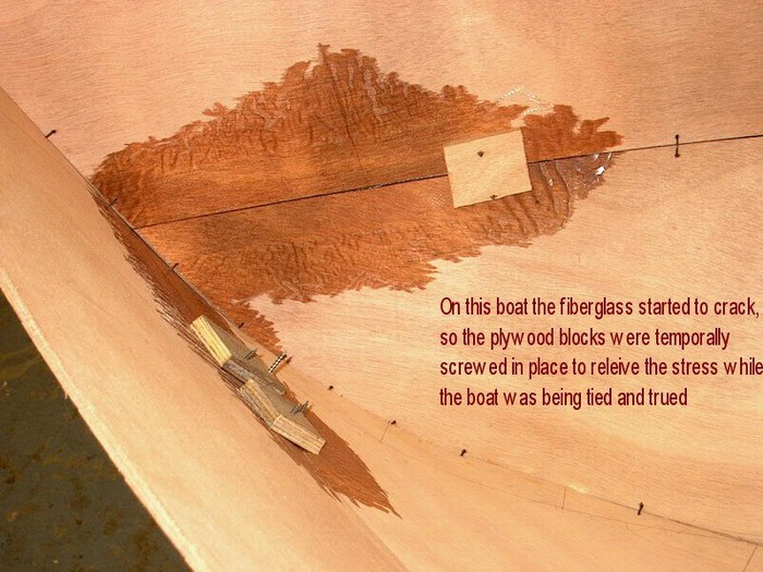

A picture would help. The best thing about this sort of construction is that anything can be fixed with a little sawdust and a bit of goo.
A trick I read about somewhere on this forum (I think) was to screw a small block of plywood (maybe 3" x 3") across the butt joint at the aft end of the joint, as in away from the stem and toward the stern.
That worked when I broke mine. It's a heartbreaking sound when it breaks, isn't it? I screwed two blocks together like a clamp across the back end of the butterfly and removed the "clamp" after everything was pulled into shape and the joints were cured.
I always use two or more layers of glass on the butterfly inside and out. Also make sure they are long enough. You can after the epoxy has cured go back and add wires tightened down Say every inch of the glass,at the area that's giving you trouble. That should allow you to open her up. You are going to see some discoloring in the glass as its stressed where the epoxy and glass are trying to give up. But unless your being very rough on it she should hold. Also get two friends to hold the hull sides up as you wire down the chine. The wood block only really helps if you have a long floppy hull panel.
Scott
I used 2 layers on the outside when I did my Spindrift. It is the outside that gets the most load when shaping the hull during the stitching phase. But I think in your case my36 I would also use a "clamp" as others have described. You have already had more than your share of trouble here.
Newbie,
I hate to hear this. There are several possibilities as to what went wrong. First is the plys, some plys bend better than others. We started having some Spindrift bows break in my boat building class but when I folded the same ply at my shop it worked fine. I concluded that the controlled environment inside the community college was drying the ply and making it stiffer to bend. We started soaking the bow area inside and out with hot wet rags just before folding and have not broken any more.
There is a lot of peel stress on the aft edge of the glass tape during the folding operation. It is important to screw the blocks mentioned in the plan. I have not had any failures when using the blocks. What happens is the zipper effect, the aft edge of the tape is highly loaded and it lets go which moves the stress along until it fails which moves the stress along etc..
