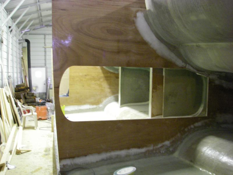

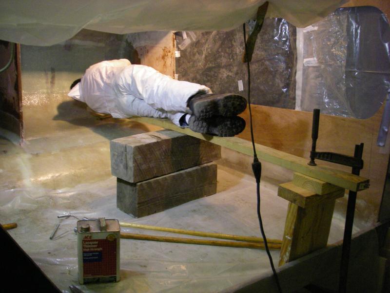

Alan Stewart Posted January 27, 2011 Report Share Posted January 27, 2011 Alan here with another update on the power cat. We have been battling the bitter cold on a daily basis here at the shop but still making strong progress. Since the last update, we have glassed the outside surface of the starboard hull, sanded it, installed the bulkheads that will define the fuel and water tanks, layed-up and cut out the baffles for the tanks and finalized the position of the engine. Once this was done, we wasted no time in setting the boat back upright and then rotating it down the other way to facilitate glassing the inner surfaces. Rotating the hull has become old hat at this point and due to the careful positioning of the center of rotation we were able to lift the hull upright and lower it down again without the help of any come along's or ratcheting devices! Here the hull is down on the other side. Here is a view of the interior looking aft. Yesterday we glassed the inside of the fuel and water tanks. Working on a one off boat in a relatively small shop requires constant improvisation. We make a lot of tools and come up with new ways of doing things to make large jobs easier. Below is one such improv device we nicknamed "the diving board" which allowed us to reach the back of the tank with rollers when the roller on a stick just couldn't cut the mustard. More to come. Thanks for watching. Quote Link to comment Share on other sites More sharing options...

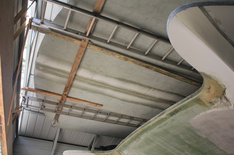

Alan Stewart Posted February 4, 2011 Report Share Posted February 4, 2011 Today the crew at B and B moved the now glassed starboard hull out of the shop so that the port hull can be caught up. Once the port hull is complete both hulls will be mated and finished inside the shed. Notice that the hull is still light enough to be moved around by hand. The four of us (with the help of Mandy, the boatyard dog) could easily slide the hull around the shop. Quote Link to comment Share on other sites More sharing options...

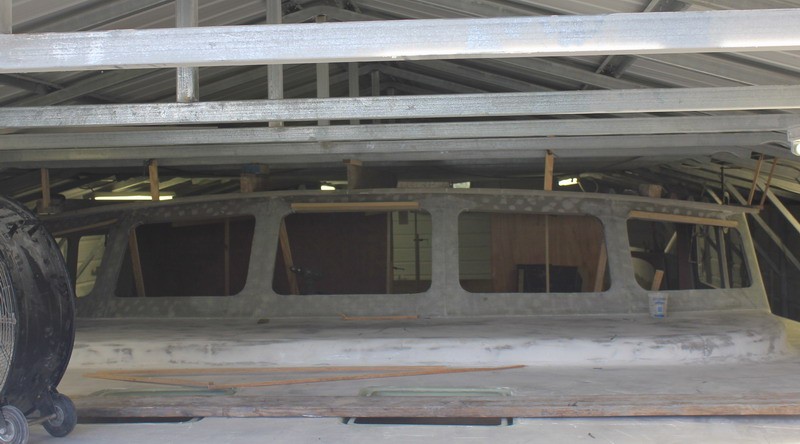

Designer Posted April 24, 2012 Author Report Share Posted April 24, 2012 The project goes on and on. Here is a recent picture showing Alan working on the pilot house front. We will soon out-grow the building. Quote Link to comment Share on other sites More sharing options...

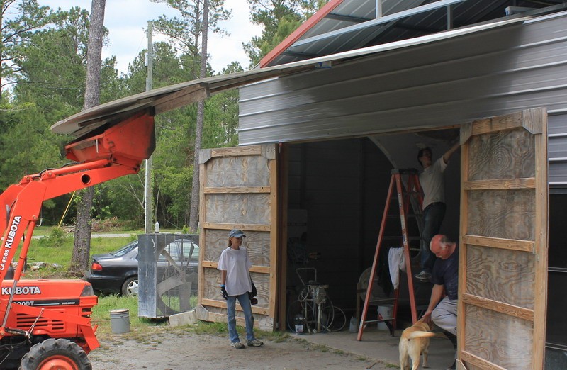

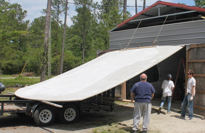

Designer Posted April 26, 2012 Author Report Share Posted April 26, 2012 Randy is right about the difficulty of getting back far enough to get a good shot, but I agree with Gordy that I could do a little better. So here is todays challenge. The pilot house top measures 19' x 16'2" and weighs 450# and had to be put in place. In the best tradition of B&B and a generous helping of Rube Goldberg it is now glued in place. Quote Link to comment Share on other sites More sharing options...
PeterP Posted April 26, 2012 Report Share Posted April 26, 2012 If I didn't know any better I'd say this is your classic government job. One guy driving a tractor, one guy scratching a dog and three others hanging around waiting for lunch. Quote Link to comment Share on other sites More sharing options...
Tom Lathrop Posted April 26, 2012 Report Share Posted April 26, 2012 If I didn't know any better I'd say this is your classic government job. One guy driving a tractor, one guy scratching a dog and three others hanging around waiting for lunch. Agreed Peter, but Mandy, being female, has her needs and must be scratched regardless of other necessary activities. Quote Link to comment Share on other sites More sharing options...
Charlie Jones Posted April 27, 2012 Report Share Posted April 27, 2012 and besides, Mandy is THE boss!! Quote Link to comment Share on other sites More sharing options...
PeterP Posted April 27, 2012 Report Share Posted April 27, 2012 I don't know about Boss. The Nose more likely. She can tell a guy with a sandwich from a mile away. Quote Link to comment Share on other sites More sharing options...
