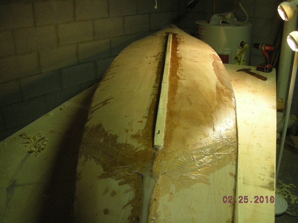

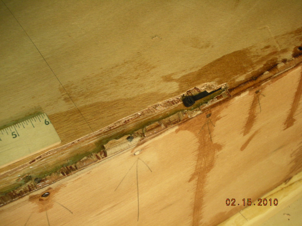

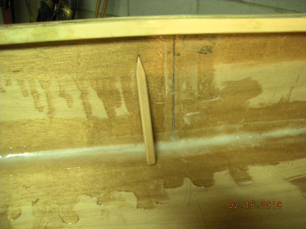

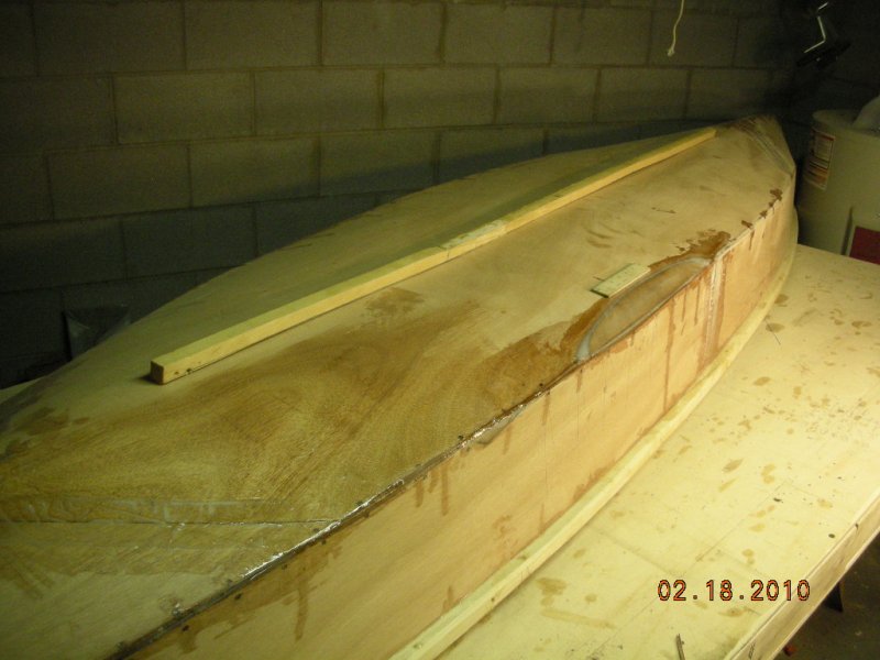

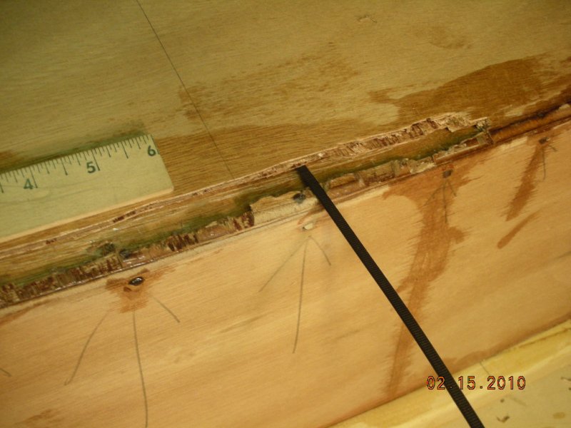

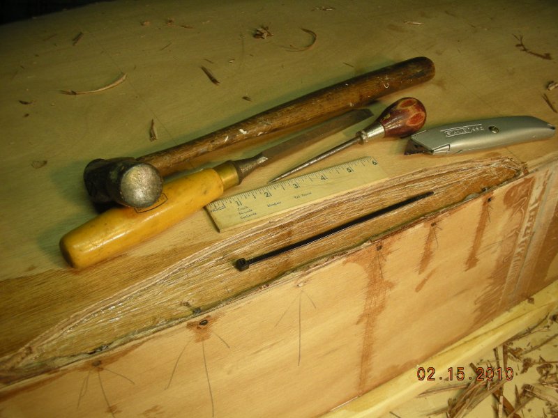

Wow, here are some interesting pictures of a cavity I discovered between the bottom and the doubler.  I found it because I could not get one of the plastic tie holes to fill in with epoxy.  As I probe around the hole a little it seemed to continue beyond the hole itself between the bottom and doubler.  I used a chisel to open up the bottom and it just continued and continued.  By the time I got to some hardened epoxy between the doubler and the bottom, I had excavated a cavity 18 inches long and 1.5 inches at its widest point!
I am glad I found it.  I don't think I had enough epoxy, nor thick enough epoxy between the doubler and the bottom when I glued that down.  I think the thin epoxy may have flowed back towards the low points and thus left the cavity on the higher side.  The inside is filleted and taped.
I will mix up some thick epoxy and use that to fill it in here and then tape over that.  I wonder if I should not cut a piece of the 4 mm plywood to the shape of the excavated cavity and piece it in.  That actually seems to be better than simply filling the whole cavity with epoxy.
Here are some of the photos.  This one shows the initial excavation to the left of the cavity.post-0-129497639507_thumb.jpg

You're on the right track filling the void(s) w/ plywood and lots of thickened epoxy.  You may find some more along the doubler when you round over the outside of the chine before you tape it.
The patches look good.  Now fair and tape the outside of the chine.
