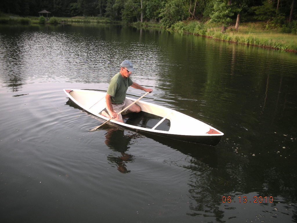

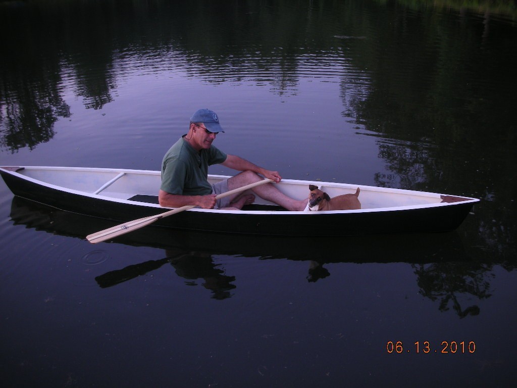

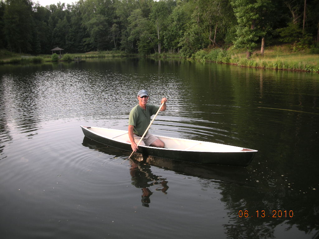

  8. I will be using the canoe down a river that runs along my farm. I will be kneeling and jumping in and out over sandbars etc. I like the canoe paddle as I think it will work best. I spent several teen-aged summers at canoe camps and this canoe brings back good memories. Yes, I think the stern thwart is to far to the stern to be a leaner. Thank you John for your support and ideas throughout this project.

  10. Yes, trying it out without a seat in place is coming to me as the best way to proceed. That is exciting as I will get to put my boat in the water all the sooner. I agree with you and understand the importance of keeping my weight low. With a seat I will be able to move my weight vertically (somewhat) as I choose. Forward and aft is a more difficult and hence the discussion. I like the thought of a movable (fore and aft) bench seat. I have to think that through more. I am just going to finish the painting and launch her. Thanks.

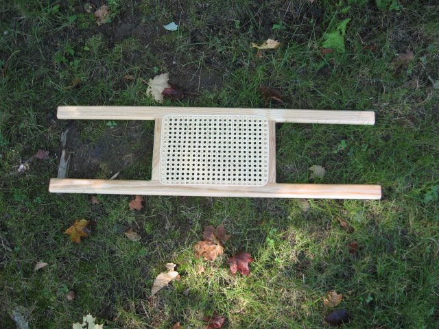

  13. I am still at the task of completing my canoe. I have primed the canoe one time and it is now awaiting sanding. I am deliberating one more primer coat. Then I am on to painting. I have come to the conclusion that I want to install a canoe seat. I had planned to kneel on the floor and paddle from that position. I intend to paddle with a canoe paddle rather than a kayak paddle. After considering the comfort of sitting on a canoe seat vs. kneeling on my banged up legs with one sprained ankle and another banged up knee, I decided it will be much nicer sit on a seat. I would like to install a seat like this. .... My photo here is to large... It is simply a photo of a cane seat in a moccasin canoe... It will be in the center of the boat. There will only be one seat. I think I read somewhere that these seats can be purchased for installation. Actually, I just found a place when I googled caned canoe seats. Can anyone point to guidance or plans regarding installation? I have looked at the photos that came with the Moccasin. That is where the photo above came from. There is a plan page in the Moccasin plans for a seat, however, I have not quite figured how to read it. If these seats are sold, I thought I might just buy one and install it. What I am trying to understand is the installation. It appears in the photo that the seats hang from the inwale. Is that right? Would that not just tear out when I sit 191 pounds down on the seat? Thanks for any help and guidance. This photo did not work either.[attachment=1]
