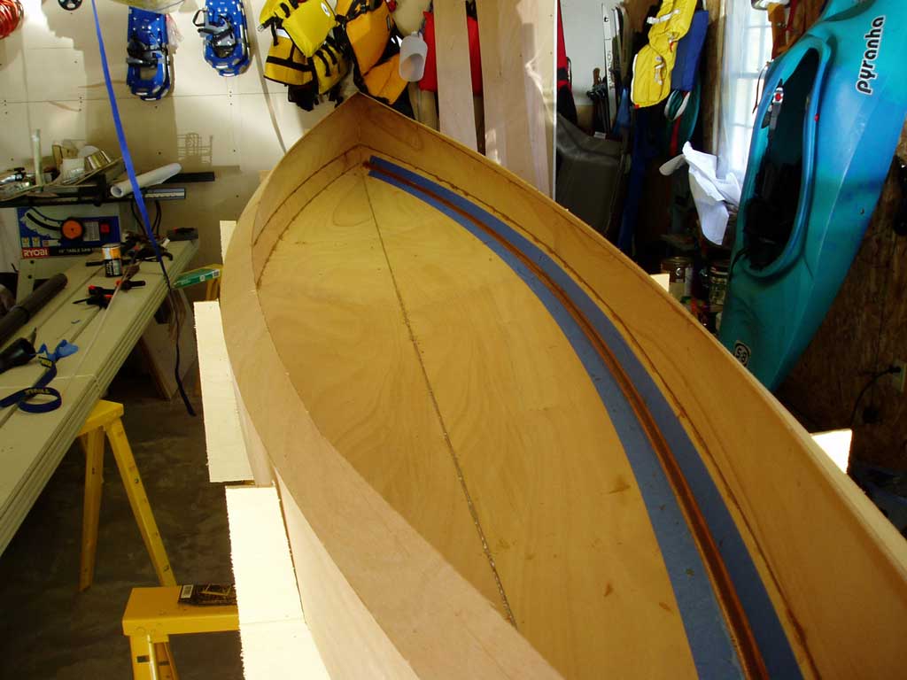

  14. Welcome! When I built my S&G canoe I did mask the seams before applying the thickened epoxy fillets.(see photo) It saved a lot of cleanup. Other labor saving: It's tempting go do something else -- like sleep -- after a big epoxy application, but you can miss the period when it's "green"(not completely cured) and easy to clean up with a knife or scraper. It's good to take notes on how long it takes for your epoxy to cure at different temperatures. If you're comfortable with scrapers and sharpening cabinet scrapers, you're ahead of the game. Scraping epoxy is usually easier than sanding it. I did make some test joints with scrap plywood before I started the boat. It was a good confidence builder, especially when I saw how strong the joints were. This is a good reference -- they're pushing their own products, but there's lots of good general information: http://systemthree.com/members/literature/The_Epoxy_Book.pdf Another interesting source: http://www.epoxyworks.com/
