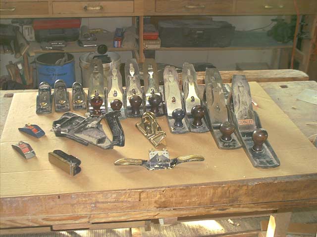

I have a few planes- LOVE using them- wonderful tools
I got excited over the scarf joint in my keel batten in another thread - there's pictures somewhere of my freehand tapers.  Or, I should say, of my plane's tapers.  I just skidded the thing back and forth while the tool did the precision part of the work.  ;D

I have to admit I prefer using a hand plane too. I have quite a few and find it easier to control the cut. I just tapered some booms and used a #4 Bailey. A power plane would have been faster, but they can remove so much wood, so quickly, you can easily cut more then you want.
