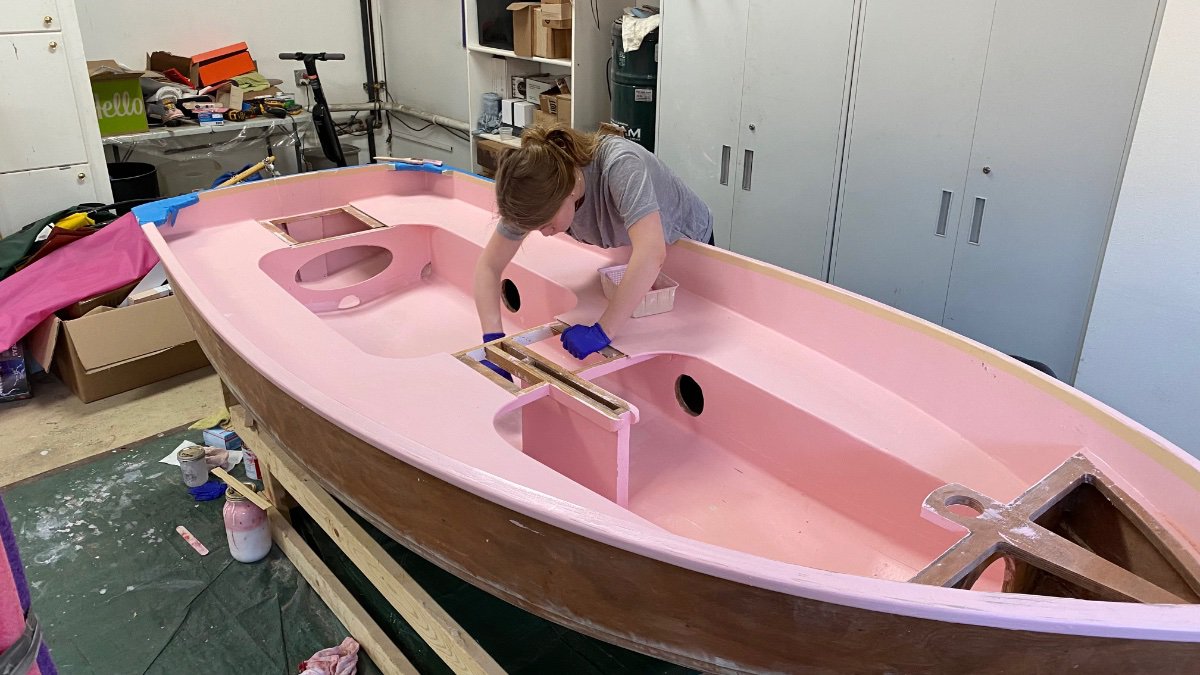

Three coats of primer, sanding and surface-wiping make things ready for topcoat paint.
She intends that the eventual white on the gunwales will come down an inch inside, so things are taped off.
She decided that what I’ve used, Interlux Brightsides, will be what she’ll use to finish her Spindrift.  Pink isn’t available, but using my Goldenbook training as a kid (The Color Kittens) we’re gonna make our own.
Hee hee hee… eye of newt… ear of bat… blood of Brightsides…
Starting coat one.  For the second coat she might darken it a tad, plus add some thinner to the mixture.  Oh, and all I’m doing these days is talking. SHE is doing the doing.

I didn’t even check in with The Weezer yesterday. When I did so last night she was at Lowes getting some supplies.  I stopped in this morning with my small can of anti-slip compound for the sole and she had already finished the third coat on the seats and sides.  She added a bit more red to make the paint a tad darker.
(Mixing the compound into some pink paint to add coats to the sole.)
Notice how I’m not doing anything?
With on-line school this week (and possibly next) we’ll likely flip the hull soon so she can complete the painting. Maybe she’ll install the middle pieces (she left them bright finished) before flipping.
The Weezer has painted the inside to her satisfaction but the paint needs more time to harden.  As I write it’s -1 degrees and heading down for the night. There is some heat in the garage so we’ll see how things are in the morning.  We cut some boards for the building form that can be used to support the boat when we flip it, hopefully tomorrow morning.
Just for fun, she placed the missing seat, trunk, and deck pieces to see what it will look like.  I think it is looking great. (Gunwales will be white, not taped blue .)
