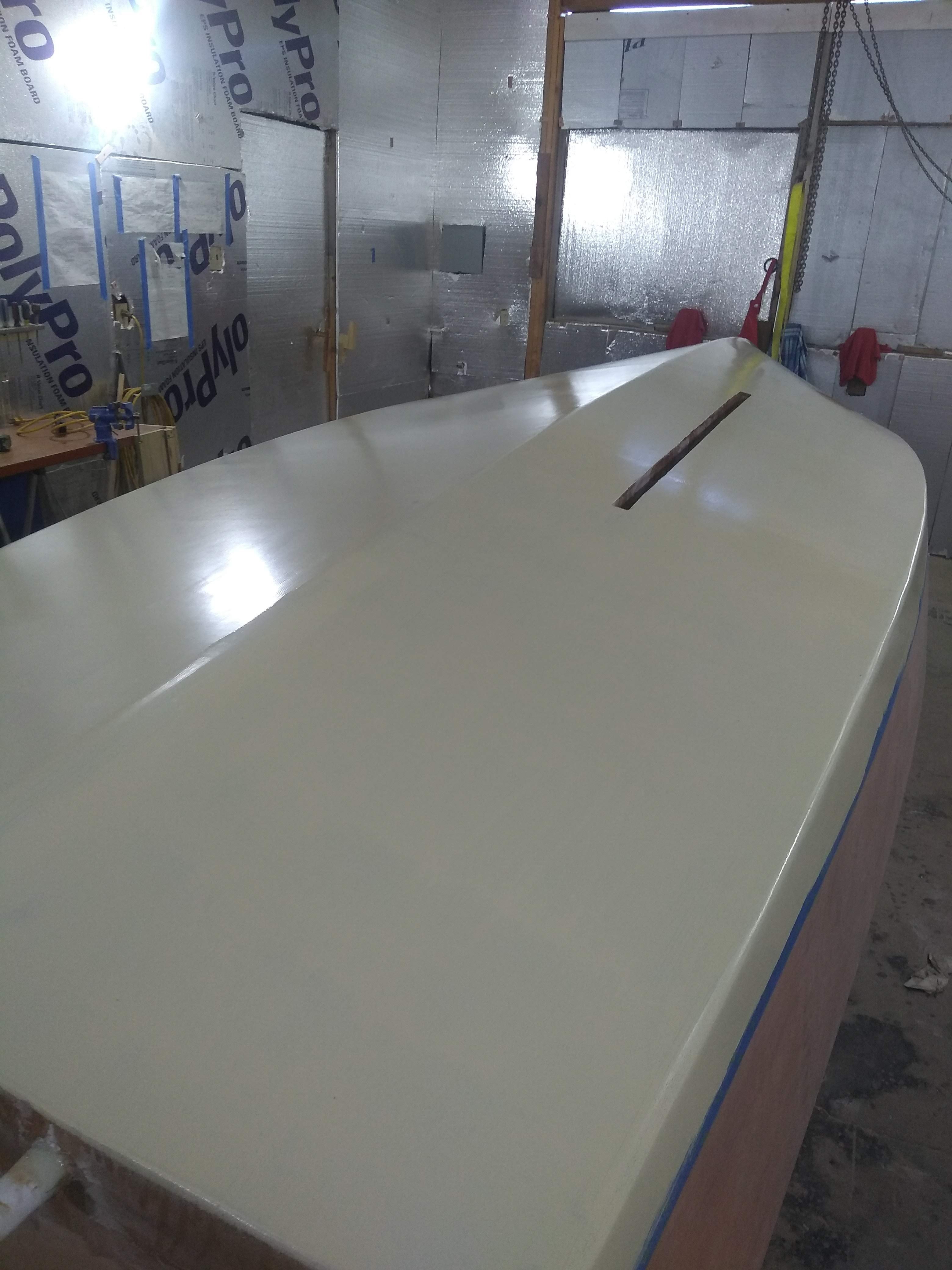

This build started the first week in May, (with a month off in between for medical emergencies), and after what seems a lifetime of build time, sprinkled with countless errors, re-dos, gotchas, head scratching, and epoxy ladened clothes to crunchy to wear, we have reached a point where the boat is upside down and the first coat of paint applied.  Gazing rapture-like at the freshly painted hull it is pleasing to note there are no gapping wounds in the bottom, other than the center-board slot.  I am gob-smacked that the bottom looks smooth and fair under the paint with only a small area at the bow with pinholes that needs to be revisited.
Alan told me this was a pretty hard build for a novice boat builder. That seems to be true. Everything in the build was or is new to me, framing, taping, fillets, cutting, butting, glassing, peel-ply and now painting.  It is at the end of each stage a certain degree of comfort is realized only to start over learning a new skill.  This will not be a perfect boat like many in this group have built, Yet I am pleased with my stutter step effort of three steps forward one back.  Alan also pointed out. “It’s wood, epoxy and glass, nothing that can’t be fixed.” I have done my share of fixing and re-fixing since May.
This boat, my boat, will be ready for the next Everglades Challenge and challenges beyond.  My eye has always been toward performance and learning how to sail a cat-ketch rig and as I sit and admire the bottom, My eye is cast toward mast building and rigging not too far away.
When asking what boat finishes to use, Alan said definitely, poly paints.  My first ever digression from a B&B suggestion has recently occurred for three reasons.  The lack of color selection in poly paints has always chaffed, therefore I am using Kirby paint products with infinite color selection.  Further, time is of the essence.  And I reason enamel will go on quick and easy with, hopefully, a lower learning curve then poly.
No doubt this decision will bring some comments.  With luck some comments will circle around how to apply enamel correctly.  My first painting effort has left brush marks and lapping marks on the bottom. It feels like the paint went on too thick.  I want the paint on the bottom smooth for optimal performance.  I am unsure how to accomplish this.

We're all newbies in the beginning, and continue to learn all the way through our first build. And second. And third. And---well, you get the idea. Pretty soon some other new guy will be following your posts for advice. Keep 'em coming. Also remember that for every 10 builders, there are 11 ways to accomplish a task. And we're all opinionated!
These photos can be frustrating sometimes! Tell us what is happening---or not happening and someone will have an answer to the problem.
Don't feel too bad that you are using enamel paint.  Two-part paint has amazing hardness and durability, but it is expensive and challenging to apply.  You end up having to waste whatever is unused (or even worse, stop in the middle of painting to mix up more), and it isn't really fun to wear a respirator.  My paint jobs contains every blemish in the book.  So feel good about your decision.

I think I sorted out the photo issue.  These pics are of the bottom with one coat of paint.  Unfortunately in my hurry to learn paint, I forgot to put on the keel rubrail which we had prepped and ready in another barn bay.  So we sanded down the paint to fiberglass laid the prepped wood rail and put the metal skid rail on the wood and used a few holes in the metal to guide us where to fasten down the wood to hull without having to fill holes in wood after the glue and fillets dried.

enjoying your thread.  I avoided the two part paint as well in favor of a traditional oil enamel from Marshals Cove and appear to have gotten away with it.  Just couldn't accept the limited colors available in the two part paints. Only advice I can offer is that the systems three water based silver tip primer worked well as a base for my enamel.  Dries quickly, no stink, and the Marshals Cove enamel liked to stick to it.   A lot to be said for using water based primer and saving the stinky stuff for the top coat.
Randy, thank you for your comment and sharing.  I had intended to use a primer also. I asked George Kirby and he asked back, what epoxy system I used.  When I told him I did not know but got it from B&B he said. "Put the paint on the boat.", meaning without primer.  I have, it works, I'm happy.  As an aside.  Even without experience I marveled at the apparent quality of the paint  in the first few strokes.  It was even more obvious the quality of the finish product  was solely in the hands of the operator.
