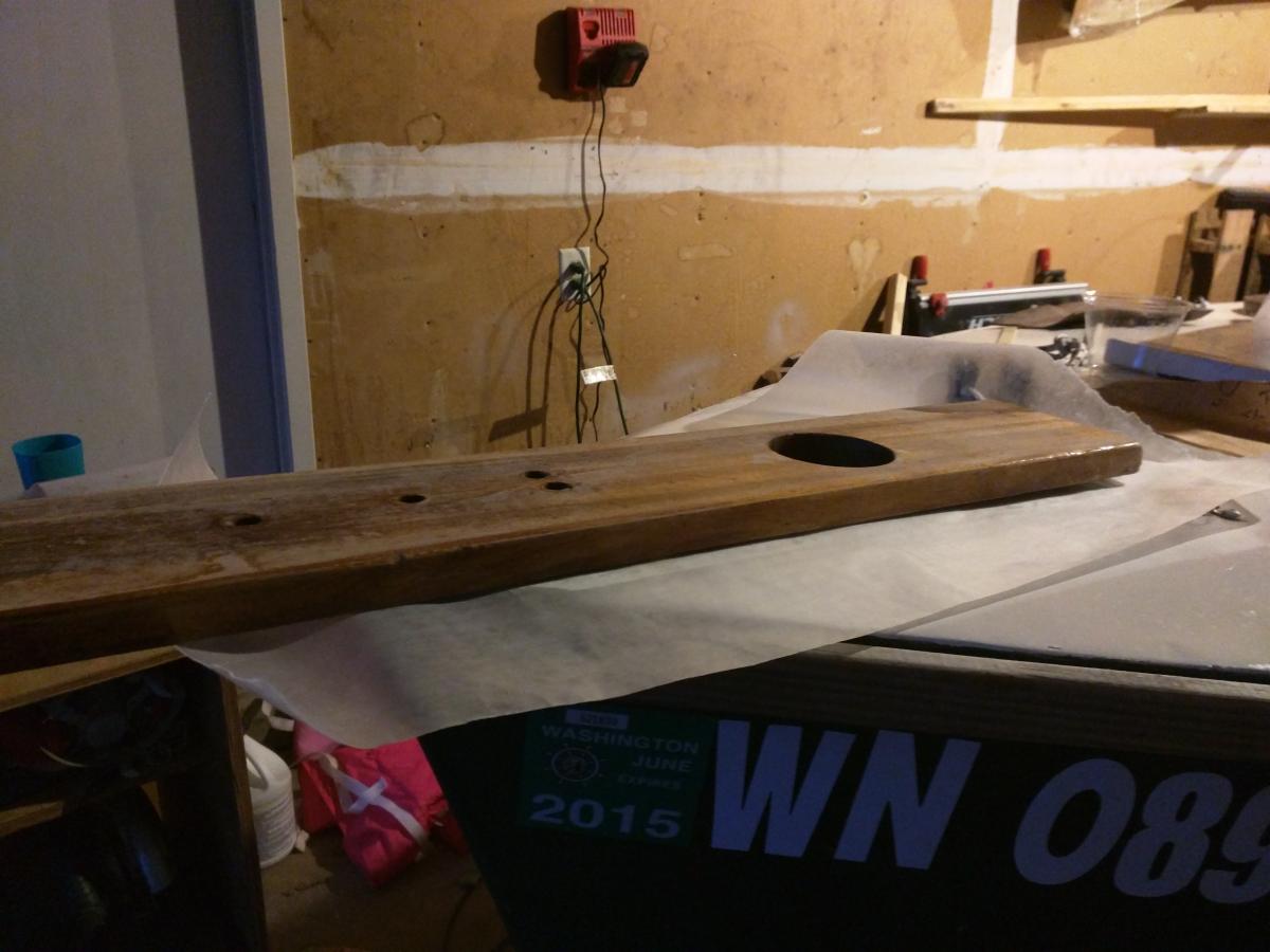

Alright guys, My main oarlocks are 62.5 inches to center apart. For the forward ones, will it hurt them if they are 63.5" will this make switching rowing stations awkward? I need a little extra room for lines that run aft. See photo
