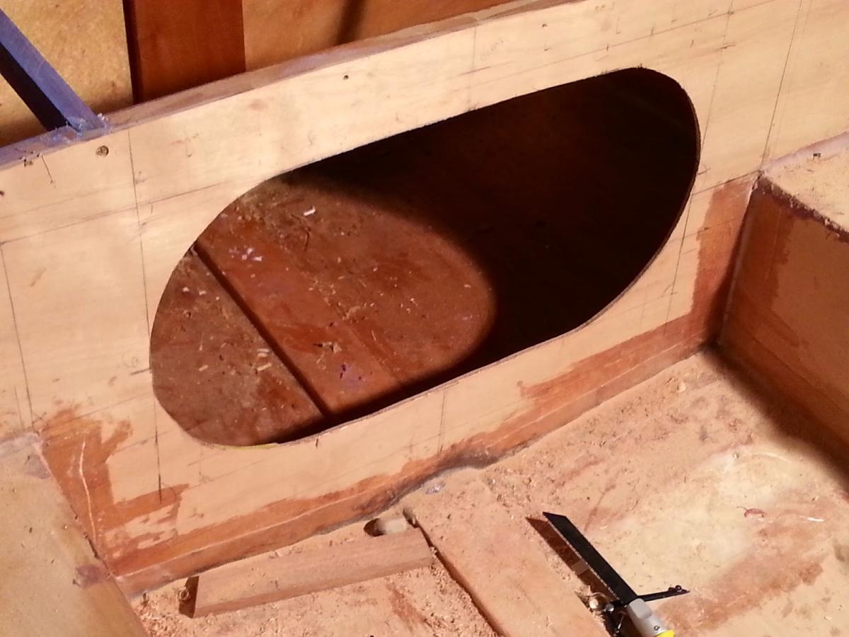

LennieG Posted January 8, 2015 Posted January 8, 2015 That is a great idea and I had not thought of that as far as not having the hatch cover in your way......I wonder if the piano hinge could go on top but that may mess with trim I am planning to have up there.....hmmmm..... What is your plan for the take apart hinge. I wonder if a flush board going across bottom catching bottom of door would suffice? The kit has about a two inch recess around the hole I am sure you know.... That is a great idea and I had not thought of that as far as not having the hatch cover in your way......I wonder if the piano hinge could go on top but that may mess with trim I am planning to have up there.....hmmmm..... What is your plan for the take apart hinge. I wonder if a flush board going across bottom catching bottom of door would suffice? The kit has about a two inch recess around the hole I am sure you know.... Quote

Dnjost Posted January 8, 2015 Author Posted January 8, 2015 That is precisely how I currently plan to do this. Thanks for the photos. I admit I had not considered a flush board accomplishing the same thing! Might change my mind once the boat shop warms up. The hatch itself (not pictured) has an inner layer of 3/8 added to it to stiffen it some as the 1/4" by itself seemed a tad flimsy. Since the inner ring around the hole is recessed, the lower lip method might work great. Report to follow... I know what you mean about parts accumulating during a long duration build. I have several bow and stern eyes (industrial strength). I know not why. Quote

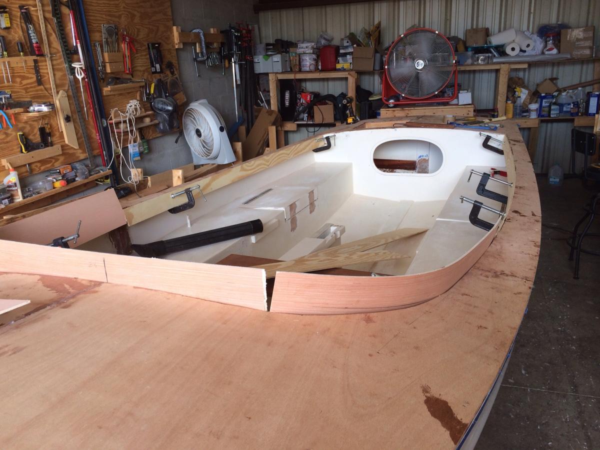

Blkskmr Posted July 27, 2015 Posted July 27, 2015 I have question in reference to the U shaped base for the seat hatches for the CS17 mkiii. I have assembled the sides in the U according to the photos and posts. However, the two ends of the U protrude out bout 1/4". There are photos which show the front face of the hatch ring completely flush, ends of the U included. This make sense to me for installation. However there are a couple of photos which seem to show the ends of the U protruding. Which is correct? Please let me know. Regards Richard Quote
Blkskmr Posted July 27, 2015 Posted July 27, 2015 Ok well figured out the problem but too late. Operator error. It is very important to note, and not easy to see in the photos, but the 90 degree angle of the big end of the side pieces is up. The 90 degree angle of the big end does not get glued to the U base. I hope that makes some sense. And if you have them upside down, the ends of the U base will extend out about a 1/4". The really sad part is I looked all the photos and blogs and thought I had the orientation correct. Please avoid the mistake. I had to cut the parts apart.. It will still work...just ugly, really ugly. Rgds R Johnson Quote
