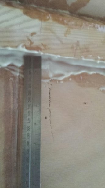

I have a 4" fracture that goes perpendicular to the stem that happened during gluing the bottom on the port side on my OB 20. It is below the waterline and is roughly 4' aft of the bow it is on one side of the scarf joints I did on the the bottom . It did go completely through but I did epoxy the outside of crack to fill.  This does not have glass yet (inner or outer). Will this be ok or I am looking for trouble to continue to glass both faces ?

The chain of events is that my dad an I scarfed and glued up 2 each 20' long panels. We templated the boat  and shaped the starboard side and glued down no problem . We then shaped the port side and started working fore then aft and saw we were over stressing the panel. We already had the fore 4' clamped up and had a pretty good area all epoxied epoxied aft (panel and stringers) and moved forward  right or wrong.  It is a 4" crack running perpendicular from the stem  that goes through the thickness .  I have filled the exterior of the crack during fairing process and haven't touched the interior. The crack has not spread but is this a weak point that will be an issue later on?
Brace, wedge and curse it back into position, then grind out the back side a touch with very rough grit (40 or less). Next wet out with goo and apply a few layers of biax. The biax will replace the broken the wood veneers in the plywood, so consider this when deciding how much biax to employ. These things happen, just move on and no one except you will know.

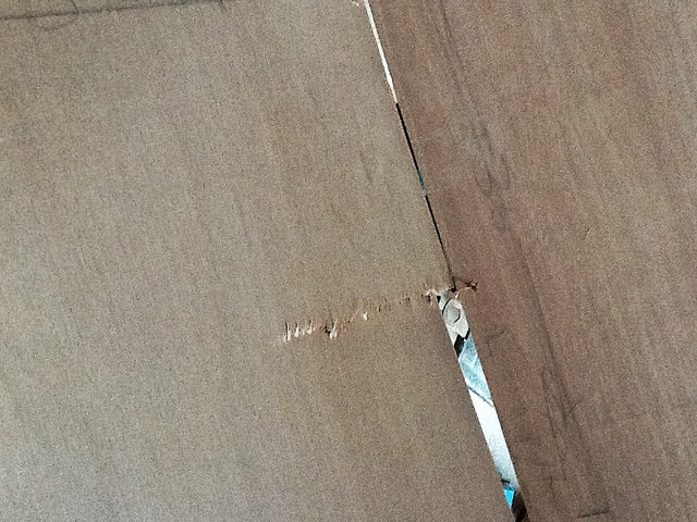

I had a crack in my CS 17 at about the same spot.  But, on the CS, it is where the bulkhead, CB case come together and therefore many layers of goo and glass are supporting it.  Photo attached.  I had forgotten about it until I sorted out my photos today.
