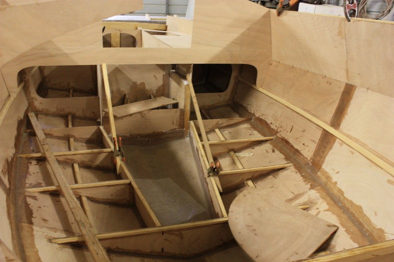

post-396-0-95527900-1390916176_thumb.jpgpost-396-0-12359800-1390916212_thumb.jpgpost-396-0-51618500-1390916255_thumb.jpg
A few more recent pictures.  About to close the cockpit sole (flotation and water ballast) and bow flotation.  Lately I have been installing stringers and cleats and doing unseen taping and filleting.
