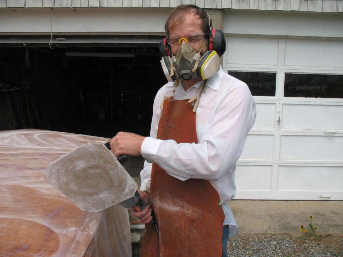

That's right. Sander/polisher so you can dial the speed down so as not to melt the epoxy and a home made platen that takes full sandpaper sheet. The platen is made out of 18oz glass. Description & pictures are on my tread way back when I started sanding ( page 2). PeterP
Atta boy Joe and that leather apron is a REALLY SMART piece gear for people NOT needing an appendectomy. Looking forward to seeing all at the meet.PeterP
