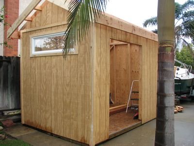

I have most of the rafters on, just missing the south end gable rafters (doubled ones).  I didn't take a picture because I worked so slow on Sunday ... it was 85 degrees here.  I'm hoping to get a lot done this weekend ... its a three day weekend for me with my new schedule at work.
I do have a question ... even with the rafters, I can "rack" the structure pretty easily.  There are two rafter ties that still need to go on, but its a little disconcerting.  I'm planning on using 5/8" T-111 exterior siding.  Will that stiffen it up as much as I'm thinking it should?
I think the siding will stiffen it up nicely Frank.    I have also used diagonals across the studs as added stiffeners here in hurricane country, but honestly, after 5/8 siding is added I would find that redundant.  It might help keep everything square before the siding though.

The "T-111" should stiffen the structure quite well, however; you might want to line the inside with lauan paneling. It will keep the studs from twisting, it will hold insulation if you are so inclined and it'd cheeper than anything else except cardboard.
If you are going to hang a heavy exterior door, I might suggest connecting your jamb studs to the next stud on each side of the door opening.
Roger
Thanks for the info on the siding and stiffening.  I do have double doors, so the opening for the doors is pretty wide.  I may tie the studs nearest the two studs on each side that opening together on the inside.
I was actually thinking of using 1/2" flakeboard (OSB) for the interior walls rather than drywall.  Its almost as cheap as drywall and would add extra stiffness.
I should get the roof sheathing on this weekend; I only have the one gable end to frame and then the fascia to do prior to putting it on.  I may get to the T-111 also (if I'm lucky, but everything takes about twice as long as I think it will take).

You have my respect, Greg!  There's no way I would work in inclement weather anymore, especially on a roof!  But you raise an interesting point; should the siding go on before the roof?
If you do stick framing it is normal to put on the roof first to supply shelter for the construction underneath, but sheds get most of the strength from the paneling.  I would build the sides first, the frame the roof, then panel the roof, then the shingles.
By the time we put on the roof panels the weather was improved.  We only went as far as framing the roof while it was snowing.  Then we tarped the whole shebang, waited a week, removed the tarp, paneled the roof, re-tarped, then got professional roofers to put on the shingles when the weather got unexpectantly warmer and dryer.  We got really lucky with that and had the shingles on before the real winter hit us.
That makes sense.  I'll finish the roof framing, install the window and then do the siding.  I'm thinking it will be easier to make sure its square by nailing temporary braces on the inside and then putting on the T-111.

I sheath walls before I even lift them off the floor.  This assures they are square and stable even before connecting them at the corners.  You may want to run a string along the top of each bearing wall (the ones the rafters will sit on) and brace to to absolutely true (parallel to this string) before adding rafters.  Don't remove the braces until the collar ties and roof sheathing are done.  This way your walls don't bow under the roof loads.
