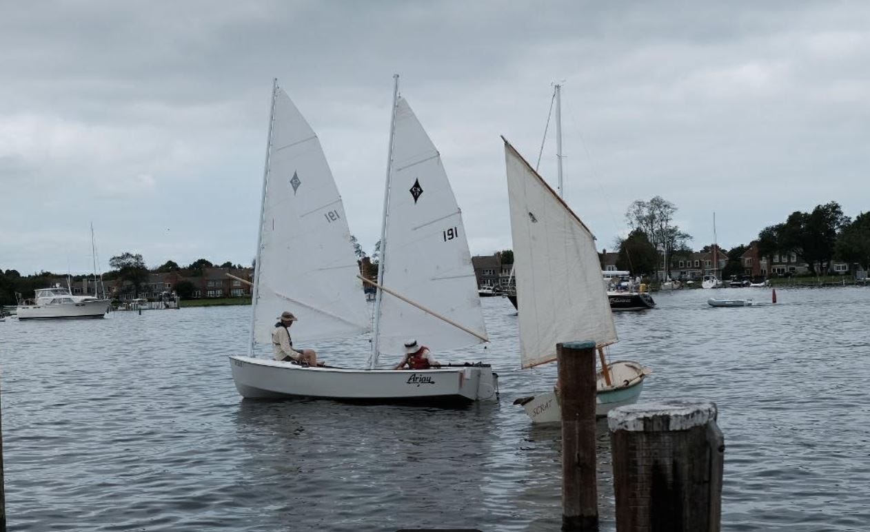

First we have a new three man Core Sound 17 team (Team Sail Futures) Joe McClung aka Seminole98, Kevin Farrell aka Longshoreman and Mike Long aka Longshoreman are sailing Core Sound 17. I believe they are all new Tribers and we are looking forward to meeting them. They are sailing CS-17 #191 ‘Arjay’ which was launched in 2018 by Brian Forsyth who built her from a B&B kit. Photo below of ‘Arjay’ finishing first at the MASCF event in St. Michaels, MD in 2018 about 30 seconds ahead of the next boat.

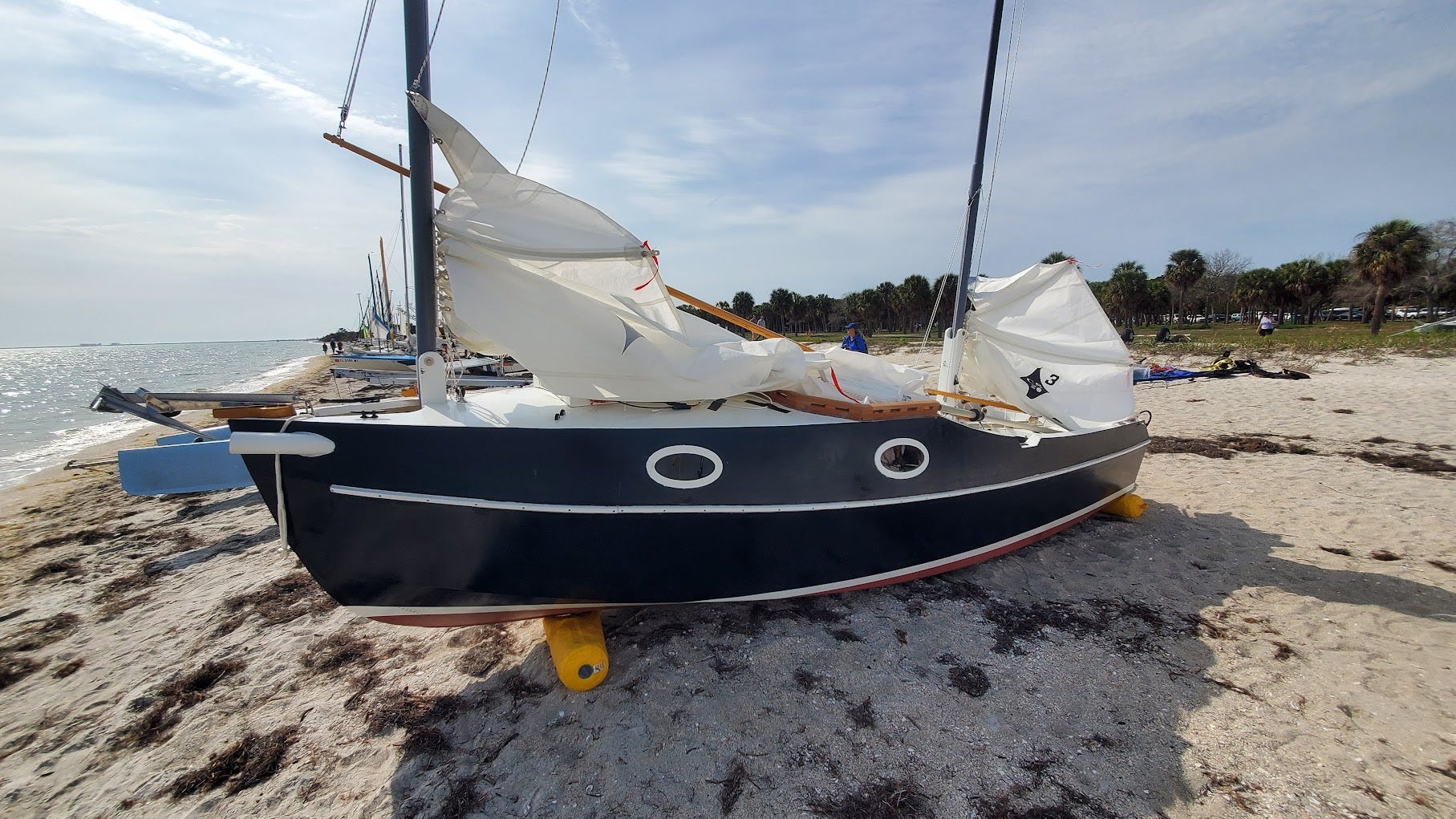

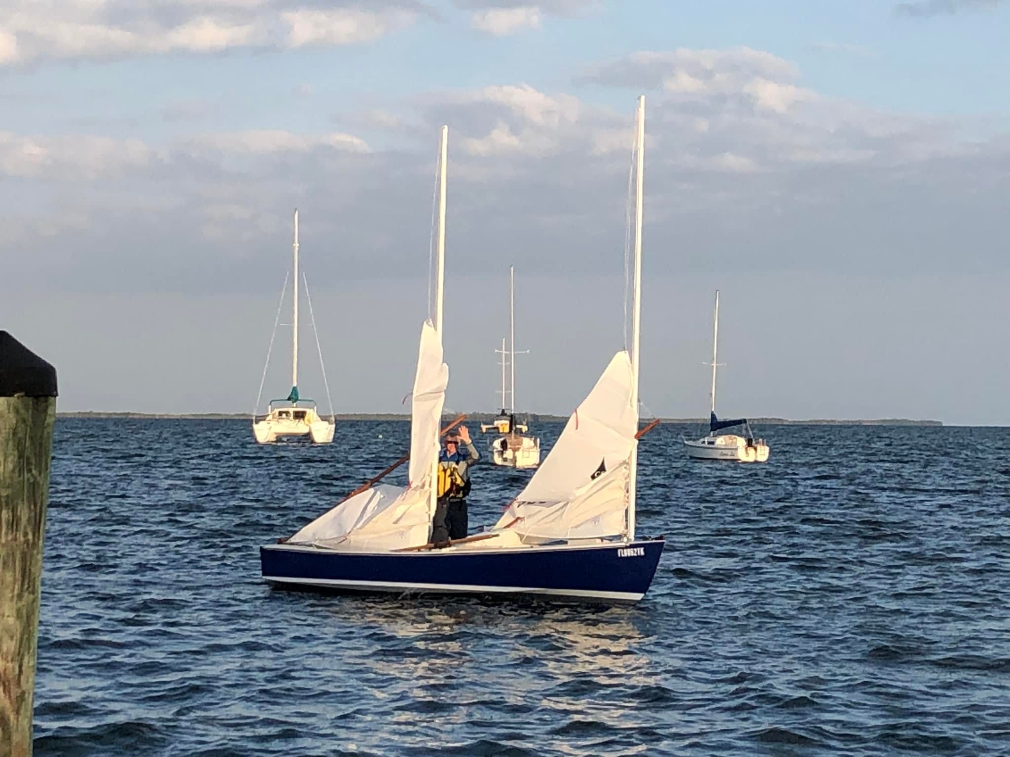

At is gain this year is also the three man team of Erik Dykema aka NowWeTryItMyWay, George Blaha aka CountryRoads and Ivan Bartha aka Yellowdog. This is their second year in this Dark blue Core Sound 20 Mark 3. Last year they finished in 4 days 13hrs and 46min putting them in fifth place in class 4 and one of only nine class 4 boats to finish out of twenty two who started.

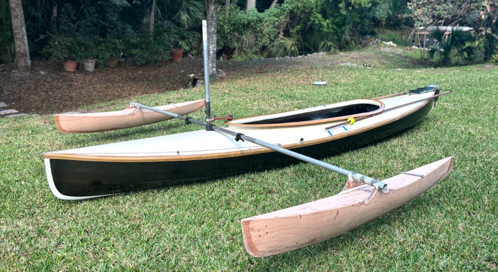

We also have an honorary member of team B&B this year Mark Cecil aka Misterc is sailing a Meade Gougeon decked Sailing canoe outfitted with some newly designed B&B sailing canoe amas that he will be using on his BSD rig. Mark has three EC finishes under his belt in Class 1 and Class 3. I am looking forward to seeing how these amas perform and may be upgrading my UFC canoe with a set as well.

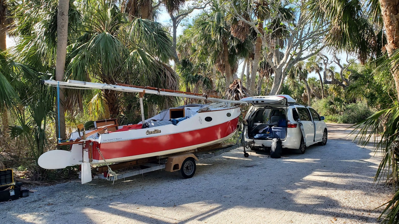

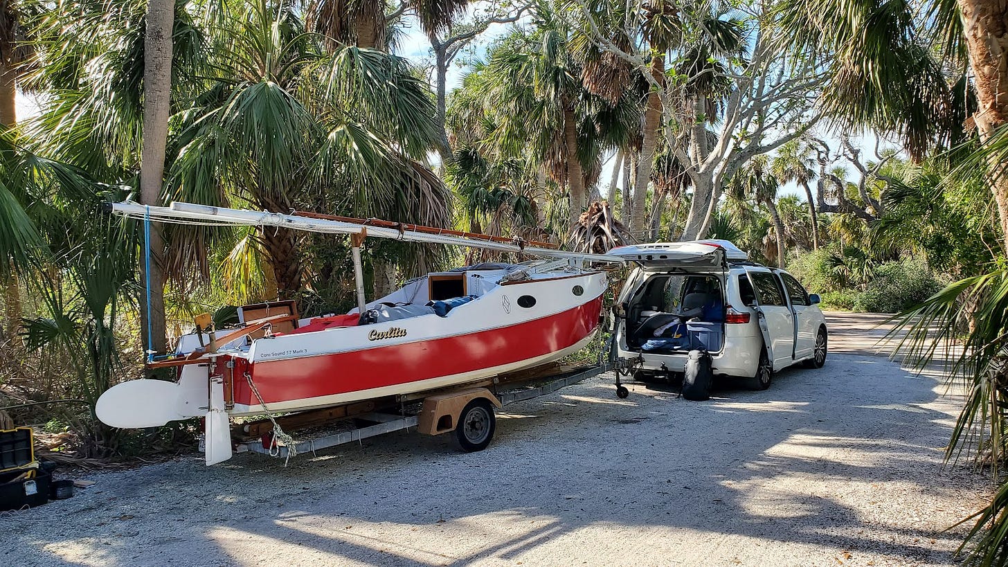

Carlita resting in the campground

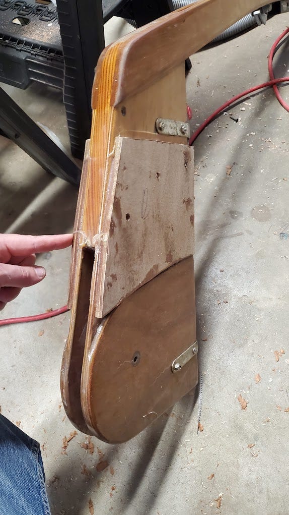

Carlita is ready to go and this year she has a new rudder. At last years Messabout she suffered some rudder cheek damage when Graham’s home made keel rollers on the trailer worked TOO WELL and she slid off the trailer way too fast. The rudder blade (with rudder up) slammed to the stop when it hit the water and twisted the rudder cheeks cracking them. We slapped some ply to the outside to get her back underway for Graham’s Neuse River Trip. You can see below the repaired rudder cheeks which while ugly were much stronger than original (thickness = stiffness). But for the EC we’ve rebuilding Carlita’s Rudder cheeks and rudder blade as the original was starting to get tired after a decade of sailing. Pictures of the rebuild are here.
https%3A%2F%2Fsubstack-post-media.s3.ama
For an more in depth look at the Core Sound 17 Mark 3 rudder check out this 4-5 min segment of our complete 17mk3 Tour video. In it I discuss my preferred downhaul setup which is critical for shallow water sailing.
On Rudder Failure:
This is only the second time I've seen a B&B rudder have a failure in the 17 years I’ve been working with Graham and sailing B&B boats and I still have yet to see one fail from actual sailing or grounding. The first was on Erik's 20mk3 rudder blade which technically failed while sailing but it was later determined that the blade was damaged earlier when an Amazon truck backed into it. And this recent failure which you could argue could be replicate in rough seas but Carlita has seen quite a bit of those without incident. Nevertheless we did decide to increase the cheeks to 9mm ply for the rebuild.
Rudder failure is one of the primary failure modes of small boats in the EC. Whenever I see a fancy new rudder design on the beach I think about all the rudders I’ve seen fail over the years. Broken pins, sheared blades, cracked castings, bent plates and on and on. Graham’s design has been brutally tested and passed over and over again.
