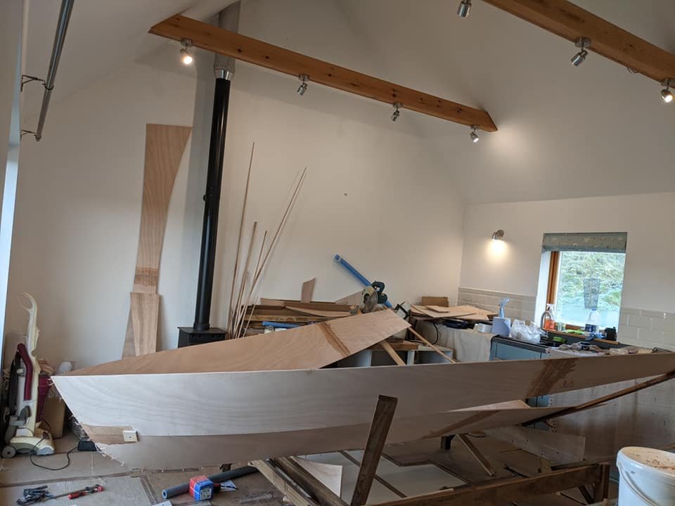

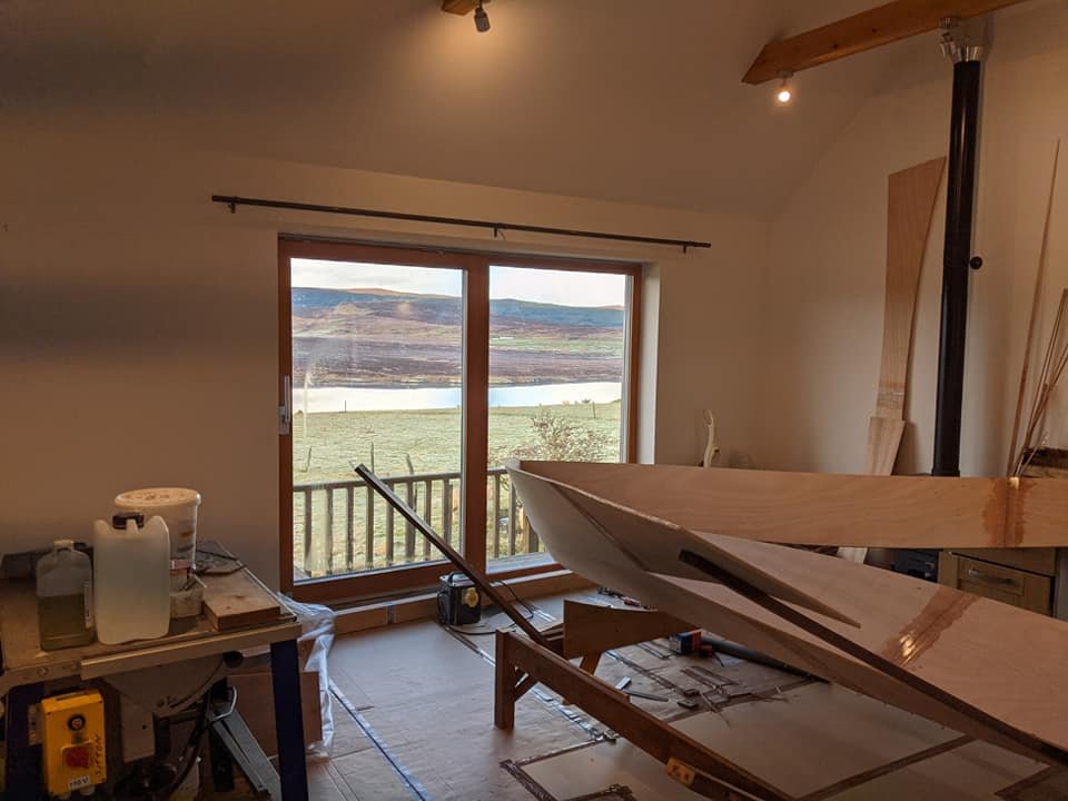

Progress so far: all major panels cut out, transom and bulkhead assembled, the two sets of floor/side panels are joined at the bow and ready for stitching. Cradle set up (I had an old bed to get rid of so modified that as a frame).
I'm surprised how much time it took to epoxy together the transom and nesting bulkhead. Maybe I should have enlisted SWMBO to mix the batches of epoxy and stir in the silica. I've ordered some better (larger!) epoxy tools which should speed things up a little.
I'll upload a few photos when I get a chance. Hoping to do the grand opening tomorrow.
As promised, progress so far.
I was pretty nervous when it came to the opening up. But I needn't have worried, the joints all held.
My first taped butt joints weren't brilliant. I've put the better side to the outside, where possible, as I think that will see more stress. I can also hide an ugly joint more easily on the inside. My epoxy work has got steadily better with each little job.
I've been doing this mostly on my own, although my 4yo son likes to help out where he can. I gave him the job of poking the wires through the pairs of holes which he took to with great enthusiasm. I had to go round and pull out all the ones that were in random old screw holes of course :)
The old bed frame has been great. Unlike trestles, I can move the entire thing around without having to get it aligned afterwards. And with the extra width, I was able to tack on various battens to help me with the unfolding. You'll see in one photo that I have a sort of goalpost arrangement at the forward end; this lets me put a little downward pressure on the sheer line to gently persuade the boat to open up. It's just held by one screw each side so can swing fore and aft, and by pulling it forward I can press down to lower the sheer. It made fitting the forward bulkhead pretty easy.
