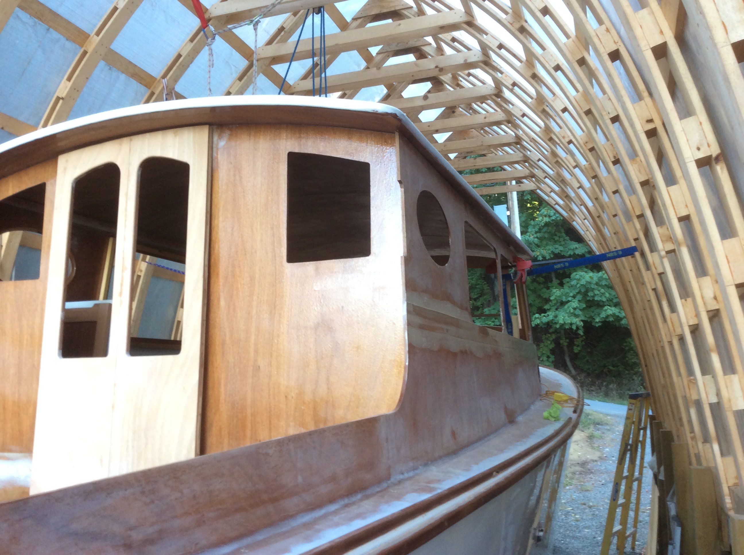

Hi Guys- Rosie is on her trailer, out of the shop and in the bow shed.  Had some great help jacking her up and getting the trailer under her.  It only took 20 seconds. These boys work fast. Check out the video.
https://photos.app.goo.gl/Ha9E6yF8phx85QM66
The pilot house had to come off to get her out the door. I have the pilot house sides, windshield permanently secured now with the roof ready to be fastened in place.  I made the windshield frame from Australian Lace. Wood.  A tip of the hat to the Aussie designer plus I had a some boards I have been saving for something special.
Hope to be painting the cabin sides very soon (buff).
I am playing with the steering station ergonomics and should have that ready soon. Only 8,642 details fo go.
Ken
Ken
