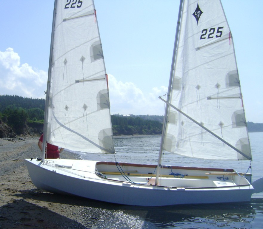

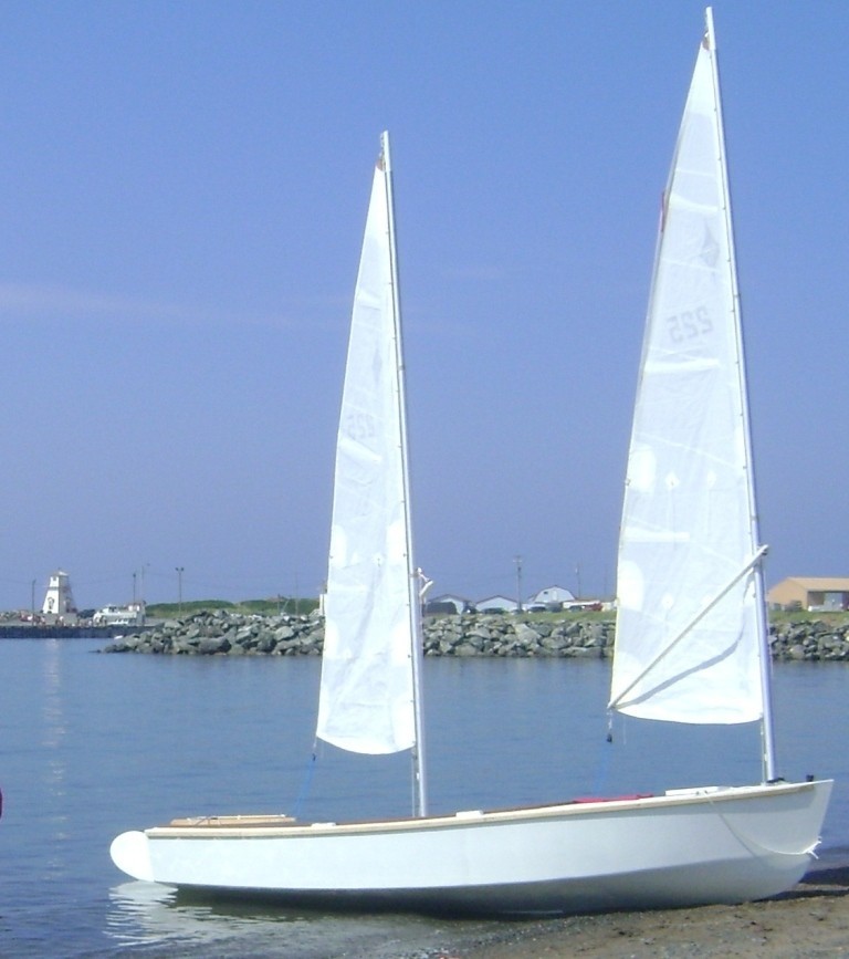

  3. Hello all, Just a note to say Hi and introduce myself. I began CS17-225 on April 15 of this year and launched on July 15. Of course, many small details are yet to be finished, but we have been sailing for a month and I am pleased with results so far ... very easy to sail. The sails (track type) were purchased from Carla/Graham are working well. The set of the main is quite good, and I am still playing with the mizz. Top section of masts are 2"-0.065 with wooden plug-top of about 12-18". The hull is BS1088 with mostly Doug-fir framing, 9oz tape on all seams and 6oz over all outer hull. I'm looking forward to installing some of the many mods and improvements you've described. A couple of shots are attached from the first trials in July, I will try to find a couple more of us under way.
