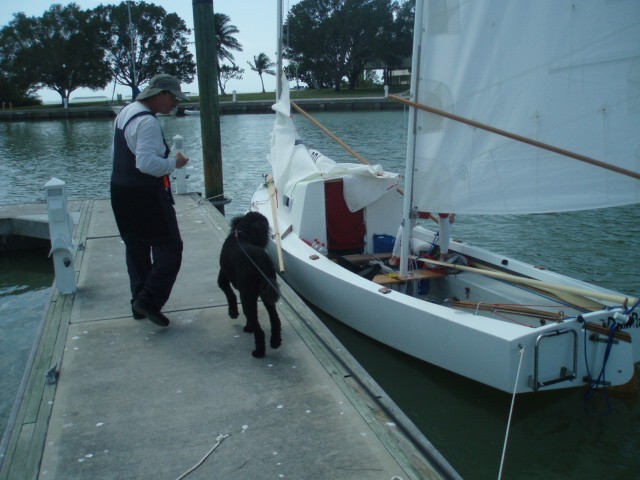

  15. I can only manage to post one pic per post.
  16. This camera is impossible to see in daylight so aiming is just a guess. I steped on the camera when I was in Flamingo, so maybe I'll have a new one next year.
  17. Saturday morning just after the start.
