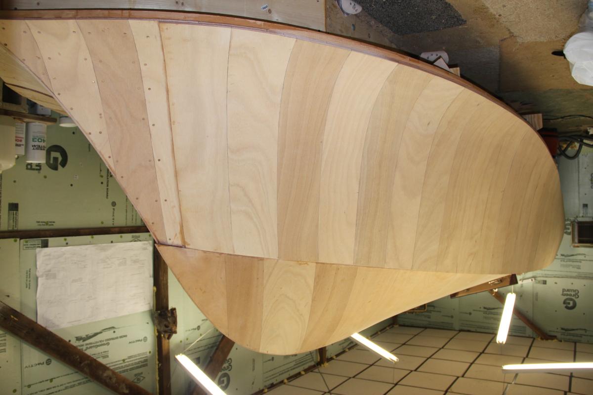

Sanding. Lots of fun. Starting to think about turning her over. I'm making a plan. She fills the barn. Couple of finished planking pics coming soon.

Yes, the side planking is just glued to the end grain of the chine. I considered a stringer here as well, but went with the design. This joint will get 3 layers of glass on the outside. Tape and two overlaps of the bottom and side glass. Also the inside at this joint will get a good fillet of resin and cabosil and a layer of glass as well. This design eliminates the big chine batten, which would take a lot of work planing. Then an external spray rail would have to be added. I'm not going to add a spray rail as I think the reverse chine looks better than an external rail. Some add the spray rail even with the built in chine. I'm not. I've seen some other big builders use this type of design design as well. I think this saves a lot of building time and looks better as well.

As you can see in the photo I am truly concerned about the epoxyclips. In retrospect, its just the end of planking, not the end of the world. So I'm feeling better. I sure am glad planking is at an end. The staples have worked really well through the entire planking process. Even the extreme flare in the bow was done with the staples. I feel they were superior to using screws, at least with this thickness of planks and amount of flare in this boat. I am looking forward to doing anything other than planking, even sanding. Just glad she is planked.
My bottom is two layers. The first layer goes on and is beveled (say port side). Then the other side of the bottom (starboard side) is fit and glued and it is beveled. Then the second layer of planking goes on, first port side glued and beveled then starboard, glued and beveled. Each layer has to be alternated for maximum strength along the joint. Which is actually a little scarf joint. Just fit your plank and draw a line along the apex of the keel onto the plank. Cut close to the line but leave the line and just cut it square. Now after gluing this plank in position you are just planing off to the bevel on the keel or the underlying plank.
