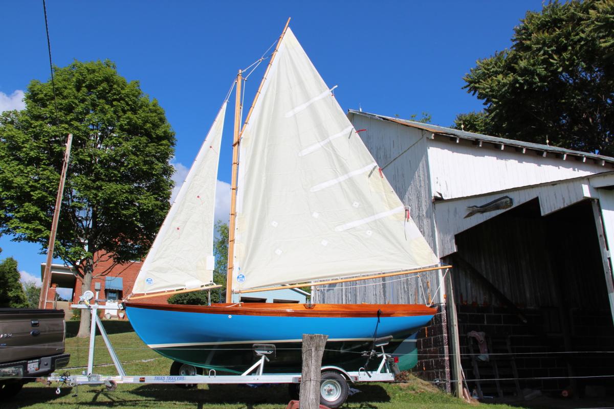

  13. Oyster,I no longer own Miyot, but she still sails out of Wachapreague Va. Thanks for the reply.
