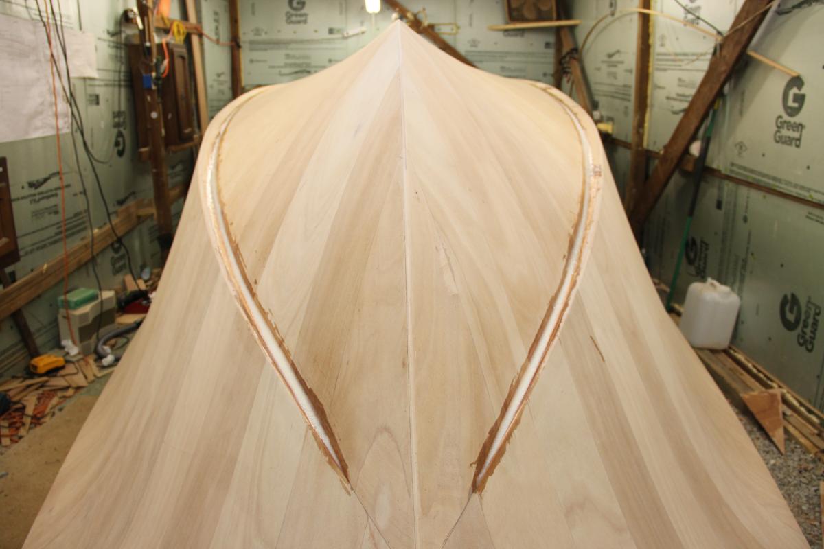

  25. Finished planking pics. Sanded 6 hrs today and pulled the chine fillets.
